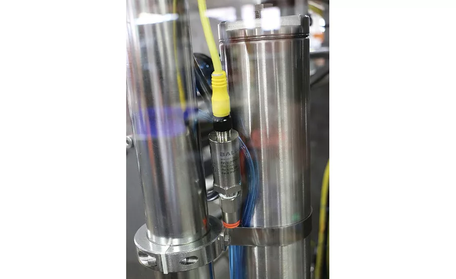

There are four ways to add IIoT capability to legacy equipment, according to Healy. The first is the installation of simple sensors, which perform a basic function like verifying a part is present or a certain shape or color, or turning something on or off.

One level up from simple sensors are smart sensors. These sensors take input from the physical environment, use built-in computing resources to perform predefined functions upon detection of specific input, and then process data before passing it on to a controller or an actuator network. Healy specifically prefers IO-Link smart sensors because they are usually easier to integrate with older machines and can be set up to obtain the most important and actionable data.
Last year, a Tier 1 suppler installed Balluff’s BTL linear position sensor to improve the accuracy of several machines that verify a nut is welded to a larger part. Healy says the plant engineer scheduled a full day to perform the sensor installation, but only needed 20 minutes to complete the whole task. He even redid it, thinking he must have missed a step or two since it was finished so quickly.
“Each sensor takes one measurement when the automatic welding gun goes up, and another when it goes down,” explains Healy. “It also verifies the nut is there before each weld. Now, all machine sensors are interconnected, and the manager can verify they are working fine on a simple mobile device. Before, he may have had to walk 20 minutes across the plant to see which machine wasn’t properly working.”

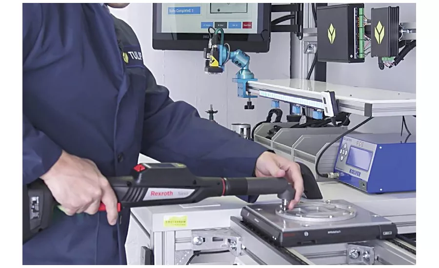

The Tulip Factory Kit helps companies achieve this goal by digitizing all of their assembly processes. Along with providing access to the company’s Manufacturing App Platform, the kit includes an I/O Gateway that lets engineers connect devices to the apps they build, a Tulip Light Kit for driving pick-to-light processes, break beam and environmental sensors, a barcode scanner, a foot pedal and a tower light.
“For the past several years, a large aerospace manufacturer has had its electronics assemblers work at stations upgraded with Factory Kit components,” notes Forzese. “Each worker performs assembly at his or her own station, which contains bins with pick-to lights, measurement sensors and temperature probes. The assembled electronics are part of the Inertial Guidance System that helps pilots monitor flight.”

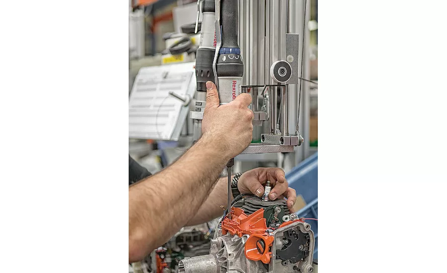

Bosch Rexroth is also helping manufacturers improve data collection and analysis for its ErgoSpin DC handheld fastening tools, and automated single- and multiple-spindle systems. Any of these products can be used in conjunction with the OGS and Rexroth’s IoT Gateway, as well as either ActiveCockpit or Product Performance Manager (PPM) software, or both types of software.
The Gateway comes in standard, advanced and performance versions, with the respective capability of monitoring 25, 500 and 2,000 data points. All models have a maximum sample rate of 10 hertz, offer standard connectivity and feature a compact, fanless control cabinet.
ActiveCockpit is a customizable data-visualization tool. It gives end-users the ability to streamline their processes and have more accurate, real-time transfer of information between shifts. The software lets users pull and compare current data to previous operations, record errors for later review and communicate with co-workers in real-time for effective decision-making and increased plant efficiency.
PPM collects real-time production and machine data and graphically presents it to a worker. The software monitors the condition of each machine, as well as the whole production system, and optimizes production efficiency and quality by reducing system failure and reworking costs. Its ticket manager function assigns maintenance tasks in electronic form. External ticketing systems are easily integrated.

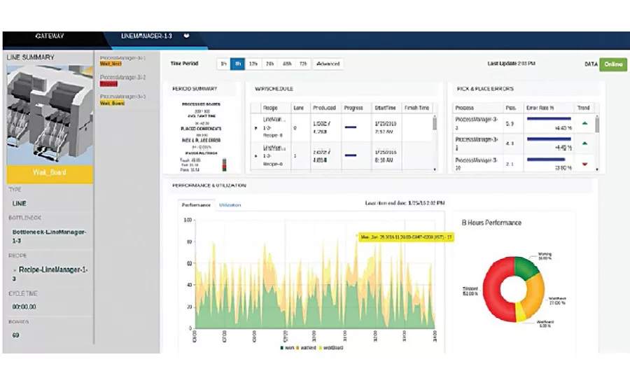

Electronics manufacturers interested in updating their PCB assembly machines can do so with the Valor IOTM Computer system from Mentor Graphics, a division of Siemens. The system includes software with built-in interfaces to work with surface-mount equipment, and inspection units that easily connect to every machine on the shop floor—regardless of machine type, vendor or protocol.
“Two types of boxes are used in the system,” notes Sagi Reuven, business development manager at Valor, a Mentor division. “The Data Acquisition Unit (DAU) connects to any machine and controls its operation based on application logic. The System Processing Unit connects to all the DAU boxes and processes for a specific assembly line. This enables application of routing rules and chain traces, as well as identification of the bottleneck machine that is causing any production delays.”
