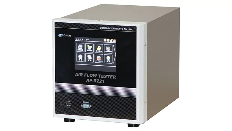

AF-R221 flow sensor
Photo courtesy of Cosmo Solutions Technology Inc.
May 10, 2024
The AF-R221 is optimal for testing discharge flow and tightness. The flow sensor can be selected between laminar flow or mass flow. It features an easy-to-navigate configuration tool and a flow optimizer. The instrument lets engineers transfer data between devices with a built-in transfer tool. The language can be selected from English, Japanese or Mandarin.
The instrument has a waveform measurement screen that allows engineers to monitor flow and test pressure in a way that is simple and visually accessible. For in-depth analysis, it comes equipped with software for X-Chart, X-List and statistics, allowing engineers to see important information directly from the device rather than moving it to a separate device.
When the test pressure fluctuates, the flow at the specified test pressure is displayed on a multipoint optimizer sampling screen.
