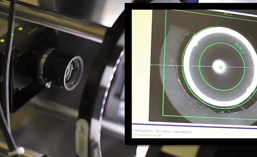

Vision systems are used to inspect the barrel opening for imperfections and to ensure the screw is not bent or damaged.

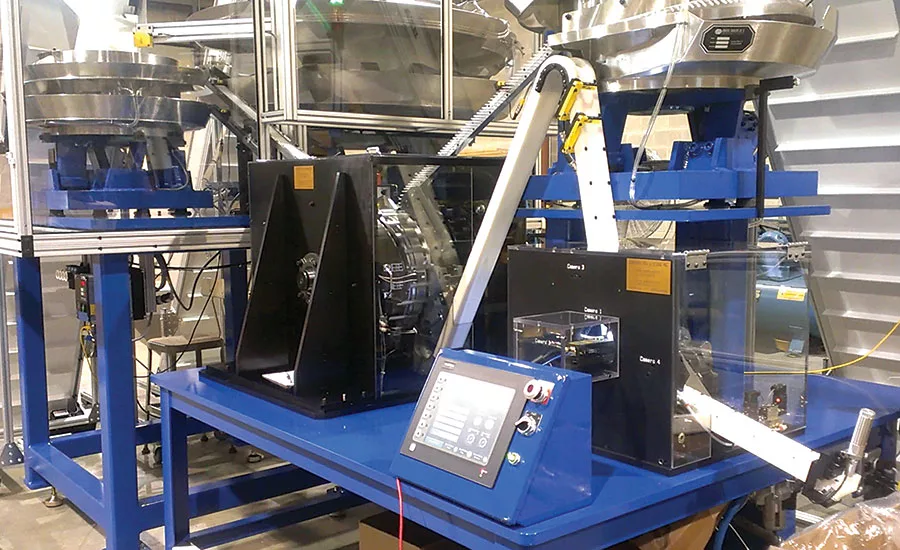

Recently, the company built a continuous-motion machine to assemble a 0.15-ounce lip balm tube at a rate of 300 assemblies per minute. The tube consists of three parts: a barrel, a screw, and a cup-shaped elevator, which pushes the product up when the screw is turned. The barrel and screw are polypropylene, while the elevator is high-density polyethylene.
Each part is loaded into its own hopper. The hoppers convey the parts upwards and drop them into vibratory feeder bowls. The bowls convey, orient and discharge the parts into tracks, which present them to the main assembly dial. There, they are fed into slides or pockets and positioned for assembly.

Good assemblies are discharged into a track that leads to a vision inspection system. The system consists of four cameras. Three cameras are positioned to inspect the barrel opening for imperfections. The cameras can find imperfections as small as 0.004 inch. The fourth camera is positioned directly in line with the opening of the barrel to ensure the screw is not bent, out of center, or damaged.

The system is equipped with an easy-to-use HMI that controls all aspects of the system and includes multiple data collection screens.
