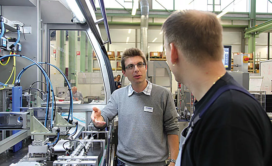

Lionel Rochat, project manager at Mikron, demonstrates the operation of the G05 assembly cell at the Sonceboz assembly plant. Photo courtesy Mikron Automation

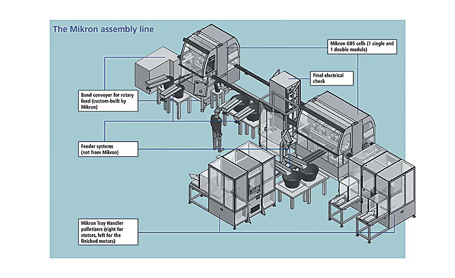

Sonceboz produces more than 70,000 stepper motors a day on this high-speed, multistation automated assembly line. Illustration courtesy Mikron Automation

After a year of intensive cooperation, the Mikron line was put into operation. It comprises two Mikron G05 cells (a single module and a double module), two Mikron tray handlers, and two feeder systems produced by another vendor.
Preassembled components (a stator with two coils) are loaded onto the assembly line from the tray handler. A custom-built conveyor transports them to the first G05 cell, where additional components are installed, including a toothed drive gear. These components are transported to the line via feeder systems.
Before the finished motors leave the assembly line via a second tray handler, a final electrical test is carried out.
