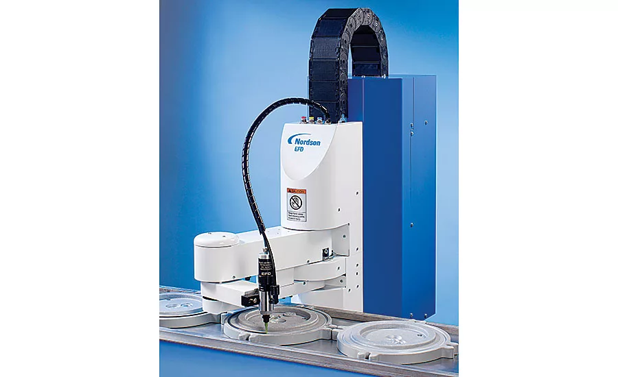

The four-axis SR4404 SCARA robot covers a 440-millimeter-square work area. Here, it is dispensing a gasket material. Photo courtesy Nordson EFD

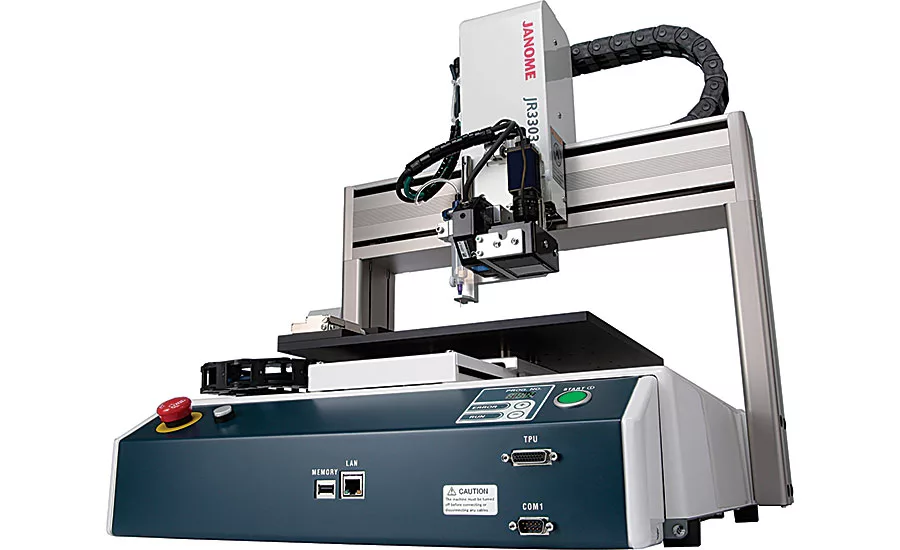

On a Cartesian robot, the mounted syringe moves in straight lines along the X, Y and Z axes. Each axis is a separate linear actuator driven by a ballscrew or belt. Photo courtesy Janome IE USA Inc.

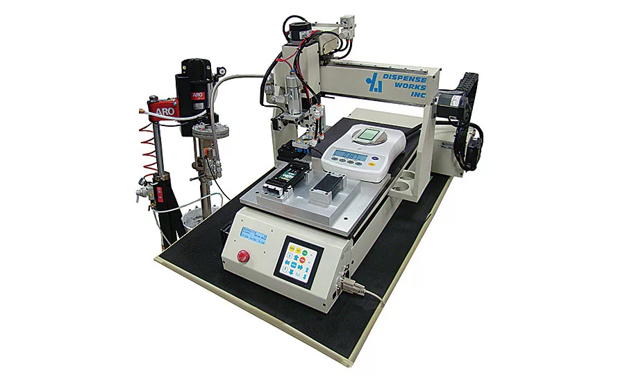

Dispense Works specializes in custom benchtop dispensing systems. Features on this model (RP1215) include a laser-displacement measurement sensor, a pick-and-place vacuum head, a 5-gallon-pail pump and an integrated digital scale. Photo courtesy Dispense Works Inc.

Lab technicians at one contract electronics manufacturer know this. For the past two years they have been using a custom benchtop dispensing system from Dispense Works Inc. to quicken assembly of a tiny glass sensor. Previously, three workers separately dispensed tiny amounts of room-temperature vulcanizing silicone from a handheld syringe onto a lead frame and placed a glass sensor (0.0625-inch square) onto the frame.
According to Emil Cindric, president of Dispense Works, the manual process was labor intensive, wasted material and resulted in inconsistent product quality. To eliminate these problems, his company developed a system featuring their benchtop Cartesian robot with specialty tooling mounted on the gantry. Besides dispensing, the tooling performs vision-guided part assembly and testing.
One part of the tooling holds a syringe that moves and dispenses the silicone on the frame. The other part uses vacuum to lift the sensor and place it on the frame. After a couple seconds, the vacuum tool lifts the assembled part and places it on a conveyor. Total cycle time is 3 seconds. Besides ensuring consistent part quality, the system saves the lab $32,000 per week.

SCARA robots have four axes of motion. The first two are radial joints in the horizontal plane that allow the arm to swivel about its base and fold in on itself like a folding screen. The third, or Z, axis produces vertical motion, while the fourth axis produces rotational motion around the Z axis.
SCARAs excel in two different applications. One is to lift and transfer the syringe horizontally a short distance and position it just above the part before dispensing material. Another is to transfer the syringe horizontally over a longer distance or an object (like a conveyor) before dispensing. SCARA robots are ideal for these applications because they never tilt the syringe.
The four-axis SR4404 SCARA robot from Nordson EFD covers a 440-millimeter-square work area, and quickly retrieves up to 255 dispensing programs and 30,000 points. Standard features include PC motion control software and a five-phase stepping motor with encoder, which ensures smooth operation. An optional teaching pendant lets the operator create a dispensing sequence without using a PC.
On a Cartesian robot, the mounted syringe moves in straight lines along the X, Y and Z axes. Each axis is a separate linear actuator driven by a ballscrew or belt. Some models rotate the syringe about the Z axis or parallel to it for a fourth axis.
Key benefits of the Cartesian robot for dispensing applications are high-speed accuracy and repeatability, and modularity. Because a Cartesian robot distributes loads evenly across a rigid frame, it accurately and repeatedly dispenses material at high speeds. The robot’s modular construction allows individual axes to be quickly repaired or replaced, and the entire system to be disassembled for use in other motion control applications.

All three Cartesian robots in Dispense Works’ RP series feature an LCD screen that displays cycle time, batch count, completion percentage and other dispensing parameters in real time. The robots have work areas ranging from 6-by-4 inches to 5-by-12 feet.
