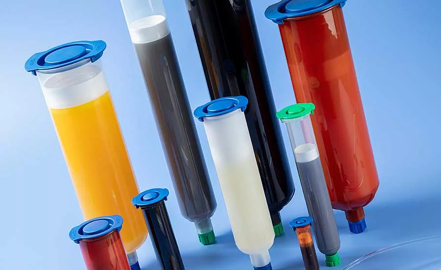

Although improving the sophistication of dispensing equipment can solve the problem of shot-to-shot repeatability, so can following some simple guidelines, such as ensuring there is no air in the fluid. Air bubbles are one of the top culprits in ruining deposit consistency.
There are many ways to prevent air entrapment from ruining deposit consistency, including:

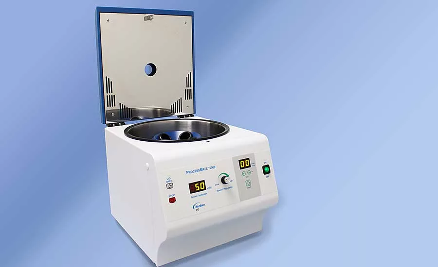

  • Using a centrifuge to purge air from fluid in a syringe barrel prior to dispensing.
  • Using the high-quality components designed to purge air as dispensing takes place.
  • Following the guidelines for thawing frozen assembly fluids to prevent freeze-thaw voids in fluid.

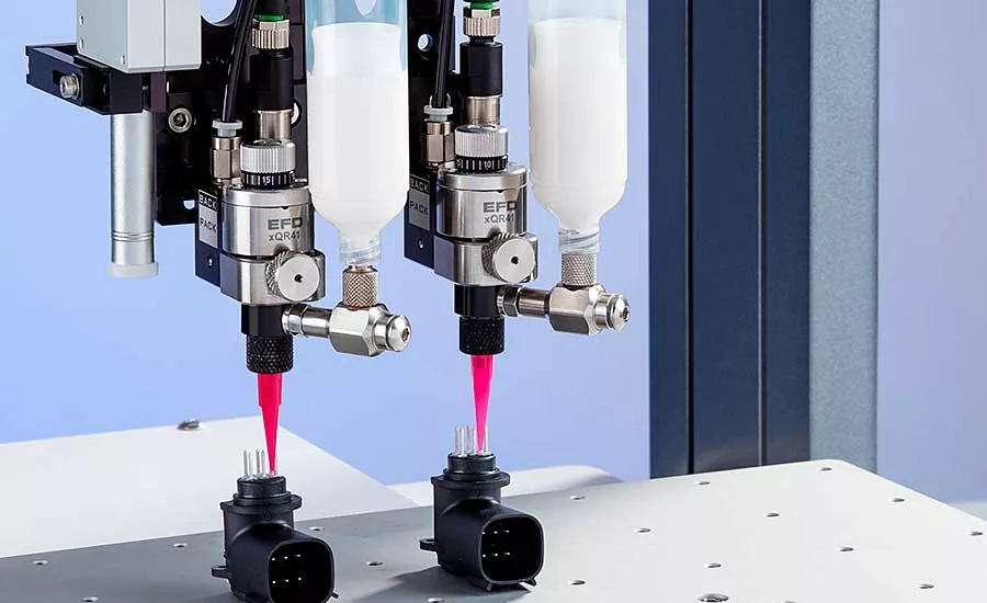

Dispensing accuracy becomes less of a challenge when using pneumatic valve systems, such as diaphragm and needle dispense valves. Precision increases as manufacturers use advanced jetting systems, such as electropneumatic jet valves and piezoelectric jet valves. These latest advances eliminate the barrier between speed and accuracy when dispensing assembly fluids.

Entrapped air in fluids can also impact shot-to-shot accuracy. Purging any air from the fluid prior to use is the key to consistent, accurate dispensing.

Recent advances in dispensing technology, including pneumatic valves and piezoelectric jet valves, reduce maintenance time through innovative product design. Quick release clasps integrated into valve design allow operators to quickly remove the fluid body while keeping the valve mounted to automated systems. Not having to remove the valve to clean it and return it to service saves a great deal of maintenance time. In fact, if a manufacturer had more than one fluid body prepped ahead of time, the switch could be seamless, minimizing downtime for service to only a few minutes.
