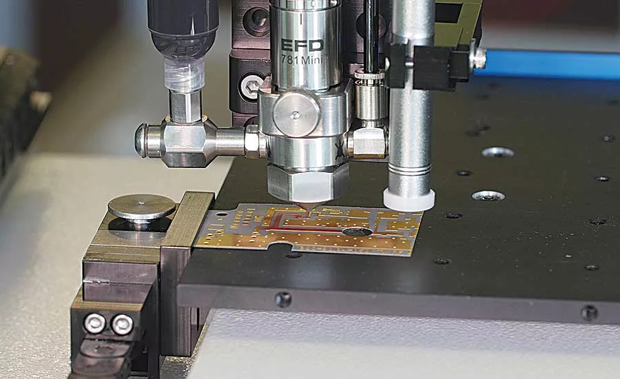

This robot is dispensing grease on an aerospace pinion gear. PHOTO COURTESY NORDSON EFD

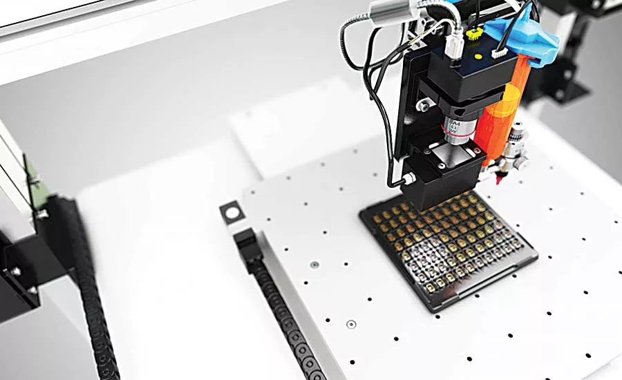

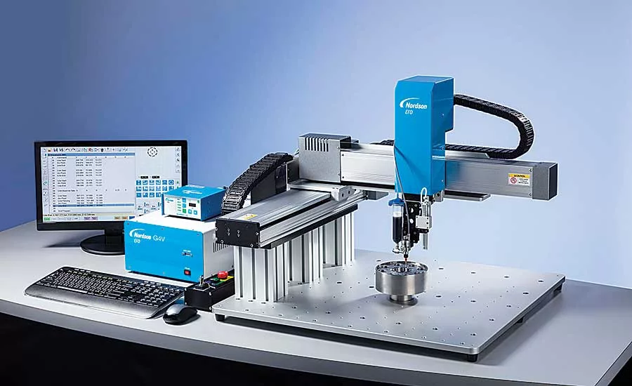

Robotic fluid dispensing maintains consistent fluid deposition with accuracy and repeatability. PHOTO COURTESY NORDSON EFD

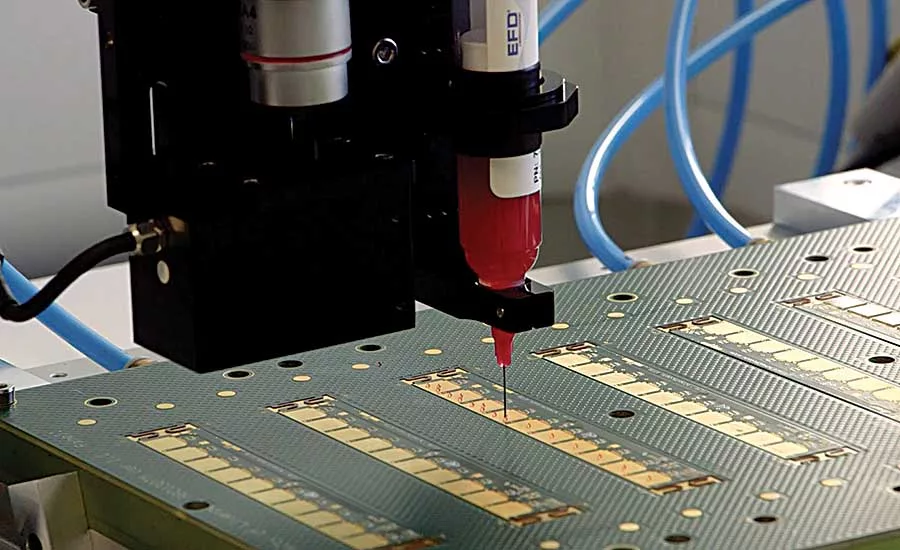

CCD smart cameras, with shadow enhancement, capture high-definition images without interrupting fluid dispensing. PHOTO COURTESY NORDSON EFD

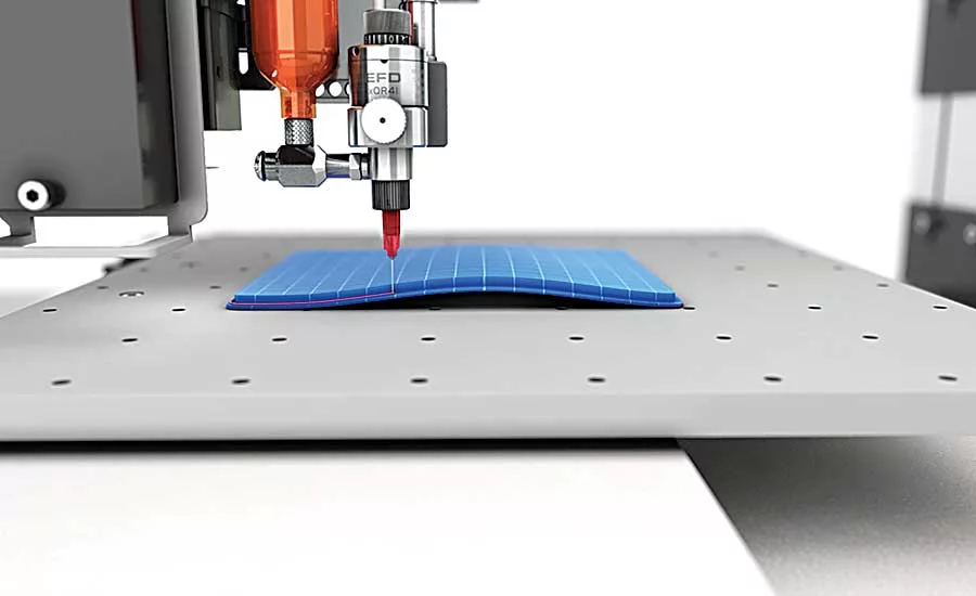

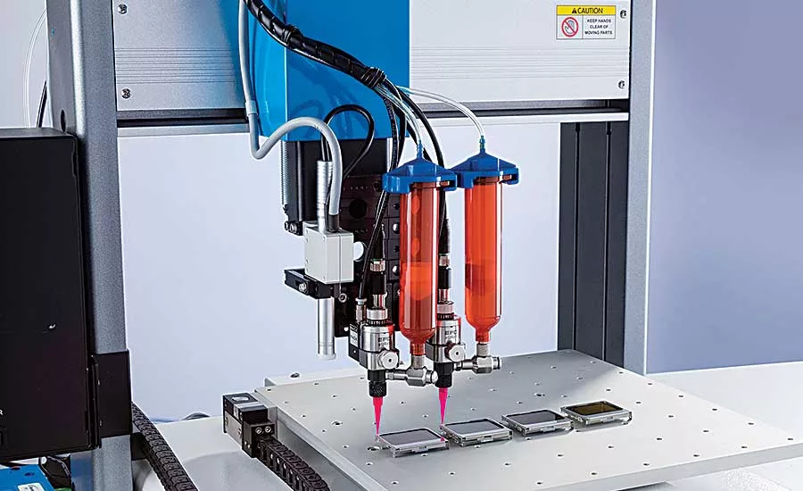

Laser height-sensing permits precision fluid dispensing on uneven surfaces. PHOTO COURTESY NORDSON EFD
The Role of Vision in Robotic Dispensing
This dispensing robot is equipped with a CCD smart camera and laser height-sensing. PHOTO COURTESY NORDSON EFD

The height of the needle over the substrate is a key parameter in automated dispensing. The goal is to dispense the material at exactly the right point where the surface tension between the adhesive and the substrate overcomes the surface tension between the adhesive and the needle. PHOTO COURTESY NORDSON EFD

Pencil cameras and CCD cameras both convert analog camera image pixels into digital values for precise image management. Some relatively inexpensive pencil camera systems, combined with specialized dispensing software, such as those offered on Nordson EFD’s EV Series three-axis dispensing robot, allow even first-time users to program complex dispense patterns and arrays with a repeatability of up to ±8 microns.

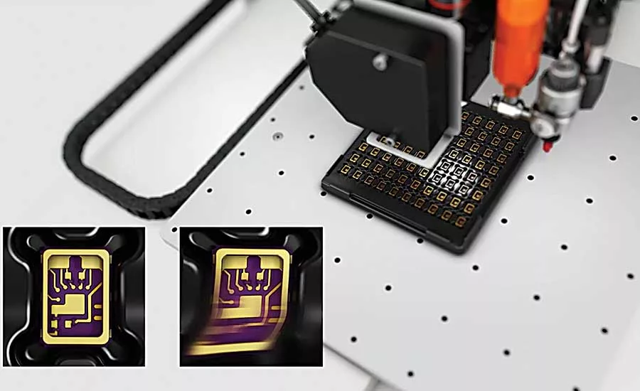

CCD cameras capture even higher-definition images. Nordson EFD’s PRO Series three-axis dispensing robot is equipped with a CCD camera that can capture detailed images of parts. Shadow enhancement allows the system to discern even faint marks with minimal time interruptions to the dispensing cycle. The camera rapidly captures high-contrast images—eliminating blurriness and small distortions produced by cameras with rolling shutter systems. When paired with a closed-loop motion control system, the camera enables the robot to achieve positional repeatability of ±3 microns.
In addition to a vision system, the PRO Series robot is equipped with a height sensor that detects variations on the surface of a product. The system automatically adjusts the height of the dispensing tip, preventing uneven deposits and damage to the tip or the workpiece.
The height of the needle over the substrate is a key parameter in automated dispensing. The goal is to dispense the material at exactly the right point where the surface tension between the adhesive and the substrate overcomes the surface tension between the adhesive and the needle. Maintaining a consistent gap between the needle and the surface throughout the process prevents stringing and ensures that the dots or beads of material will be the right volume and shape.
If physically touching the board is not feasible, laser height sensing is available for the PRO Series robot as an added option. The laser sensor maps the topography of the substrate and passes those measurements back to the robot so that it can automatically offset the Z-axis values and maintain the correct dispense gap over the substrate. The process can be done in real time for every part, ensuring high-quality dispensing even on warped substrates.

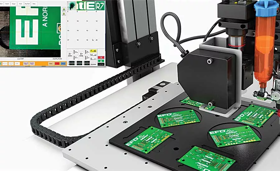

Nordson EFD’s DispenseMotion software ties the vision system to the robot. The software compares the current location of the workpiece to a reference location that is stored as an image file within the program. When the vision system detects a difference in the X and Y positions or the angle of rotation of the workpiece, the software automatically adjusts the robot’s dispensing path to correct the difference. This offsetting function is constantly receiving data from the vision system to ensure that the dispensing process is executed with precise control.
Despite the software’s advanced capabilities, its intuitive interface simplifies set up and facilitates programming with an on-screen preview of the dispensing path. The tasks of importing and converting DXF files are equally simple. Recently, a Robot Initial Setup Wizard was added to DispenseMotion, making the robots even easier to use by visually steering engineers through each step of the setup process, including calibration and setting of offsets.
