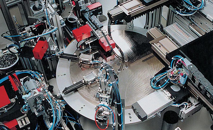

When choosing a systems integrator, engineers should consider the company’s experience, technical capabilities, financial health and even geographic location. Photo courtesy Arthur G. Russell Co.

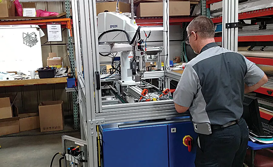

Osterholzer says engineers often overlook safety and accessibility requirements. Will the machine need a light curtain or safety mat? Will it need doors? Should the doors be hinged on the right side or the left? Will the machine need to comply with UL or CE specifications?
Error-proofing is another aspect that’s often overlooked. Engineers should specify what types of validation procedures are needed for the product. Is it enough to confirm that a part has been inserted, or do they need to know if it was inserted to a specific force and distance?

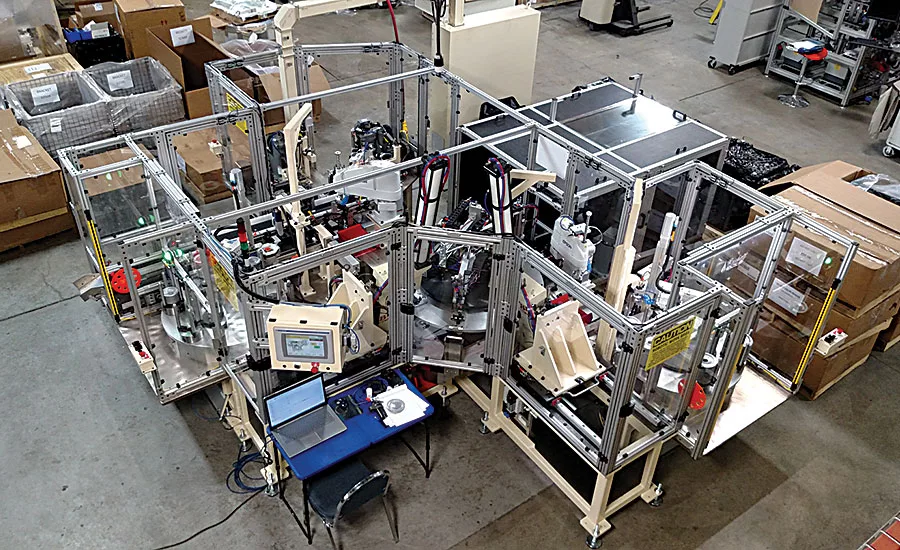

The time needed to design and build an automated assembly system varies depending on the size and sophistication of the machine. A simple project might take 12 to 14 weeks. A complex one could take 48 to 52 weeks.
“With a large project, about 25 percent of total project time will be spent on mechanical and electrical design and acquiring long-lead-time items,” says Green. “Another 25 percent will be spent actually building the machine; 25 percent will be spent debugging the machine; and 25 percent will be spent on final run off, tear down, shipping, installation and training.”
