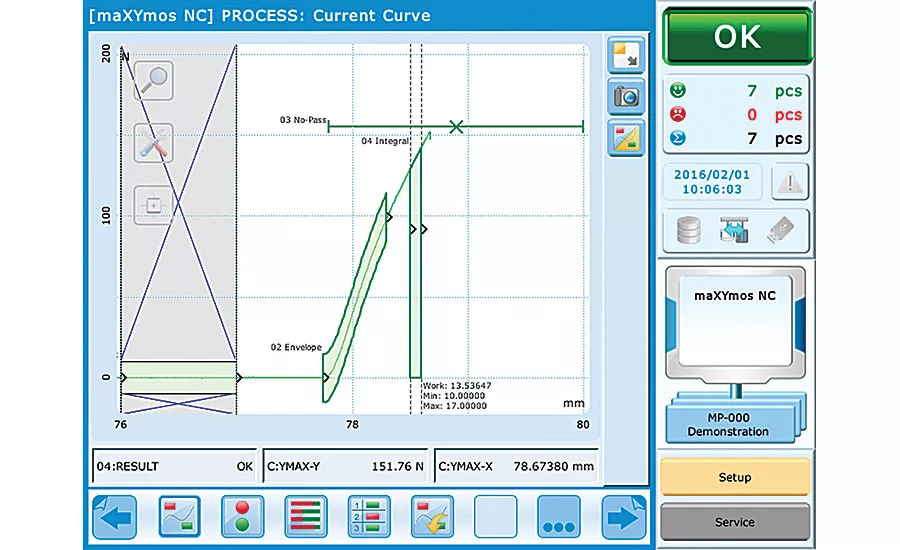

During a joining operation where an interference fit occurs, a signature force vs. displacement curve is generated.

Strategies for Analyzing Live Data
PC-based analysis system: PCs are widely available and are relatively inexpensive. However, they are susceptible to IT policies, updates and malware – which can interfere with production systems. PCs are ideal for offline data analysis.
Embedded analysis system: Embedded computing systems designed for industrial use are the types of computers that should be on the plant floor. For 24/7 uptime manufacturing operations, a deterministic embedded computer should be used for data analysis and live signal processing. An embedded system evaluating live force/displacement data can even help to identify manufacturing flaws while the parts are being formed – saving cycle time and capturing non-nominal parts further upstream.

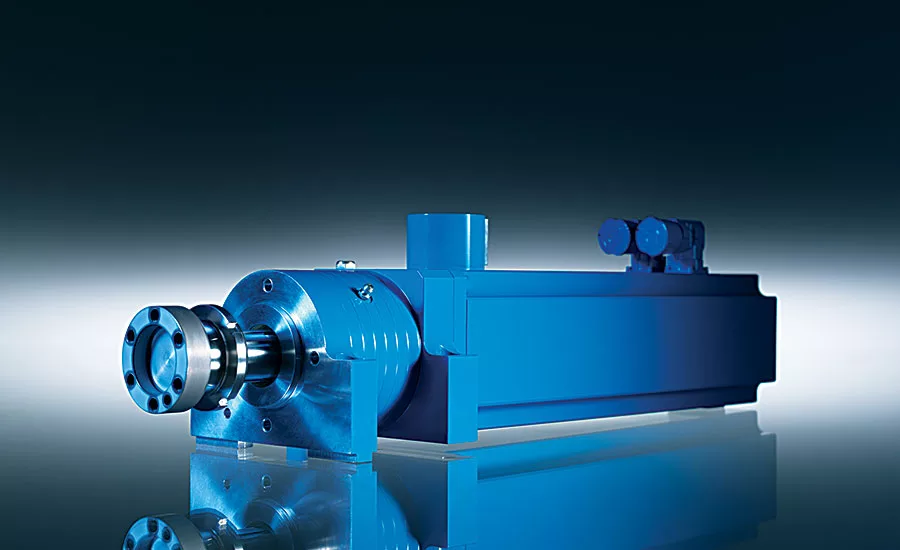

Mechanical Considerations
The mechanical modules have two main components: servo motor and a linear screw. The motor mounting configuration comes in 3 varieties where the screw is limited to two types.  There are advantages for each but some systems offer far greater benefits when compared to other types.
Integrated servo motor:  Direct-driven; provides a stiff connection with no belt wear or backlash and requires less maintenance. Very compact in size compared to an externally mounted motor of equal force.
Externally mounted coupled servo motor:  Direct-driven; provides a stiff connection with no belt wear or backlash and requires less maintenance
Externally mounted belt driven servo motor:  Drive belts provide a point of failure and position accuracy due to belt wear or backlash.  Drive belts require additional steps for maintenance crews for inspection and tightening.
Ball screw vs. planetary roller: Both are well-suited for most joining and press fit applications.  The planetary roller can handle much higher loads with the same motor size due to the load is distributed over a greater contacting surface area. This reduces heat, increases efficiency and extends longevity.
Kistler Type 2151B… NCFH Joining Module with hollow shaft motor
