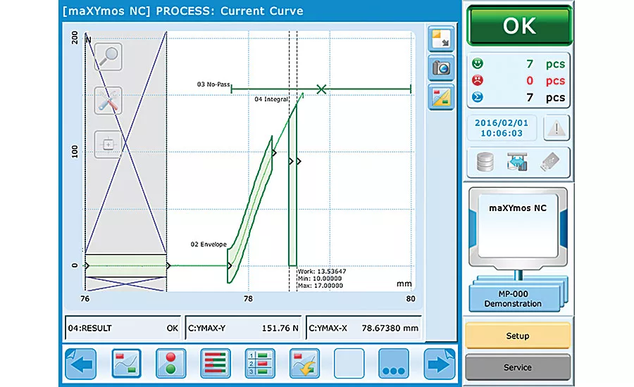

During a joining operation where an interference fit occurs, a signature force vs. displacement curve is generated.

Strategies for Analyzing Live Data
PC-based analysis system: PCs are widely available and are relatively inexpensive. However, they are susceptible to IT policies, updates and malware – which can interfere with production systems. PCs are ideal for offline data analysis.
Embedded analysis system: Embedded computing systems designed for industrial use are the types of computers that should be on the plant floor. For 24/7 uptime manufacturing operations, a deterministic embedded computer should be used for data analysis and live signal processing. An embedded system evaluating live force/displacement data can even help to identify manufacturing flaws while the parts are being formed – saving cycle time and capturing non-nominal parts further upstream.
Strategies for Analyzing Offline Curve Data
Production software: Generally a large modular platform that can encompass all operations on a plant floor. May be integrated into production or quality systems but usually delivered with a hefty price tag.
Math software: More generic; a 3rd party developed open architecture platform that may be customized but requires extensive knowledge to program and maintain.
Vendor Developed Software: Supplied by press provider generally offers a user friendly application specific platform that offers powerful visualization and analysis of processes but is not easily customized.

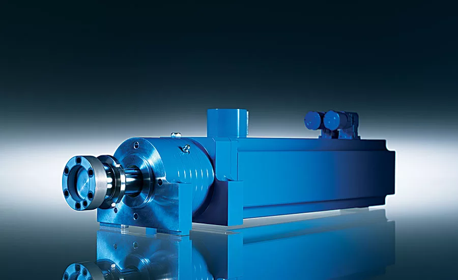

The mechanical modules have two main components: servo motor and a linear screw. The motor mounting configuration comes in 3 varieties where the screw is limited to two types. There are advantages for each but some systems offer far greater benefits when compared to other types.
Integrated servo motor: Direct-driven; provides a stiff connection with no belt wear or backlash and requires less maintenance. Very compact in size compared to an externally mounted motor of equal force.
Externally mounted coupled servo motor: Direct-driven; provides a stiff connection with no belt wear or backlash and requires less maintenance
Externally mounted belt driven servo motor: Drive belts provide a point of failure and position accuracy due to belt wear or backlash. Drive belts require additional steps for maintenance crews for inspection and tightening.
Ball screw vs. planetary roller: Both are well-suited for most joining and press fit applications. The planetary roller can handle much higher loads with the same motor size due to the load is distributed over a greater contacting surface area. This reduces heat, increases efficiency and extends longevity.
Kistler Type 2151B… NCFH Joining Module with hollow shaft motor
