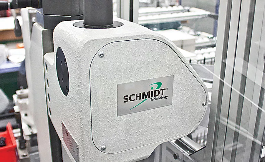

To increase productivity, manufacturers are continually looking for new ways to automate their assembly processes. To address the need for assembly presses that are ideally suited for automated pressing, SCHMIDT Technology recently introduced its servo-controlled ElectricPress Series. Bridging the technology gap between a standard air press and a servo press system, these versatile presses are ideal for applications requiring precise and programmable ram positioning and force control. Because of their innovative rack and pinion drive system, SCHMIDT® ElectricPresses are more cost effective than ball-screw-driven servo presses while providing the same level of control. And when an ElectricPress is equipped with the SCHMIDT PressControl 600, this press control system can be easily programmed to control the automation tasks of transferring and positioning components.

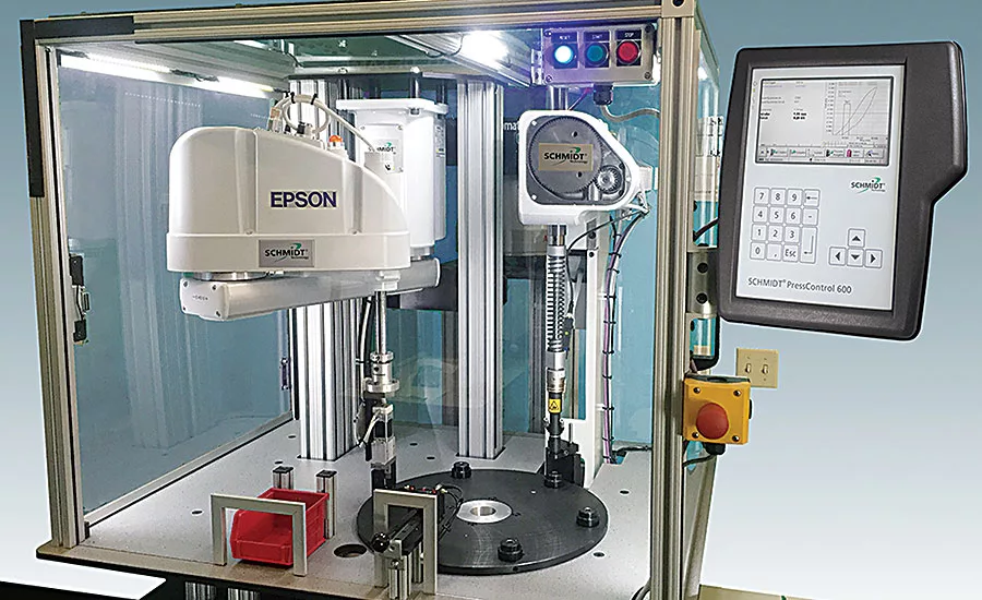

Equipped with an integrated load cell, the more advanced ElectricPress 343A works in tandem with the SCHMIDT® PressControl 600 to manage all ram motion via true closed loop position and force control and includes full process monitoring capabilities. The PressControl 600 interfaces with the customer’s system through discrete I/O, ProfiBus and EtherNet/IP.
ElectricPress 343 Drives Turnkey Automated Pressing Cells
For a fully operational automated pressing cell, SCHMIDT Technology will build the system around its ElectricPress 343 and the PressControl 600. During each press cycle, performance results are automatically captured and compared against user-established parameters. If a result falls outside the parameters, the operator is instantly alerted so that corrective action can be taken immediately to eliminate the wasteful buildup of costly rejected parts. Performance results and the specific monitoring criteria set up to control the pressing process can be stored in SCHMIDT® DataBase software. The PressControl 600 can also be used to control secondary automation accessories such as indexers and slide tables.
