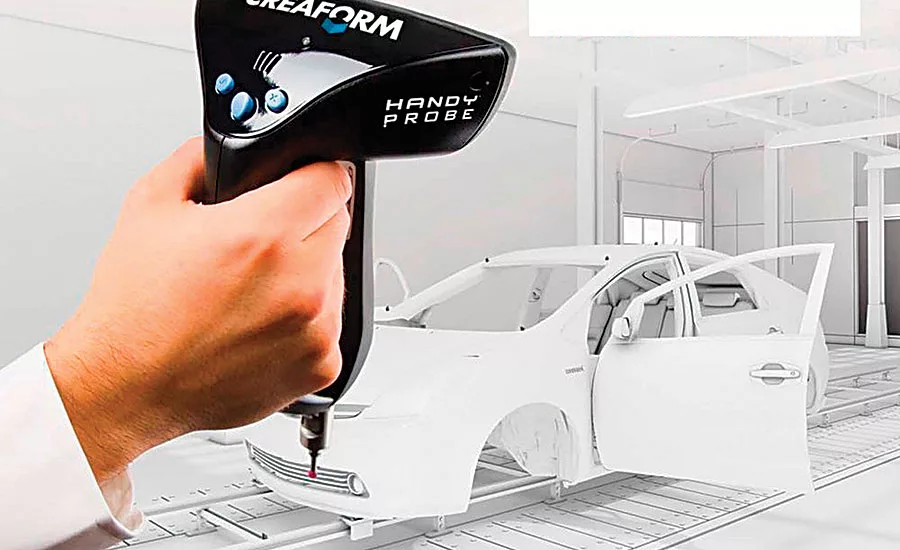

To determine the exact degree of rear chassis deformation, an application engineer used a HandyPROBE, optical scanner and dual-camera sensor. Photo courtesy Creaform Inc.

To determine the exact degree of deformation, Nova hired Creaform Inc., which makes 3D measuring equipment and performs 3D measuring services. For this application, Creaform’s application engineers and metrologists used a dual-camera C-Track sensor, MetraSCAN 70 optical scanner and HandyPROBE.
Measuring was performed at the point on the assembly line where the radiator had just been installed on the chassis. After positioning the tripod-mounted sensor so its optics could visually locate the chassis, a Creaform engineer probed the chassis with a HandyPROBE and downloaded the data into a PC. He then measured the chassis from different positions with a MetraSCAN 70 optical scanner, which sent real-time data over a cable to the PC. This probing-and-scanning process was repeated on four more chassis.
Data analysis was then performed by the Creaform team over the next two weeks. It consisted of three steps. Step one was to determine if variations in radiator mounting point hole patterns were within the tolerances allowed by the ASME Y-14.5M standard. Next, the team used colorimetry on a CAD model to compare geometric variations of the chassis with those of the radiator mounting points.
Finally, colorimetry on a CAD model was used to compare the distortion of the installed chassis to its theoretical form—without taking into consideration the impact of the radiator mounting points. After sharing this information with Nova, the two teams worked together to make specific assembly-line process changes and eliminate chassis deformation.
