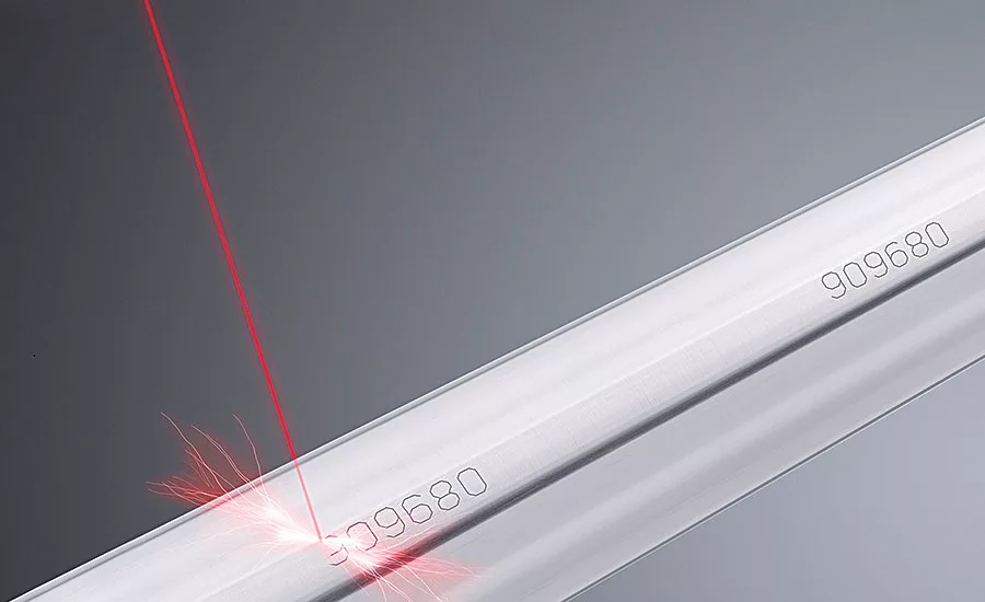

Some laser marking systems can perform on-the-fly marking. Photo courtesy Trumpf Inc.

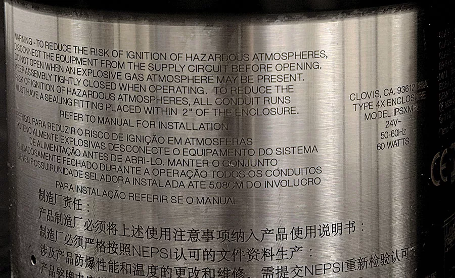

In the former case, for example, one California-based manufacturer of surveillance cameras had Control Micro Systems Inc. integrate a laser-marking system that marks hundreds of characters on a circular stainless steel camera housing in just a couple minutes. The housing measures 10 inches wide, 6 inches high and contains about 20 lines of text that cover nearly all 360 degrees of its exterior. Marked information includes power capabilities, model and serial numbers, and warnings in English, Spanish and Chinese related to the camera’s ignition risks.

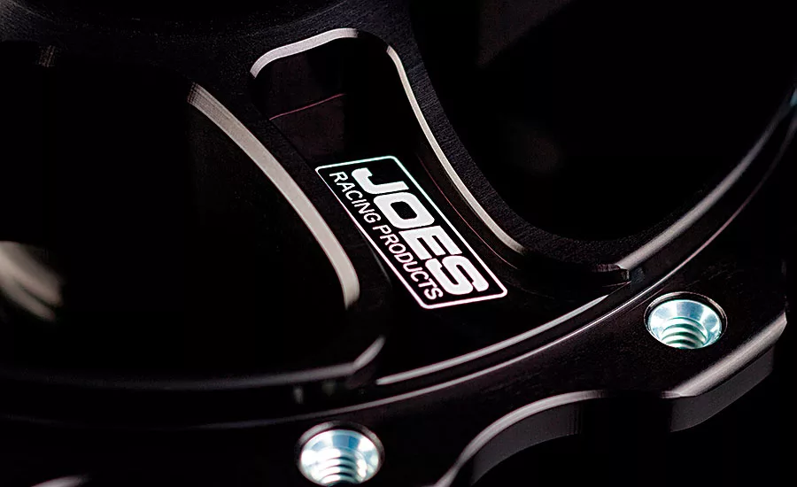

Another West Coast company—JOES Racing Parts, based in Everett, WA—laser marks a wide range of anodized metal parts for karts and sprint, stock, drag and quarter-midget racing cars. Part types range from camber gauges and carburetor linkages, to fittings and switch panels.
Recently, JOES began using the Fenix Flyer CO2 laser marker from Synrad (a Novanta Inc. company), instead of marking parts mechanically (dot-peening) or sending them to a laser job shop for marking. With this marker, JOES creates crisp, clear marks on stationary or moving parts at speeds up to 450 characters per second. Justin Conroy, laser applications engineer at Synrad, says the dot peen marks aren’t sharp enough for the company’s complex logo, and having parts laser-marked at a specialty job shop is too expensive.

On metal surfaces, marks are created through engraving, annealing or surface removal. Laser engraving vaporizes the surface material. Annealing is done to create a contrasting mark. The surface removal process is used on multilayer materials such as anodized aluminum.

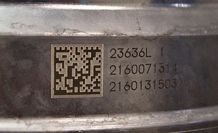

According to Thomas Burdel, TruMark national sales manager at Trumpf Inc., lasers can mark any character (text, logos, 1D and 2D bar codes, unique identifier symbols) or image that can be created or imported into CAD-based or graphics software programs like Illustrator and Corel Draw. He notes, however, the importance of always having a supplier test the laser on a material sample to ensure compatibility and the highest quality marking.
