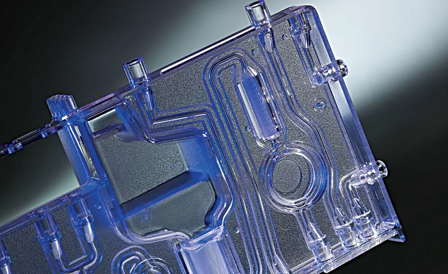

This plastic microfluidic device was welded with a laser. Photo courtesy Branson Ultrasonics Corp.

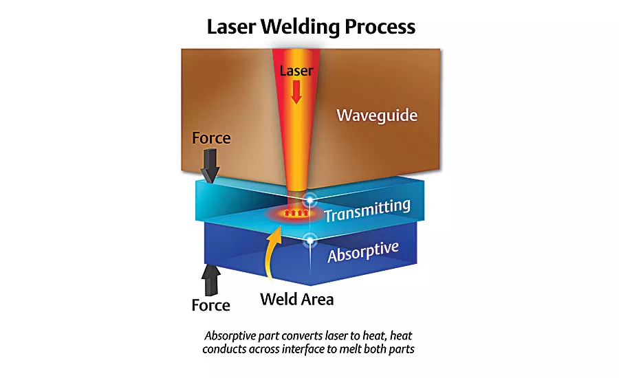

In Branson’s laser welding process, fiber optic bundles transmit laser light through a waveguide that uniformly distributes the energy to the entire joint line simultaneously. The light passes through the top part and is absorbed by the bottom part. The absorptive part converts the energy to heat, which conducts across the interface to melt both parts and produce a weld. Photo courtesy Branson Ultrasonics Corp.

As plastic medical devices get smaller and more intricate, engineers have fewer options for assembling them.
Friction-based joining processes, such as ultrasonic welding, spin welding and vibration welding, work fine for most assemblies, but they can also generate particulates, and that’s a no-no for some medical devices. For example, the fluid channels inside a blood test cassette might be a millimeter wide. Even small particulates could impair the cassette’s performance.
Laser welding solves that problem. “The overriding reason medical device manufacturers choose laser welding is that it’s a clean joining method,” says Hugh McNair, manager of laser applications and systems at Branson Ultrasonics Corp. “It does not generate particulates.”

Branson’s process—simultaneous through-transmission infrared laser welding—is unique. Multiple diodes produce laser light at a wavelength of 990 nanometers. Fiber-optic bundles transmit the light through a waveguide that uniformly distributes energy to the entire joint line simultaneously. (In other technologies, the laser traces or scans the joint line.)
The light passes through the top part and is absorbed by the bottom part. The absorptive part converts the energy to heat, which conducts across the interface to melt both parts and produce a weld. The two halves of the part are clamped together throughout the process.
