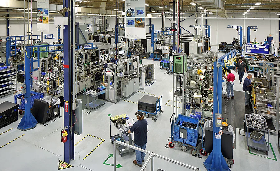

Bosch Rexroth Fountain Inn is a high-mix, lowvolume facility. Photo courtesy Bosch Rexroth Corp.

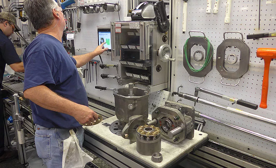

Workstations are equipped with touch screens that allow assemblers to view drawings and work instructions. Photo by Austin Weber

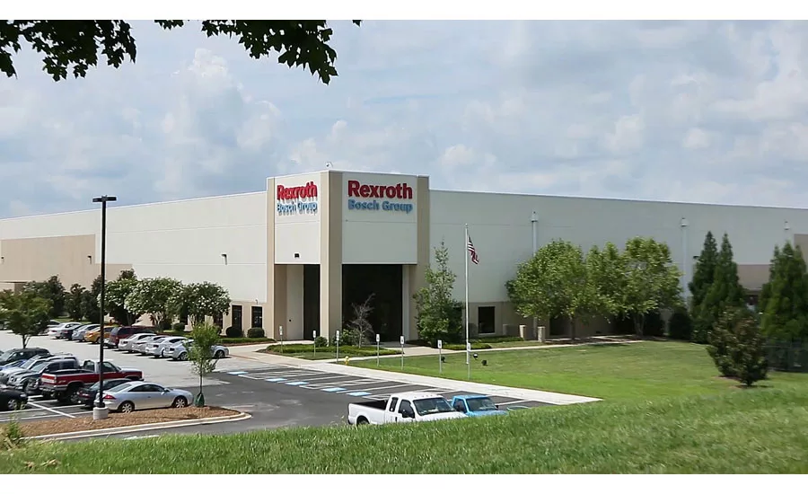

Fountain Inn is Bosch Rexroth’s largest manufacturing site in North America. Photo courtesy Bosch Rexroth Corp.
2016 Assembly Plant of the Year: Bosch Rexroth Flexes Its Lean Production Muscle

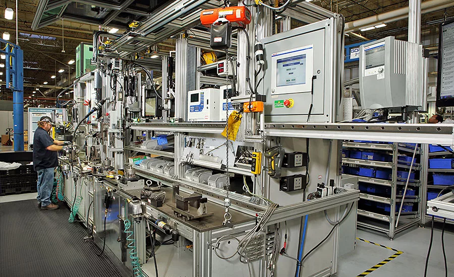

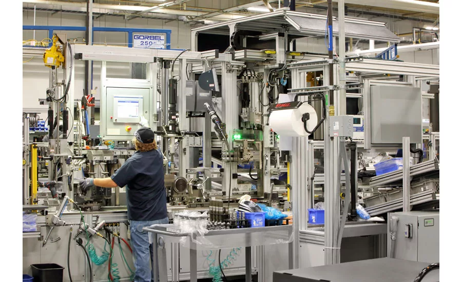

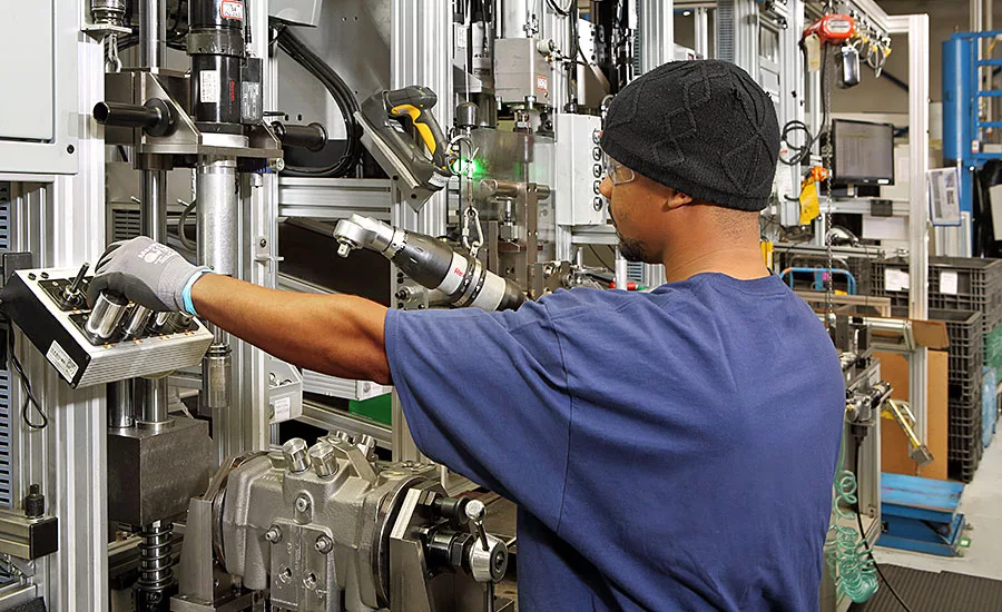

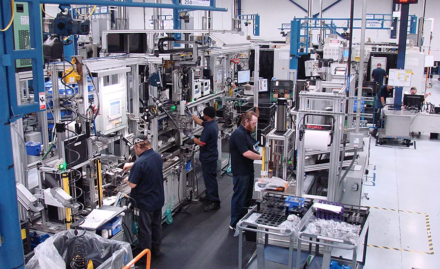

Bosch Rexroth Fountain Inn assembly lines use numerous advanced technologies to reduce cost and improve quality. Photo courtesy Bosch Rexroth Corp.

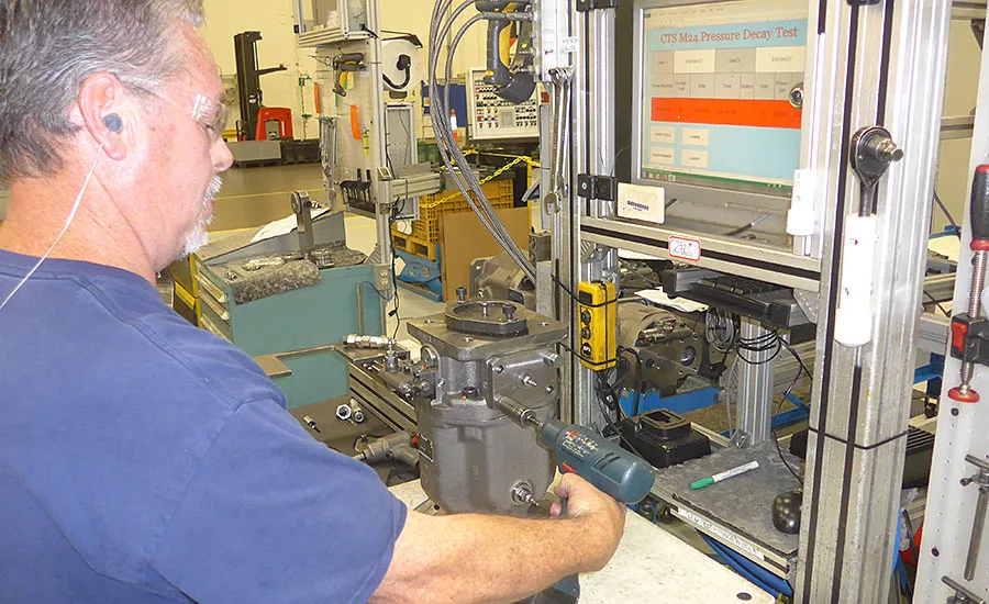

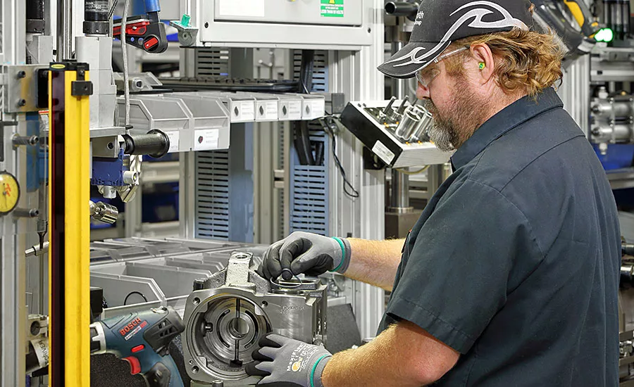

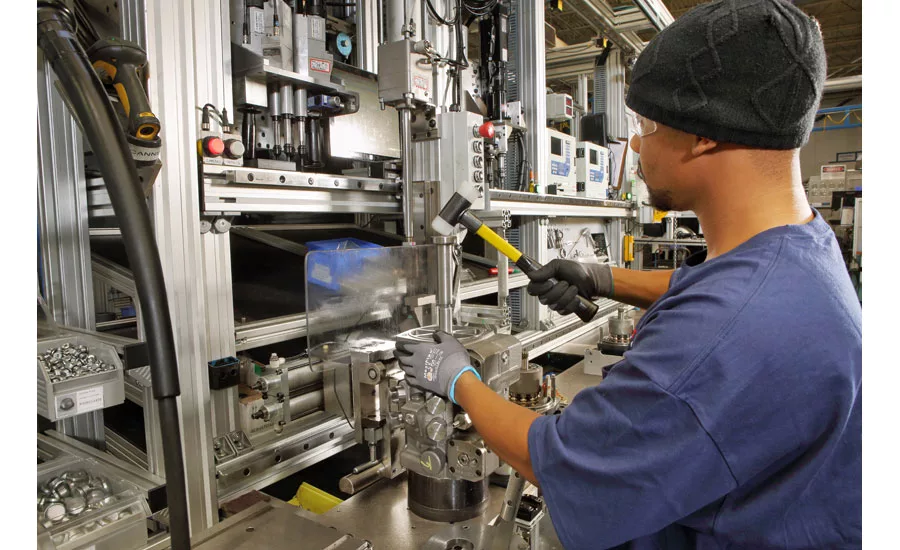

Assemblers at Bosch Rexroth’s Fountain Inn plant use many types of fastening tools, including battery-powered screwdrivers. Photo by Austin Weber

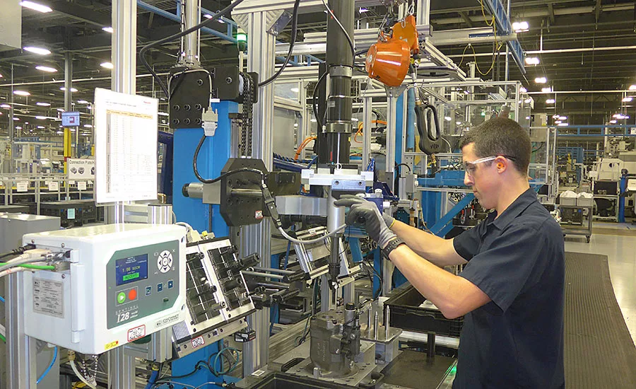

Quick changeover plays a key role in the success of the 2016 Assembly Plant of the Year. “Photo courtesy Bosch Rexroth Corp.

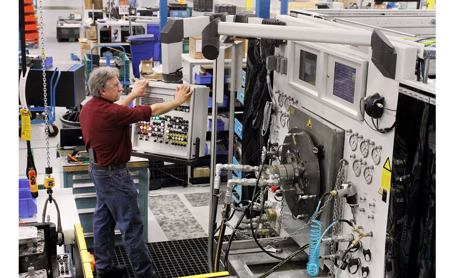

Bosch Rexroth’s Fountain Inn, SC, facility includes 21 test stands. Photo courtesy Bosch Rexroth Corp.

The high-mix, low-volume facility prides itself on timely delivery. In fact, the majority of the factory’s products are built to order.
Bosch Rexroth’s 100-acre manufacturing campus is vertically integrated and consists of three buildings. It includes two state-of-the-art machine shops, nine assembly lines, 21 test stands, two heat-treating facilities and a paint shop. The campus also houses engineering, product development, logistics and warehousing operations.
Bosch Rexroth is the global market leader for mobile hydraulics. It produces more than 5,000 different models and variations for both open- and closed-loop applications.
Fountain Inn is Bosch Rexroth’s largest manufacturing site in North America. It supports the company’s “local for local” strategy. Besides supplying key U.S. customers, the facility also exports to Brazil, Canada, China, India, Mexico and many European countries.

“In 2008, we used simple benchtop assembly methods with only basic hand tools,” McCormick points out. “Today, our assembly lines use numerous advanced technologies to simultaneously reduce cost and improve quality.”

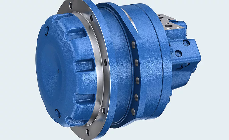

The 2016 Assembly Plant of the Year specializes in fixed and variable hydraulic motors and pumps.
Fixed and variable products look similar, but typically a pump weighs twice as much as a motor. Each product contains different types of components on the inside for their functional purposes. In particular, the control mechanism adds significant weight.
“Pumps are typically more complex than motors,” says Joerg Schaeuble, director of operations. “One reason is that a pump can be the driving element of the power train and, therefore, typically controls itself and the downstream motor.
“This includes electro-proportional control valves and other electronics that control the machine,” adds Schaeuble. “So, it is easier to integrate a customer’s machine performance attributes into a pump, which itself is located close to the primary mover of the equipment (a diesel engine).
“Additionally, in a closed-loop system, the swashplate pump is the only component that can switch pressure ports easily with full variability under full pressure,” Schaeuble points out. “Motors (typically a bent-axis unit) have a minimum and a maximum position for performance, but they cannot swivel through the zero or neutral point.
“This is why the high-pressure port on a pump can be the A or the B port: both have the same performance characteristics,” explains Schaeuble. “Many safety features, such as high-pressure relief and pressure override, are also located in the pump.”
Hydraulic motors and pumps are used in all sizes, shapes and types of mobile equipment. Everything from cranes, dozers and excavators to backhoes, skid loaders and sprayers demands fluid power.
The typical piece of construction equipment requires several hydraulic motors and pumps to operate. However, the number of components depends on the application. For instance, mini excavators can run all functions with just one pump, while a traditional full-size excavator requires several pumps.
Bosch Rexroth’s customers include companies such as AGCO, Bobcat, Caterpillar, CNH, Deere, Doosan, Fendt, Gehl, Gradall, JCB, Liebherr and Sany.
“Our largest customers have their R&D headquarters in North America,” says McCormick. “That enables us to work closely with them and build products that help them meet tough emission regulations, while increasing productivity and reliability at the same time.”

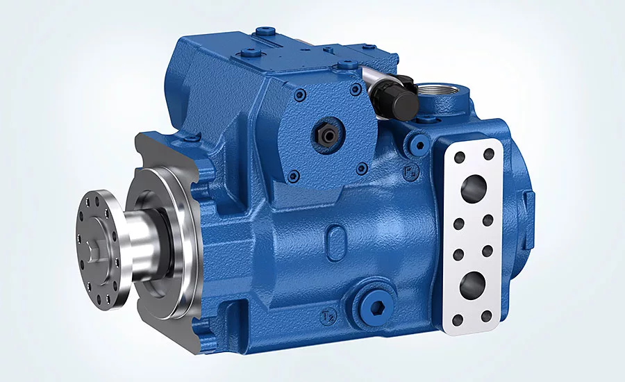

Bosch Rexroth Fountain Inn assembles four main product families: A22VG and A24VG axial-piston, variable-displacement double pumps; A10VO/31 and A10VO/52 variable-displacement pumps; A4VG/32 and A10VG variable pumps; and Rineer high-torque vane motors.
A22VG and A24VG pumps feature two axial piston rotary groups and are engineered for hydrostatic drives in closed-loop circuits. They feature a high power rating in a compact design for medium- and heavy-duty applications.

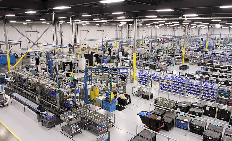

Plant Expansion
In 2013, Bosch Rexroth embarked on an $80 million, five-year journey to expand production on the Fountain Inn campus. The first step was to acquire a nearby 260,000-square-foot building that previously served as a warehouse for a pharmaceutical company.
The legacy building is now devoted to the machining and assembly of hydrostatic VG products. It includes four assembly lines, in addition to a heat treating facility and a paint shop.
Sandwiched between the old and new production buildings is a facility that houses logistics and shipping operations. A large area is also devoted to remanufacturing, spare parts and repairs, which is an important piece of Bosch Rexroth’s business strategy.
Bosch Rexroth engineers retrofitted the third building to produce open-loop products, such as its popular VO-series of variable displacement pumps.
The newest facility features five assembly lines, including an automated line equipped with a palletized conveyor that replaced three former lines. The vertically integrated facility includes a state-of-the-art machining operation that produces a wide variety of metal parts in-house, such as cylinders, driveshafts, housings and port blocks.
“We have mastered a lot of complex processes,” says McCormick. “The challenge is to do this with small lot sizes and high part tolerances.
“The degree of vertical integration varies depending on the product type and volumes,” adds McCormick. “To meet market-driven lead times, we retain the capability to manufacture many of our components in-house, while in parallel developing partners that can supply higher volumes, as needed, to meet overall market demand.”

The expansion also allowed Bosch Rexroth engineers to optimize value streams and rethink material handling systems at the Fountain Inn plant.
“It gave us a white canvas to create the best material flow and best layout using lessons learned in our legacy building,” says McCormick. “Our logistics organization now allows us to be extremely flexible.
“In our high-mix, low-volume environment, we’re able to easily accommodate orders that can be as low as one to five pieces,” claims McCormick. “Kitting is the key to doing that efficiently.”
“Our next-generation system integrates material handling and logistics into the assembly process,” notes McCormick. “We’re also building in flexibility and intelligence at individual workstations.”
The Fountain Inn plant is currently in the process of transitioning to a 100 percent kitting process. The lean material handling initiative aims to improve the quality and cleanliness of parts presentation to the line, in addition to streamlined material flow and overall efficiency. Small parts are presented with recyclable packaging in a way that prevents contamination from debris and airborne contaminants.
The new system relies on totes and tuggers to deliver parts to the assembly line instead of bulk containers delivered by forklifts. This will result in better use of floor space, creating a 60 percent smaller footprint. Additional benefits include increased throughput and improved delivery.
“Our assembly lines can be changed over within one product cycle,” says Schaeuble. “This was a key design requirement when the lines were built. The equipment is programmed in a fashion that allows changeover station by station.
“In addition to the technical aspects of changeover, we also benefit from engagement of our associates in continuous improvement of changeovers,” adds Schaeuble. “For example, changeover sequence is optimized by the complete value stream team to ensure the most efficient use of our capacity.
“The tools we use to change over were simplified with input from employees,” Schaeuble points out. “This led to innovative adaptor designs that are faster and easier to handle rather than complete tool exchanges. Overall, we have seen a 40 percent reduction in changeover losses in that bottleneck station.”
Capacity issues can be addressed through overtime and weekend shifts as necessary. The specific assembly process is optimized for each value stream based on the design of the product.
At Bosch Rexroth Fountain Inn, the assembly process starts with the kitting of each customer order with all required components. After this, a serial number plate is affixed to the product and serves as the process control element throughout assembly.
“The subsequent process sequence for each value stream is somewhat different, but normally consists of bearing package assembly, rotating group assembly, final assembly and leak testing,” explains Schaeuble. “Each value stream has a maximum lot size regardless of the customer order size. This allows us to optimize all other support processes and planning to fit with the lot size.”
All controlled documents, including work instructions, are stored on a computer network that is accessible on each individual line. Assemblers can view the latest version of drawings, instructions and other information at any time.
To assemble a hydraulic motor or pump, operators start with a cast-iron housing that typically weighs about 45 pounds. “More than 20 different housings are used on the A22VG line alone,” says Bruce Woodward, assembly and test engineer. “By the time a pump is fully assembled, it weighs more than 100 pounds.”
Because of those heavy loads, all of the assembly lines are equipped with jib cranes and ergonomic lift-assist devices.
Assemblers manually install bearings, cylinders, driveshafts, filters, gaskets, O-rings, pistons, plugs, seals, valves and other components. Units are attached with a variety of fasteners. For instance, pumps typically require four rivets, a minimum of eight bolts, and anywhere from three to eight threaded steel or plastic plugs.
Bosch Rexroth Fountain Inn uses many types of fastening tools on its assembly lines, including air, DC-electric and battery-powered devices.
“Air tools are typically used for assembly processes that do not require a precise control of torque and angle, such as the installation of break-off plugs,” says Woodward. “These tools are also used to prepare our products for function testing, such as connectors on the test stand and removable covers.”
DC-electric fastening tools are used for all connections that are critical for the function of the pump, including valves, controls and plugs. Both torque and angle are monitored.
Battery-powered screwdrivers are typically used in low-torque applications, such as installing fittings for in-line leak testing.
Because Bosch Rexroth happens to be a leading supplier of production tools, the Fountain Inn assembly lines use the company’s state-of-the art screwdrivers.
“We extensively use ErgoSpin handheld nutrunners, combined with an HMI developed by Bosch Rexroth,” says Schaeuble. “These tools streamline the processes used in assembly and enforce a uniform application of the assembly standards for all products made in Fountain Inn. As a result, the assembly process has become much more predictable and reliable.
“ErgoSpin tools are mainly used to verify critical connections for our customers,” Schaeuble points out. “Part of our zero-defect strategy is to use and monitor the data coming out of these systems for the benefit of our customers, as well as internal operations. The implementation of these systems has resulted in improvements to our assembly process stability.”
Bosch Rexroth structural framing systems are also widely used throughout the Fountain Inn plant. The modular aluminum pieces, which can be easily connected together, are used for base structures, flow racks, workstations and white boards.
Servo presses are used on the assembly lines to attach driveshafts, flanges and other components. “Equipped with force and distance measurement, these machines enable us to detect any minor variations in our product and alert us to trends in component geometry,” says Schaeuble.
“We use in-line leak testing after assembly to ensure an absolute leak-free product is delivered to our customers,” adds Schaeuble. “Depending on the value stream and product, we select the most sensitive leak-test process, primarily pressure decay and mass flow. As with other key quality attributes, the leak test results are archived by serial number for the expected life of our product in the field.”
Last year, Bosch Rexroth engineers developed an assembly sequencing program to improve quality at the Fountain Inn plant. The program guides operators through the assembly process. It prevents an operator from starting a new operation at the beginning of the line until a certain operation at the end of the line is complete. This dropped detected assembly errors from about 15,000 parts per million per day to 0.
The leak testing operation was also improved to address a common customer complaint. “Failures were analyzed and actions were taken, and we were able to increase the sensitivity for the equipment to find even miniscule deficiencies,” says Schaeuble. “This led to an 85 percent reduction in leak-related customer complaints.
“From an overall facility standpoint, that project resulted in a drop of customer complaints by more than 40 percent from to 2013 to 2014, and another 20 percent from 2014 to 2015,” claims Schaeuble. “Based on current data, we expect to see a further reduction this year.”
Bosch Rexroth engineers have also implemented machine vision systems to improve quality yields on the Fountain Inn assembly lines.
“Typically, cameras are used as a level two poka yoke to block processing of a product which is either not properly assembled or which has an incorrect component inside,” says Schaeuble. “It is a failsafe system approach to drive us to zero-defect quality.”
