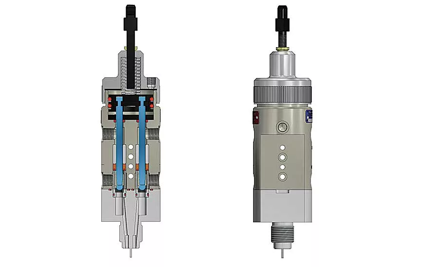

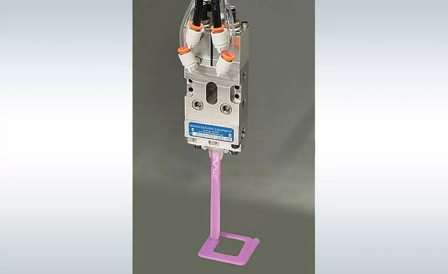

When dispensing two-component materials with different viscosities, it is critical that both materials come together in the mixer at the same time, on ratio and at the correct flow rate. If this does not happen there is a possibility the mixed material will not cure, leaving an uncured “soft spot” in the encapsulant or a place where the material does not adhere, resulting in failed or scrapped parts and loss of production. The lower viscosity material will flow more readily and with less back pressure than the thicker material. It is therefore important to design the dispense valve so the thinner material does not come out of the valve sooner that the thicker material. This condition is called “Lead-Lag”. To resolve this difference, forethought must be given to the sizing of the valve exit ports, so the back pressure and flow rates of the two materials allow proper flow and a uniform, homogenous mix. If the problem cannot be resolved, a dual valve static mix manifold could be used.
Viscosity can also influence how the material stops flowing when the dispense valve is shut off. Ideally you want the flow of material to stop clean once the valve is turned off. This prevents wasted material, having the mixed material string or ooze on the outside of the parts. Thinner materials that seek their own level need to be dispensed from a No-Drip, ball & seat style dispense valve. This style of valve shifts the ball onto the seat, impeding the flow of the material. Thicker materials that cause greater back pressure in the mixing chamber and can be stringy and difficult to shut off cleanly from the mixer require a Snuf-Bak, spool style valve. The Snuf-Bak valve draws a spool back to shut off. This action eliminates the pressure in the mixer that would bleed out if it is not reduced.
