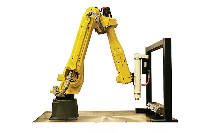

Robots can’t handle reaction force
There is no escape from the laws of physics, for every action there is an equal and opposite reaction. When a Promess EMAP presses to an X-amount of force, the robot must be able to hold X-amount of force. However, typically robots are not designed to hold large amounts of force.
Thus, Promess developed the Integrated Back Stop press add-on, which helps eliminate the need for the robot to take on any of the pressing force. How the process works is that once the robot gets the press into position, it would then enter a float state. This float state would allow the press the ability to move axially backwards until it encountered a reinforced structure. At that point we would begin our pressing application transferring all the reaction force into the structure. This process could then be repeated in several different locations with the same type of structure.
Minimize Weight
With the Integrated Back Stop taking on all the reaction force, the robot’s only responsibility is being able to handle the physical weight of the press. A standard Promess EMAP 20kN unit weighs in at roughly 200lbs, and adding the Integrated Back Stop would add additional weight. Our goal was to optimize components specifically for robotic applications that would help us save on overall weight. We designed more “form-fitting” components, like our motor mounting plate which is traditionally rectangular in shape but now resembles more of a pear shape. We also utilized smaller motors in tandem with gearboxes, as compared to our standard which uses larger motors and no gearboxes. Finally, we were able to eliminate some features like cables and a proximity switch by switch to absolute encoder motors. Also, we removed certain mounting features that wouldn’t necessarily fit into a robotic press design.
By doing these small things we were able to cut the additional weight by more than half, thus helping us minimize the overall press weight allowing for the use of smaller robots.
