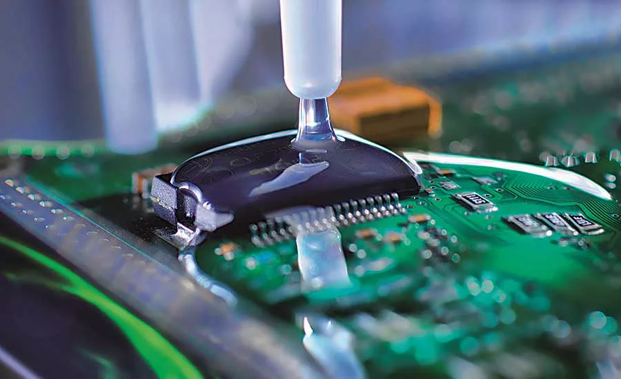

Potting of electronic components under vacuum drastically reduces voids in the material caused by entrapped air or water. Photo courtesy Scheugenpflug USA

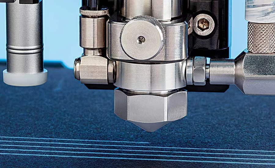

Dispensing parameters include 1-millimeter-wide beads of varying lengths. Photo courtesy Nordson EFD

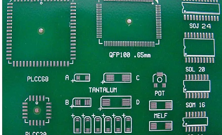

Solder paste connects surface-mount or through-hole components to pads on the PCB. Photo courtesy Dispense Works Inc.

Potting materials remove voids caused by air or water as they cover electronic components, thereby protecting them from moisture, or electrically insulating them so they operate correctly. The materials also provide heat dissipation, shock protection and flame retardancy.

Solder paste connects surface-mount or through-hole components to pads on the PCB. Flux within the paste removes potential oxides from the pads, resulting in clean and positive wettable surfaces to which the metal solder bonds. The paste is thixotropic, meaning that its viscosity changes over time (300,000 to 1.6 million cps) due to stirring.

Eckel points out that manufacturers need to quickly and accurately dispense tiny amounts of adhesive onto components on a daily basis. Common dispensing parameters are dots smaller than 1 millimeter in diameter and 1-millimeter-wide beads of varying lengths. With shrinking mobile device sizes, strict accuracy is required to maintain parameters. Otherwise, splattering adhesive on nearby components or optics may result in rework and wasted material.

When used together, Nordson EFD’s PICO Pµlse valve and PICOToµch controller ensure exact and repeatable dispensing of microdots as small as 0.5 nanoliter at up to 1,000 hertz continuously. The noncontact valve’s piezoelectric technology enables it to jet low- or high-viscosity fluids onto any surface, including uneven and tough-to-reach substrates. Interchangeable parts increase the valve’s versatility. An easy-to-use touch screen on the controller lets operators set precise operating parameters (such as ramp open and close) and stroke control to fine tune dispensing performance. Pulse time adjusts in increments as small as 0.01 millisecond.

A frequent challenge related to potting is eliminating trapped air, which will expand when the device heats up and crack the housing. The advantage of using a Cartesian robot for automated dispensing is that it can be programmed to move the dispense tip around the housing to ensure an air-free fill. In some cases, the tip may need to move back and forth to evenly distribute the material and avoid entrapping air. Ideally, the housing should be filled from the bottom up, rather than from the top down.
“Although solder paste dispenses fairly well, it does contain solder fillers that can cling to component edges and fittings,” says Cindric. “These fillers can lead to material separation and the forming of clumps within the fluid
dispense path.”
Some suppliers offer dispensing systems with noncontact laser or low-force height sensing to ensure accurate, consistent and repeatable dot size and line widths. Dots smaller than 300 microns typically require solder paste type 5 (10- to 25-micron particles) or type 6 (5- to 15-micron particles) and a 28 to 30 gauge needle. As a general rule, solder paste should be 84 to 86 percent metal by weight.
