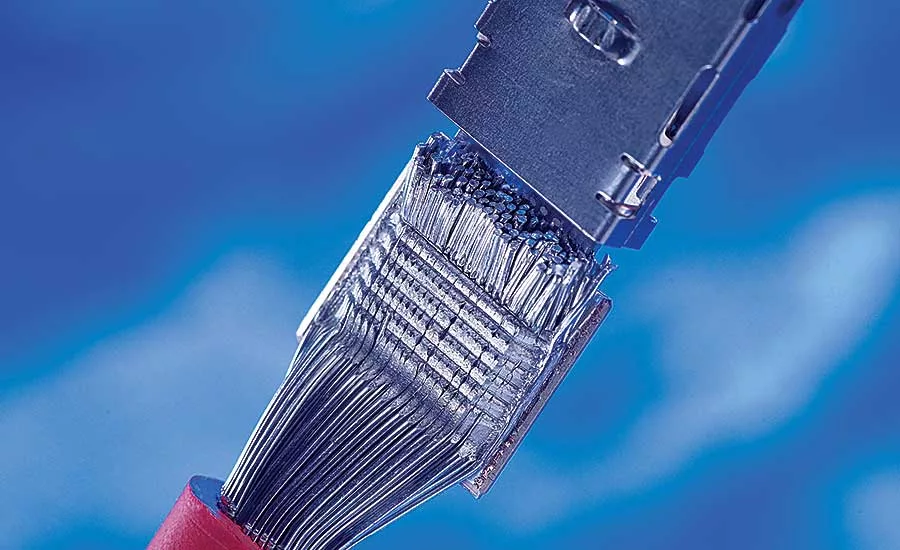

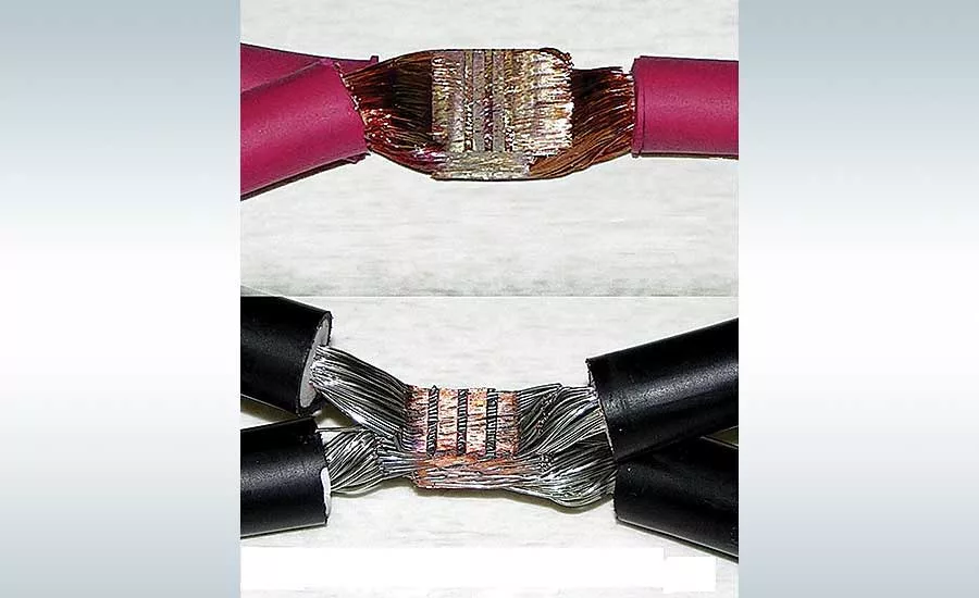

Since the early 1980s, ultrasonics has been used for wire splicing and to weld wires to metal connectors and terminals. The process involves vibrating wire strands together under pressure at a frequency of 15 to 40 kilohertz. The vibrational energy disperses surface oxides to create a galling on the strands and form a solid-state metallurgical bond.
“The ultrasonic process provides a low resistance weld,” notes Joe Stacy, employed by Emerson as national sales manager for Branson Ultrasonics Metal Welding, Americas. “And a low resistance weld allows for the use of smaller cables, which saves manufacturers money and space.”
Typically, conductive materials like aluminum, nickel, silver, copper and gold are ultrasonically welded. The process consumes about 80 percent less energy than resistance welding and it does not require water cooling. And, unlike soldering, ultrasonic welding doesn’t require flux or filler materials.

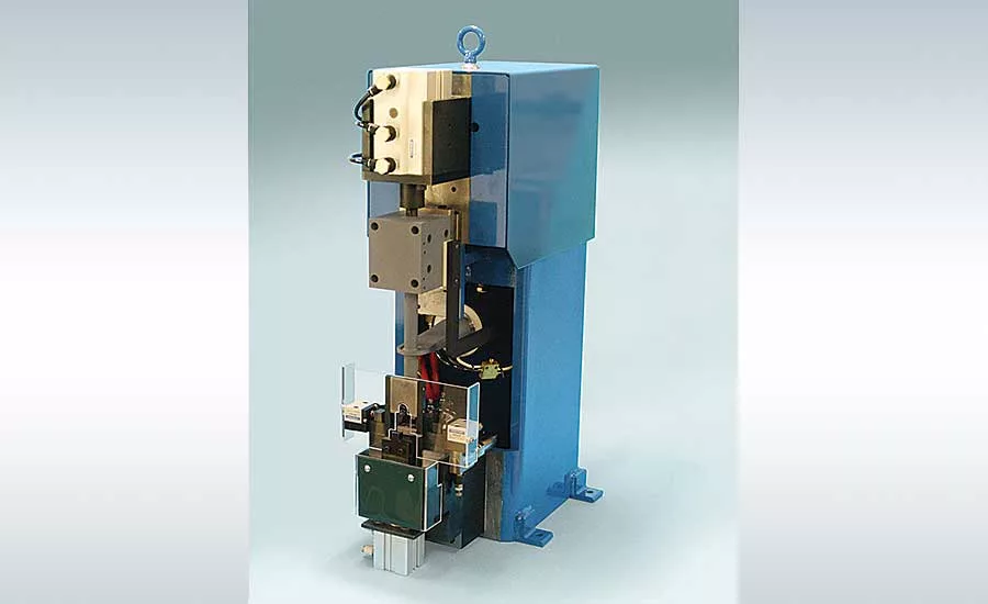

Sonobond’s SPG (single point ground) 2600 welder ultrasonically welds wire bundles of up to 20 square millimeters (18 wires maximum) to a single terminal. The microprocessor-controlled unit accomplishes the weld in one pulse before automatically folding the terminal arms to provide stress relief on the joint. It handles standard and lightly tinned or oxidized wires.
Devine says the welder features a patented Wedge-Reed system instead of a lateral drive system. The former combines low vibratory amplitude with high vibratory force directed in a shear mode parallel to the interface of the materials being welded. This produces a much better impedance match to a metal weldment, which is six to nine times more dense than plastics.

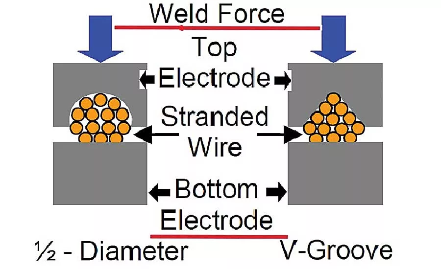

“The key to successfully resistance welding stranded copper wire to different kinds of terminals is preventing it from spreading out during welding,” explains David Steinmeier, founder and president of microJoining Solutions (mJS), a consulting company. Since 1998, mJS has specialized in laser and resistance welding process development, optimization and validation. “Any and all wire strands that spread past the joint can short out nearby connectors.”
Steinmeier offers four methods to capture these strands. The first is electrical solidification, which involves solidifying the stranded wire into a solid copper block by passing a high electrical current through the block via top and bottom tungsten electrodes. Force on the top electrode helps compress and solidify the stranded wire. The solid block is then welded to the terminal.
Another option is making a V-shaped groove or one-half-diameter arc on the electrode tip, and then placing the strands within this area during welding. This method may not capture and weld all strands, plus it presents the challenge of cleaning and maintaining the tip, and the possibility of the top electrode shorting out against the bottom one and terminating the welding process.
The pig tail insulation method involves separating, but not removing, insulation from the wire (to reduce wiring spreading during welding) and contacting the exposed wire strands with a flat rectangular top electrode. A final option is to design your fixture with guideposts or retaining pins that hold the stranded wire over the terminal and prevent the strands from spreading during welding. This design can accommodate one or more terminals.
