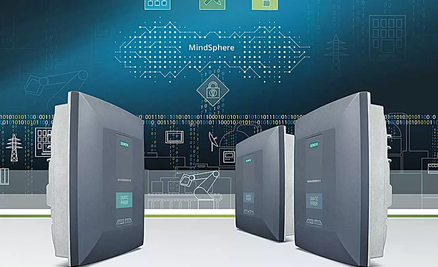

The Simatic RF600 RFID system now supports the open interface OPC UA. The new firmware allows devices to be connected to Siemens’ cloudbased open Internet of Things operating system, MindSphere. Photo courtesy Siemens Industry

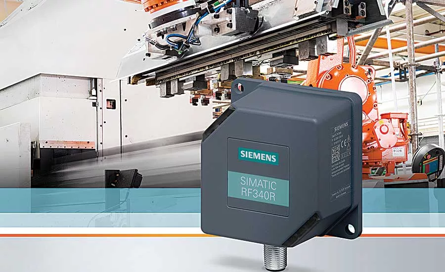

Siemens’ compact Simatic RF300 RFID system is designed for controlling and optimizing material flow in closely packed assembly lines. Photo courtesy Siemens Industry

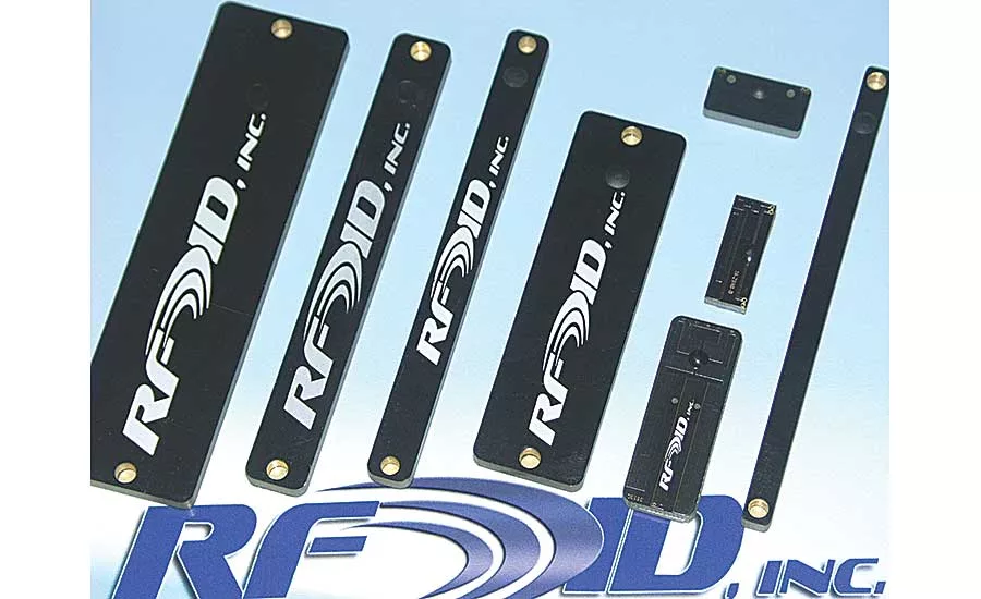

Available in a variety of sizes, these FR4 RFID pallet tags can withstand a temperature of more than 200 C. Photo courtesy RFID Inc.

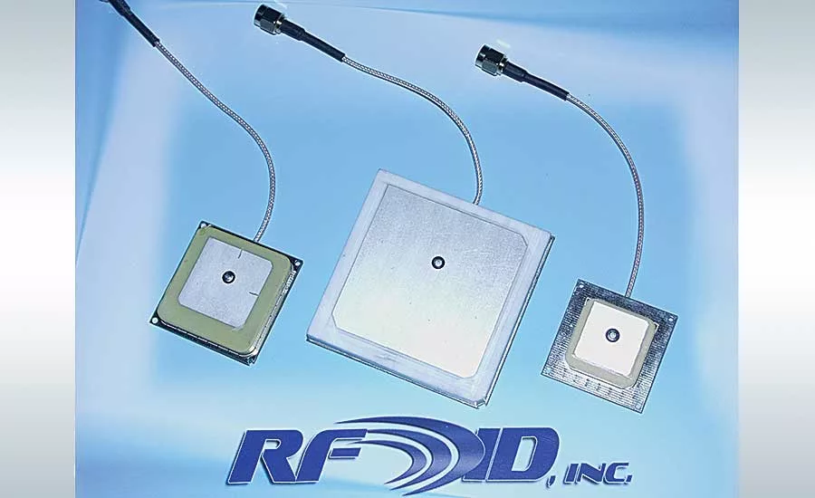

These ceramic UHF RFID antennas come in an array of sizes and power. The smallest is 25 millimeters square. The largest is 80 millimeters square. Photo courtesy RFID Inc.

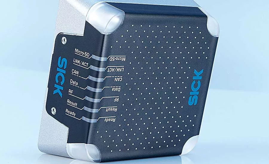

The RFU620 read-write device from SICK Inc. is optimized for applications in which UHF tags must be reliably identified at medium ranges and in close physical proximity to one another. Photo courtesy SICK Inc.

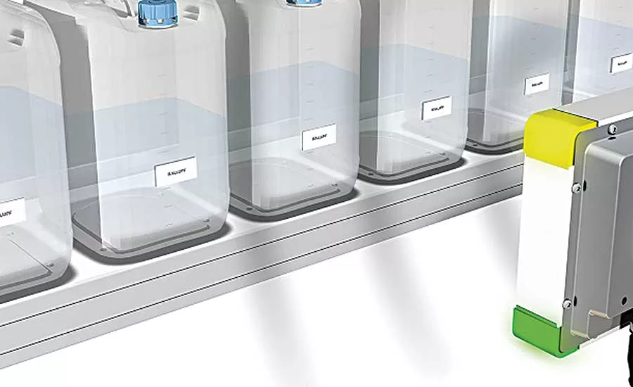

The compact BIS VU-320 write-read head from Balluff Inc. has function and status LED indicators that can be easily seen from any direction. With a typical reading range of 1 meter, the UHF system is especially suited for use in assembly plants. Photo courtesy Balluff Inc.
