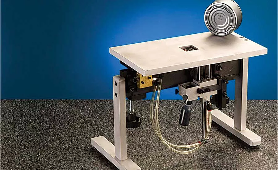

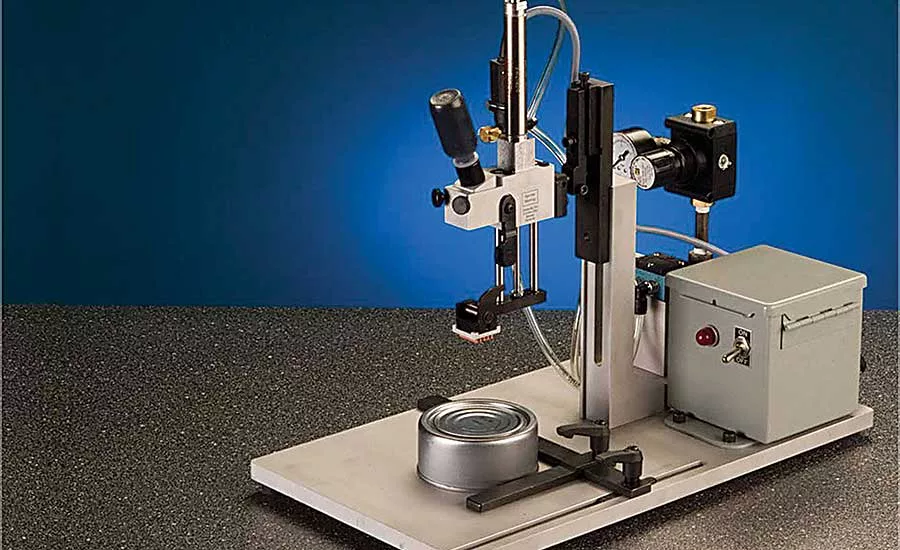

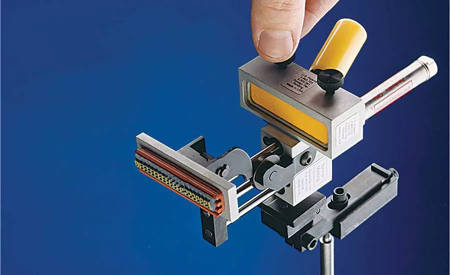

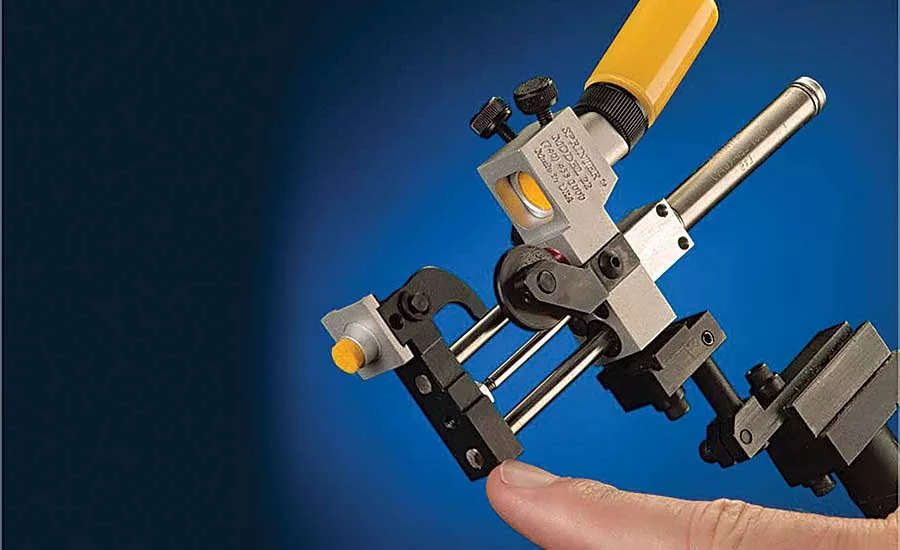

With wet-ink reciprocating coders, ink is stored in a reservoir. The marking head first contacts the reservoir, then inverts and extends to contact the surface to be marked. The mark is produced with a rubber stamp. Marks can be alphanumeric text or symbols, such as circles or arrows.

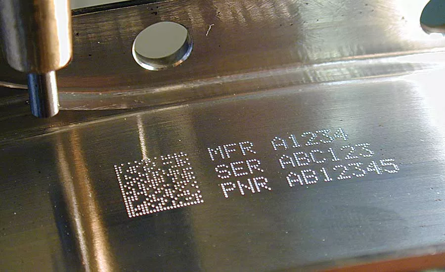

In dot-peen marking, a pointed tip of hardened metal is driven (pneumatically or electrically) into the
substrate to leave a message composed of small indents. Critical to visibility is shape, depth, spacing and size of the indents.

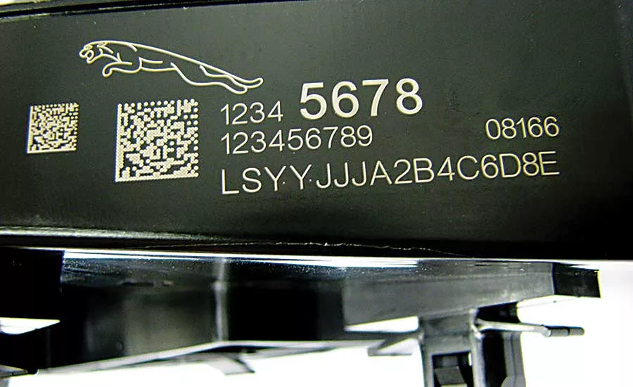

The most versatile—but also the most expensive—marking technology is a laser. With this technology, a high-energy beam of light is focused on the part and the message is ablated or burned into the surface. In some circumstances, the surface material is oxidized, leaving a dark impression. Or, the laser can be used to remove a coating to leave an image below.
Several types of laser can be used to mark parts, including CO2, fiber, UV and YAG. Power can range from a few watts to several hundred watts. Higher wattage can allow quicker message impressions or deeper
impressions in harder-to-etch materials. Each laser is steered by mirrors mounted on motors to produce marks quickly. The laser beam is focused through a lens to concentrate the energy for burning an image.

In the medium range (50 to 300 characters per minute), reciprocating coders come in to play. In these applications, the product must usually be stationary during marking. These types of machines can typically be used in processes up to 200 characters per minute.
