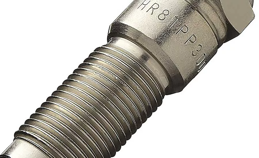

Manufacturers like dot-peening because it quickly produces error-free bar codes, logos, alphanumeric characters and 2D matrix codes of various sizes and depths. Photo courtesy Kwik Mark Inc.

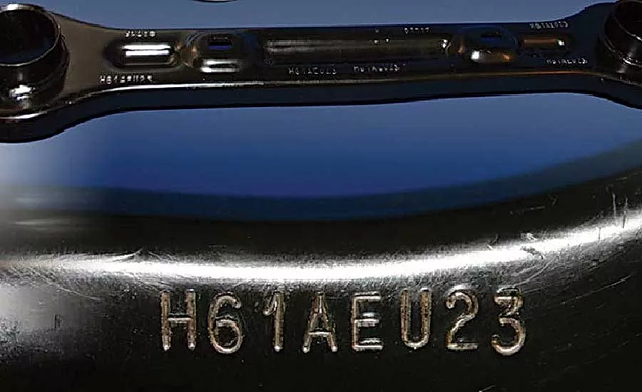

Air impact markers use mass and air pressure to quickly hammer a small die into metal. According to Krembel, these markers have a cycle time of less than 1 second, cost much less than dot-peen and laser systems, offer high repeatability and are versatile enough to integrate into full assembly lines or turnkey workstations. Air-over-oil and hydraulic impact markers are also available, although the latter can cost as much as $10,000, compared to about $3,000 for an air-powered unit.
The Slide-A-Mark 751 series of air impact markers from CMT offer telescoping action with part preloading. They can mark up to 20 0.125-inch characters in 0.5 second. The units are often used for marking part numbers, serial numbers and date codes.
These units are also able to mark on the facing or reverse side of the part. Other similar units are available to operate when submerged in water. Stroke length is up to 10 inches. The connecting PLC receives a DC signal when the marking process is complete.

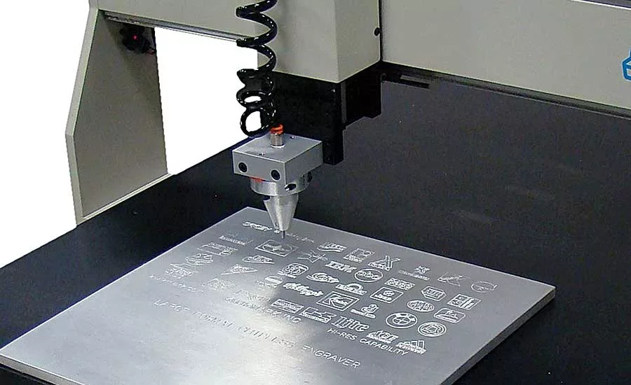

In dot-peening, a hardened-carbide or diamond-tipped stylus lightly but rapidly impacts the part and leaves a series of individual dots that are spaced tightly enough together to appear as a solid line. Manufacturers like the method, because it quickly produces error-free bar codes, logos, alphanumeric characters and 2D matrix codes of various sizes and depths.
“One of dot-peening’s main advantages is that it engraves metal without removing it or creating chips,” notes Cindric. “The stylus moves so fast, up to 200 times per second, that it produces a controlled-depth microimpact on the metal with no loss of strength.”
Because the stylus’ long stroke is very forgiving of part thicknes and surface variations, it ends up ‘floating’ on the surface being marked, according to Cindric. This capability allows round parts to be marked as if they were flat.
Cindric says that his customers use dot-peening on most metals, including aluminum, brass, steel and stainless steel. The process uses no cutting tools that heat up and wear, making it ideal for marking materials with a hardness of HRC 60 to 62. Dot-peening can also mark through most surface coatings or films, and is well-suited for use with conveyors, rotary dials and robots on automated production lines.
On the downside, dot-peened 2D matrix codes are sometimes low contrast. This can result in reading problems down the line, unless good contrast can be created in the images with correct illumination.
Last year, Kwik Mark introduced its streamlined X Series dot-peen marker with six axes of motion control and a retractable cantilevered marking head. The marker is ideal for marking operations of any volume, and its head provides a clear sight line by retracting and passing over tooling and equipment. Key construction components include twin rigid upright column leadscrews, ball slides, brushless servomotors, noncontact home sensors and a large T-slot table for fixturing. The marker comes with a programmable Z axis (to full column height) and requires neither a PC nor a control box to work.
Also available from Kwik Mark is the Micro Mark dot-peen machine. It can be trigger-activated in handheld applications or button-activated when integrated into assembly lines. The unit has a small footprint (3 by 5 by 6 inches) and is lightweight (5 pounds), but provides a 1-by-2.5-inch marking area that’s suitable for most applications. All text (single or multiple lines) and graphics are automatically centered during marking, whether in the X, Y or both axes. This capability ensures accurate marking of round parts such as pipes.
All Kwik Mark products have the iTeach function, which lets the operator use the marking tip as a pointer to accurately mark text on a radius, an angle, within a defined area or in several defined locations. For radius text, the operator touches any three points along an arc or hole, and then the machine automatically figures out the radius, and starting and ending angles, before placing the text on this radius.

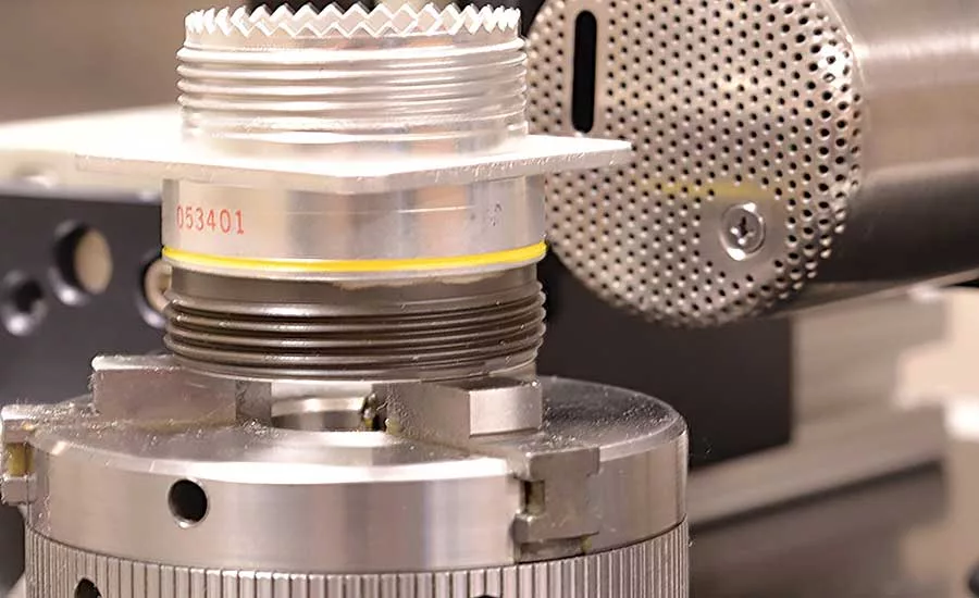

Surface marking involves directly applying ink to the metal rather than removing any of the surface material. The ink can be applied in one of several ways.
For parts that require a simple dot, a refillable, felt-tip marker mounted to a pneumatic cylinder may suffice. When multiple small dots are needed, they can be applied with a pneumatic spray valve.
A pad printer is ideal for contoured, textured and complex markings on stainless steel, and bare, anodized, painted or powder-coated metal. This method involves etching an image into a cliché plate, flooding it with a solvent-based ink and scraping off the excess. A silicone pad is pressed onto the plate and then the part. The ink comes off the pad and sticks to the part’s surface.
For serial marking applications, a continuous ink-jet system is necessary. Within the system’s printhead, a fine jet of pressurized ink is broken up into a stream of separate drops having an electrostatic charge. The flight direction of each drop varies with the size of the charge. Ink drops not required for printing are not given electrostatic charges and are collected in a gutter for recycling.
“Ink printing is usually not as permanent as engraving, but a wide range of inks are specifically formulated to last longer on metal by resisting solvents and caustic chemicals,” explains John Folkers, chief technical officer of the R&D group at Videojet Technologies. “Durable red, blue and white inks provide high contrast for codes and other markings. In addition, ink-based marking systems easily integrate into production lines and pose few safety concerns for workers.”
The 1710 continuous ink-jet printer from Videojet is designed for applications that require easily readable variable data on dark surfaces. The printer uses pigmented inks to create high contrast, clean codes on many common and difficult-to-mark materials in aerospace manufacturing, such as coated and bare metals. Folkers says Videojet recommends a black opaque or white ink be used with the printer for marking metal parts due to the ink’s excellent adhesion and lightfastness. The white ink contains heavy pigments and provides high contrast on parts like brake pads.
