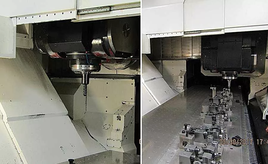

Hansen Engineering Co. operates 14 CNC machines that cut titanium, stainless steel and aluminum at a high speed (10,000 to 15,000 rpm) to produce many types of aerospace parts. Photo courtesy JM Performance Products Inc.

The 55-year-old company is an approved ATA (Air Transport Association) supplier of CNC-machined multi-axis parts, assemblies and major structural assemblies. Its manufacturing facility includes two buildings that operate 14 CNC machines, including Mazak five-axis machining centers (one with a dual shuttle table), horizontal machining centers with dual tombstones, and three-axis machining centers.
All of these machines cut titanium, stainless steel and aluminum at a high speed (10,000 to 15,000 rpm) to produce many types of aerospace parts. Despite being state-of-the-art, however, the equipment is susceptible to V-flange-toolholder expansion, due to heavy-duty daily

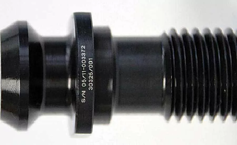

To prevent expansion, HEC replaced the toolholders’ standard retention knobs with high-torque retention knobs made by JM Performance Products Inc. The latter are longer and feature a relief below the flange that forces threads into a thicker material cross-section in the toolholder to ensure nearly 100 percent spindle contact and no expansion. A precision pilot further increases rigidity.
Made from hot-rolled steel (8620H, 9310H or H13), the knobs are shot peened to relieve stress, hard turned to ensure precision fit and balanced with threads that are 180 degrees from each other. They also meet all five world standards for knobs: ANSI, JMTBA, ISO or DIN, and JIS.
