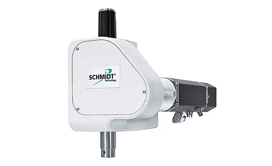

The ElectricPress is powered by a servomotor, but the ram is driven by a rack-and-pinion system rather than a ballscrew or a planetary roller screw. Photo courtesy Schmidt Technology

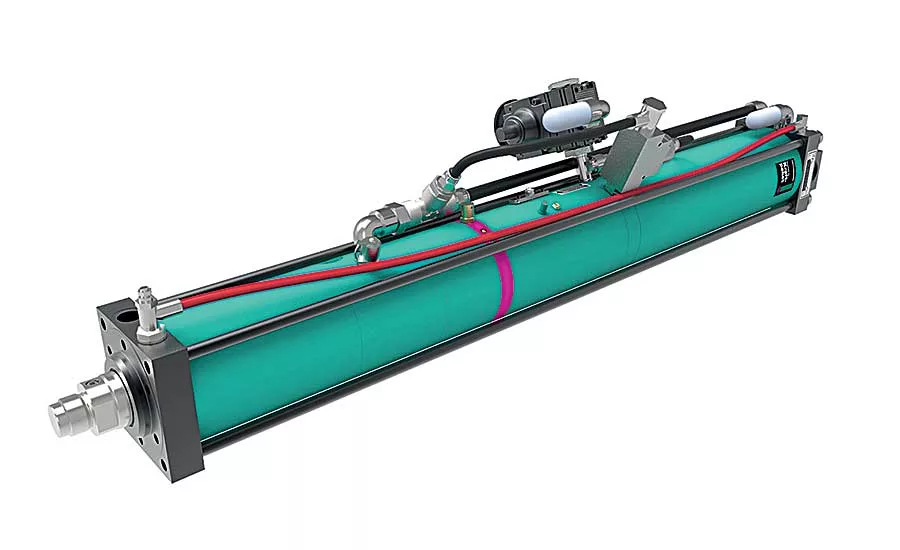

TOX has recently updated its X series of hydropneumatic cylinders (with pneumatic spring for the return stroke) to increase performance and decrease maintenance costs. Photo courtesy TOX Pressotechnik

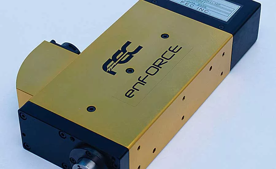

The Mini Series servo press is designed for low-force applications where complete process control and data collection is required. Photo courtesy FEC Inc.

That was the genesis behind Schmidt’s ElectricPress system. The ElectricPress is powered by a servomotor, but the ram is driven by a rack-and-pinion system rather than a ballscrew or a planetary roller screw.
“The rack-and-pinion drive system is much more cost-effective,” says Zabrosky. “You can still control position, speed and force. The difference is positioning capability. The ElectricPress requires a slight preload to ensure the gears mesh together, but it can achieve a positioning accuracy of ±0.001 inch. For a lot of applications, that type of accuracy is more than enough.”
The ElectricPress is available in two models, the largest of which has a capacity of 10 kilonewtons. “The ElectricPress fills a gap in the marketplace,” says Zabrosky. “There are a lot of precision systems out there, but you will pay for it. The ElectricPress is half the cost of a servo press.”
