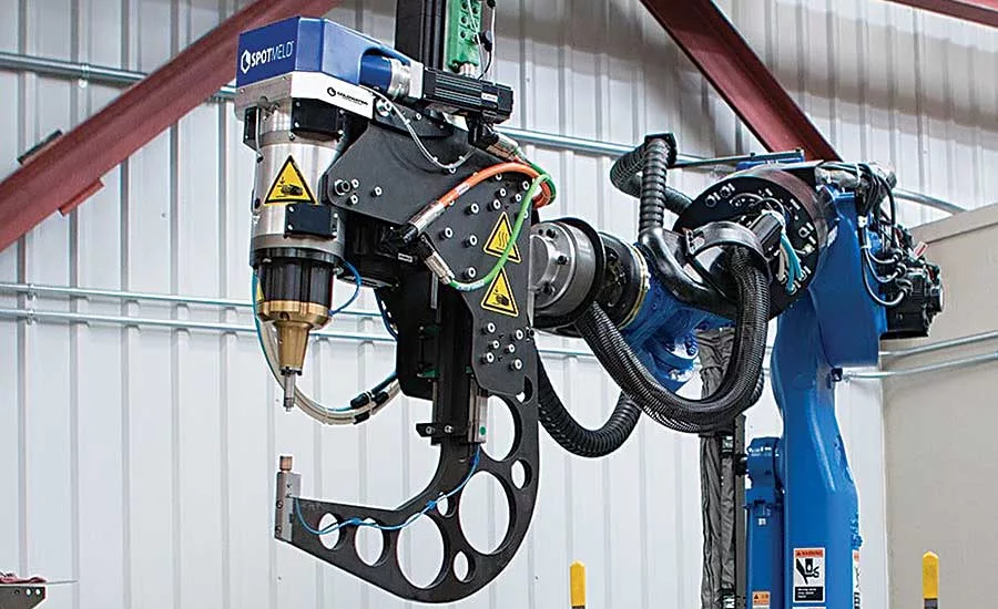

The SpotMeld system is compatible with various types of robots and CNC machines. Photo courtesy Coldwater Machine Co.

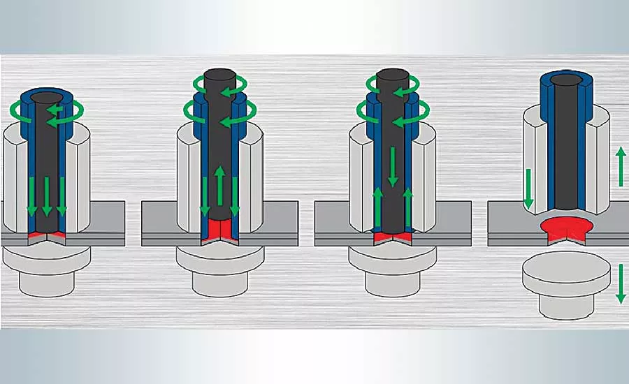

Aerospace companies are interested in refill friction stir spot welding because it eliminates the tool exit hole in joints. Graphic courtesy Coldwater Machine Co.

Aerospace companies are equally interested in refill friction stir spot welding (RFSSW) because it eliminates the tool exit hole in joints. Boeing and GKN Aerospace, for example, are working closely with EWI in a project overseen by the LIFT Consortium called “Processing and Properties Database for Refill Friction Stir Spot Welding of Aerospace Materials.” Equipment designer and integrator Coldwater Machine Co. is also participating.
Begun in April 2017, the project will validate and further develop RFSSW using aerospace titanium and aluminum alloys. Conventional FSW has been performed with titanium using refractory metals, but, there is no literature related to performing RFSSW with titanium alloys.
As for aluminum, much RFSSW work has been done with AA 2000, 5000 and 6000 alloys. This project will include welding hard metals such as Ti-64, aluminum-lithium and 7000 series aluminum. Coldwater’s robot-mounted SpotMeld system is being used to weld 1000 to 7000 series aluminum, and document the data to improve process control.

SpotMeld is used by manufacturers in various industries to join aluminum, magnesium, nonferrous and dissimilar material sheets of varying thicknesses. The system is compatible with various brands of robots (including Fanuc, KUKA and ABB) and CNC machines. It is easy to fixture, energy efficient, and offers automated tool changeover. Welding programs can be called up on demand via the robot controller.
