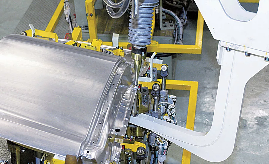

To prevent denting the materials during FSSW, support is needed on the back side of the joint. Photo courtesy Mazda Motor Corp.

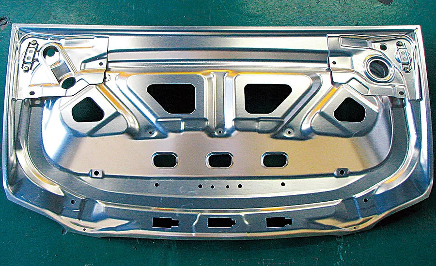

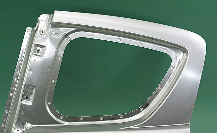

Also known as friction stir spot joining, FSSW has been around since 2003. The process was developed by Mazda Motor Corp. and Kawasaki Heavy Industries to assemble the aluminum hood and rear doors of the RX-8 sports car. Since then, FSSW has been used by Toyota Motor Corp., General Motors Co., Ford Motor Co., Fiat Chrysler Automobiles and PSA Peugeot Citroen. The technology is also getting interest from manufacturers of airplanes, appliances, trucks, trains, off-road equipment and even consumer electronics.

Next, the tool is pushed against the surface of the top sheet. Depending on the application, the axial load applied to the sheets can range from 1,470 to 5,880 newtons. (To prevent denting the materials, support is needed on the back side of the joint. This can be provided by a C-frame, a backing bar or a fixture.)

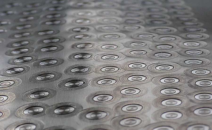

The top side of the joint has a circular indentation with a small ring-shaped projection along its outer edge. The back surface is unblemished.
For many applications, that bump or crater on the top surface doesn’t matter. But, it is an issue if aesthetics or aerodynamics is important, and that’s what led to the development of refill FSSW.

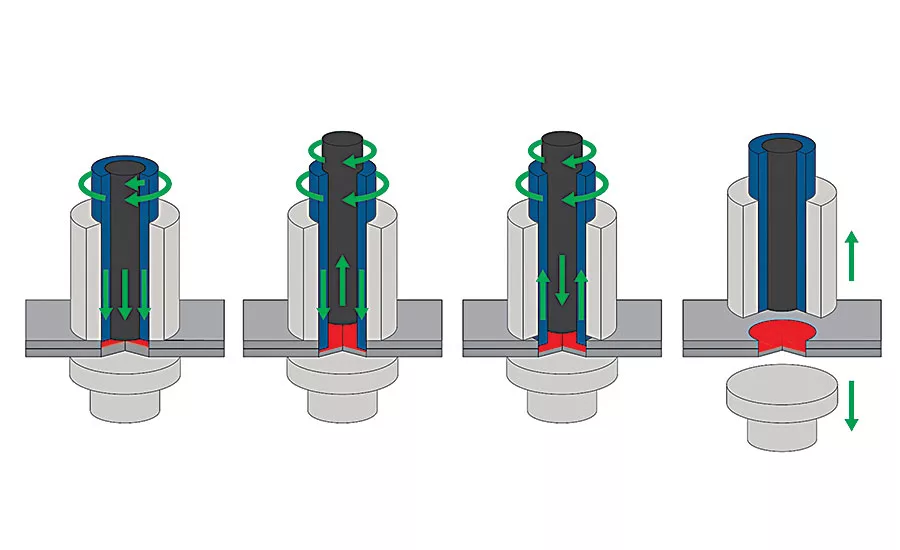

Instead of a single rotating tool, refill FSSW employs a three-piece tool. There’s still a rotating pin, but it is surrounded by a sleeve, which rotates in the same direction and speed as the pin, and a clamp ring, which does not rotate.
At the start of the process, all three tools apply downward force to the sheets, explains Mike Spodar, senior welding engineer at Coldwater Machine Co. The pin and sleeve heat the material and begin to penetrate the top sheet. Next, the pin retracts slightly, while the sleeve continues downward into the bottom sheet. At a preset distance, the sleeve reverses direction and the pin moves down again. When both the sleeve and pin are flush with the work surface, rotation stops and the tool is held in place to allow the joint to cool.
Although the joints created by refill FSSW are not any stronger than those created by the standard process, they are more aesthetic. “The process produces a flat, smooth surface across the top of the sheet. There’s very little marking on the bottom side of the joint, and on the face side of the joint, where the tools were, there are concentric rings,” says Spodar.
The key variables are weld time, weld depth and tool speed. The sleeve can be extended up to 8 millimeters to allow welding of thick sheets or multiple sheets. “The sleeve just needs to get into the bottom component,” says Spodar. “It does not need to penetrate a lot. Typically, we need to get 0.2 to 0.3 millimeter into the bottom material.”
Because of the extra step, refill FSSW is slightly slower than the standard process. “It takes about 1 second of travel per millimeter of thickness, but we can move faster than that,” says Spodar. “For a 1 millimeter thick part, it would be 0.5 to 0.8 second down and another 0.5 second up.”

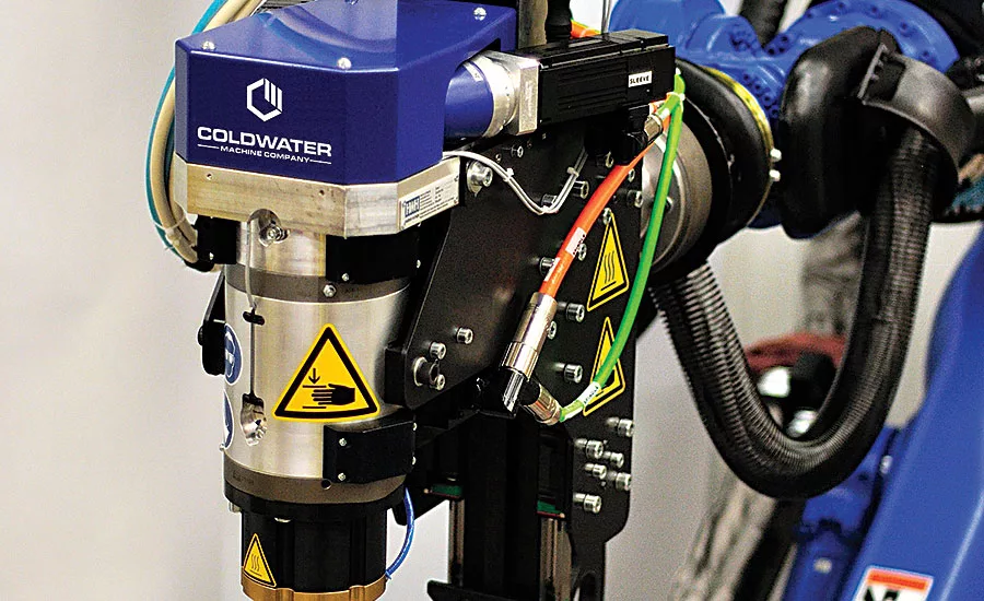

Both FSSW and refill FSSW can be performed with a stand-alone pedestal machine, or they can be integrated with a three-axis gantry robot or a six-axis articulated robot. Either way, engineers should ensure to provide enough access above and around the joint for the tooling.

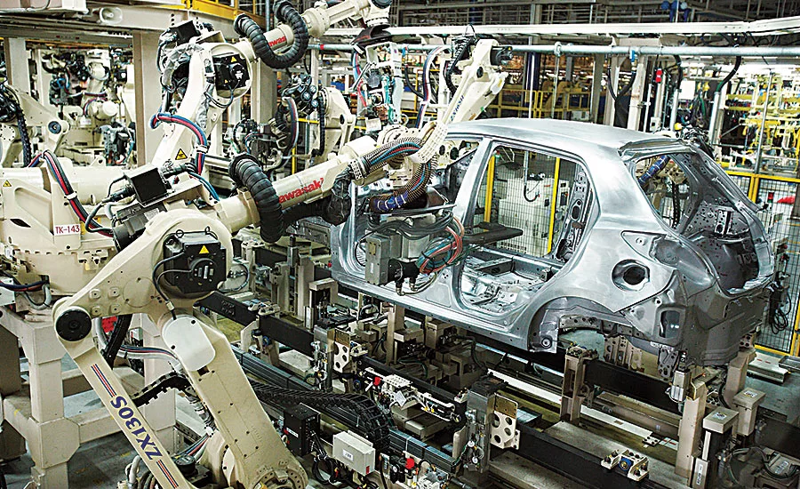

While the automotive industry has been the early adopter of FSSW, the aerospace industry is catching up. For example, Kawasaki’s aerospace division has used FSSW to assemble cockpit doors for helicopters. And, manufacturers of commercial jets are looking at the technology as a way to replace rivets for attaching aluminum skin to stringers and frames. Considering that a jetliner contains millions of rivets, the potential for cost and weight savings with FSSW is enormous.
To accomplish that goal, Kawasaki has developed a unique two-robot system for assembling large aerospace assemblies. One six-axis robot is equipped with the welding tool, while the other, working on the opposite side of the assembly, is equipped with a backing bar to support the back side of the joint. The two robots work precisely in concert, moving from one joint to the next. For extra rigidity, two of the six axes on each robot are not rotary axes, but linear ones driven by a ballscrew.
“These robots can support more than a ton of axial force,” says Patel. “There are very rigid.”
