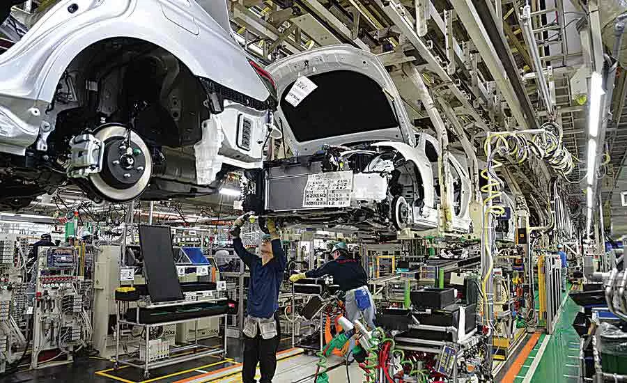

Manufacturing environments where continuous improvement thrives don’t magically happen overnight. Photo courtesy Toyota Motor Corp.

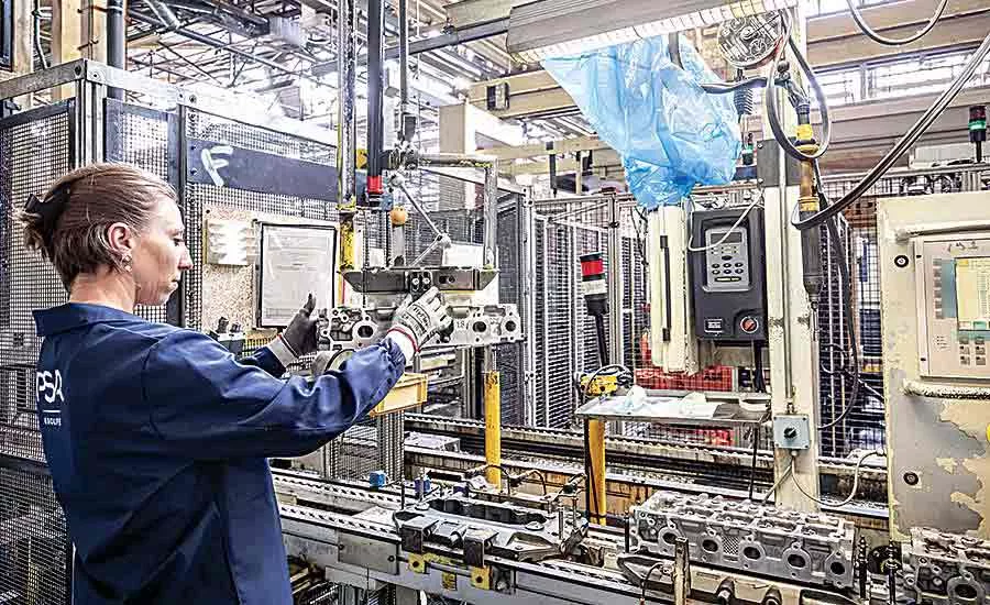

Manufacturers are starting to focus more attention on sustaining lean cultures. Photo courtesy PSA Groupe

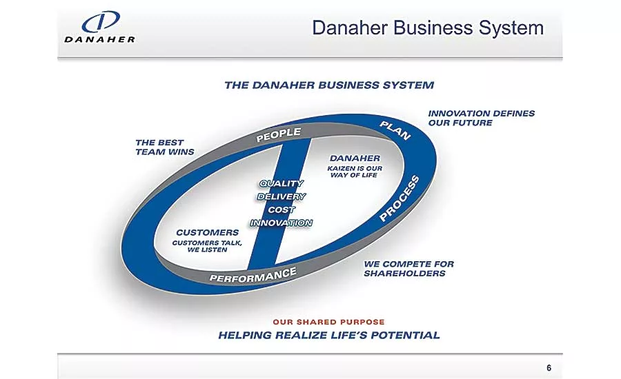

Lean culture is a cyclical process that permeates through all parts of an organization. Illustration courtesy Danaher

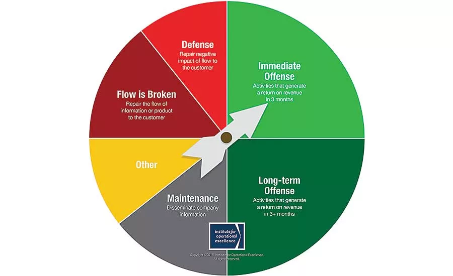

Meetings that focus on the right side of this pie chart are a good indicator that a lean culture is effective. Illustration courtesy Institute for Operational Excellence

“A lean culture understands how flow and value streams work,” says Kevin Duggan, founder of the Institute for Operational Excellence. “When there are problems, that culture can resume without the need of management interaction.
“A great analogy is commercial airline pilots,” notes Duggan. “Designing an airplane to fly is like designing the value streams needed to deliver products. Culture occurs with the pilots sitting in the cockpit. Every few hours, a different pair of pilots is tasked with flying the plane from point A to point B.
“If a red light goes off in the cockpit, the pilots don’t call for help and say ‘there’s a problem; we need to have a meeting,’” adds Duggan. “Pilots have standard work instructions and a checklist for when things break down. They know what’s normal and what’s abnormal, and what to do about it.
“The same premise applies to a lean culture in a manufacturing setting,” claims Duggan. “The goal is to have a culture that provides seamless delivery to the customer every day without the need for management intervention.”
