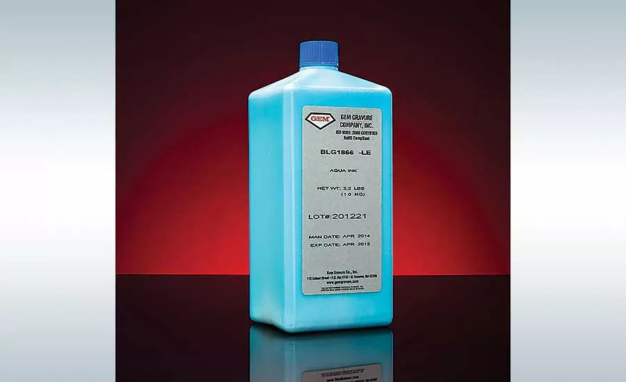

BLG1866 is a light aqua, heavy-pigmented ink for continuous ink-jet printers. It’s recommended when assemblers need to print on both light- and dark-colored surfaces without an ink change. Photo courtesy Gem Gravure Co. Inc.

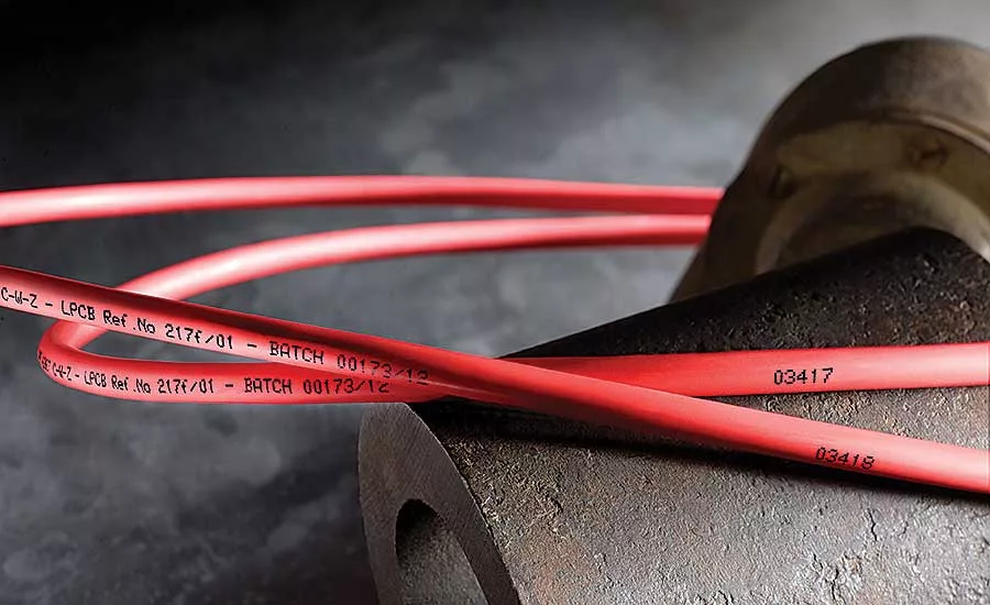

Ink-jet printers can mark wire with alphanumeric text, serial numbers, symbols, patterns and bar codes. Depending on the size of the wire, ink-jet printers can print multiple lines of text or even Data Matrix codes, simple graphics and logos. It’s also possible to print on uneven surfaces, such as twisted wire.

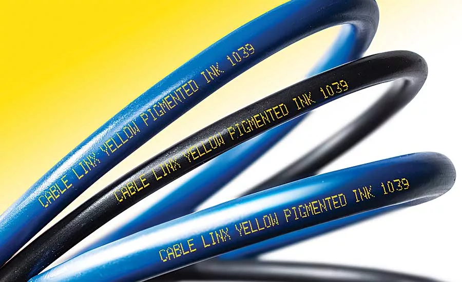

A wide range of inks is available to use with ink-jet printers. The most common inks consist of a dye or pigment dissolved in a solvent, such as methylethylketone (MEK) or alcohol. The former can pose a health concern, but the latter takes longer to dry.
“Pigmented inks have particles in them that provide color and opacity,” says Hyde. “They will cover up whatever they’re sitting on. Dye-based ink can let the substrate show through. Dye-based inks are easier to run. The color stays suspended. With pigmented inks, the color particles can settle.”
The most common and economical ink for marking wire is black, dye-based ink. It’s inexpensive and less prone to clogging. For printing on dark substrates, pigment-based inks are available in contrasting colors, such as white or light blue.
UV-curing inks are another option for printing on wire. These inks don’t rely on solvent evaporation for curing. Rather, they cure instantly when exposed to UV light. “When these inks are exposed to UV light, they cross-link with the substrate. At that point, they’re impervious to just about anything. You can expose it to solvents or gasoline and the ink won’t come off the substrate,” explains Hyde.

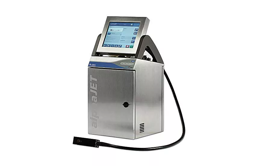

The alphaJET ink-jet printers can accommodate both pigmented and dye-based inks. All but one of LC Electronic’s printers is supplied with black ink. The one exception runs white ink, which provides better contrast on dark-colored insulation. The printers accept 1-liter bottles of ink and solvent. An integrated solvent recovery system conserves materials and minimizes odors. Compressed air is not required for printing.
The alphaJET can print multiple lines of text, depending on the font size and the cable thickness. Text height ranges from 0.8 to 15 millimeters. The machine can also print logos, bar codes and Data Matrix codes. Maximum print speed is 460 meters per minute. The printer can automatically generate serial numbers and time and date codes. Integrated distance measurement ensures accurate placement of text and graphics on the wire.
The printer has a stainless steel housing and carries an IP 65 protection rating. The printer is equipped with USB, Ethernet and RS-232 ports, as well as a digital I/O port with eight inputs und four outputs.
