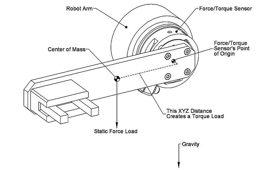

Calculating the Loads
The torque is the force (comprised of the static, dynamic, and working forces) multiplied by the distance from the sensor origin to the point at which the force is applied. It is important to also consider overload conditions beyond the normal operating forces and torques the sensor will experience.
Sensor loading will vary with the orientation of the tooling relative to gravity and the acceleration or deceleration during robot movements. Anticipating the maximum inertial load caused by the robot’s movement may be important to understanding the maximum load presented to the sensor.

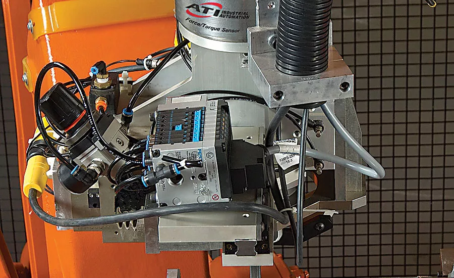

ATI’s Force/Torque Sensor is mounted to the wrist of an ABB industrial robot, providing feedback that gives the robot a sense of touch just as a human would. This allows the robot to make quick adjustments in real-time to search for the correct assembly position as a piston is inserted into the cylinder of an engine block. ATI’s Force/Torque Sensors make it possible to automate difficult assembly tasks which were previously performed manually or required complex assembly machines.
