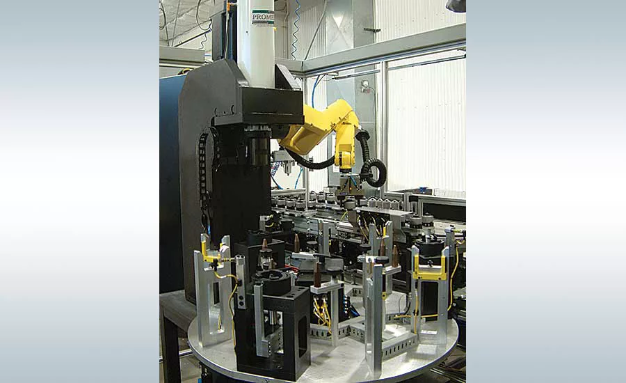

Recently, ESE Automation integrated a 60-kilonewton EMAP servo press from Promess with a six-axis robot in a workcell where resilient bushings are pressed into automotive control arms. Nausley says the midsize robot transfers each arm to the press, which presses one bushing into the arm at a preprogrammed position.
Bushing installation is verified with Promess’ built-in force and position monitoring. After the bushing is installed, the robot places the arm on a short belt conveyor to transfer the arm to another station for further processing. This integrated workcell replaces a previous setup where the arm was manually loaded, unloaded and placed on the conveyor.

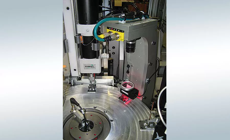

“High-volume and high-cycle applications are the ones that are generally assumed to be the best for press integration,” explains Dave Zabrosky, sales manager at Schmidt Technology Corp. “But, low-volume and high-cycle applications benefit as well from press integration. This type of end-user has a high product mix and needs to process, say, only 100 to 500 units of a specific part per week, but quickly, so it can get on to the next type of part. Applications that require small-parts handling can also benefit from press integration, especially those involving tiny items that can’t be properly oriented by hand quickly.”
Earlier this year, Zabrosky worked with a material-handling integrator to redesign an automation setup for a Schmidt electronics manufacturer customer. The company and integrator jointly decided that three pneumatic presses were necessary to produce different parts for a din rail cutting machine. But, Zabrosky showed both parties that a single direct-acting air press could be just as effective with three sets of proper tooling—and an automated shuttle element that accurately orients and feed parts to the press.
