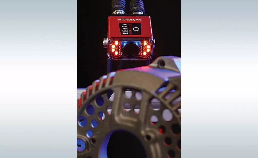

Machine vision technology is used by automakers and suppliers for a variety of applications, including error-proofing and inline inspection. Photo courtesy Ford Motor Co.

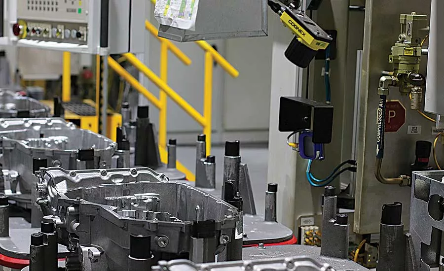

Because of their compact size, smart cameras can enhance the flexibility of traceability applications. Photo courtesy Omron Automation Americas

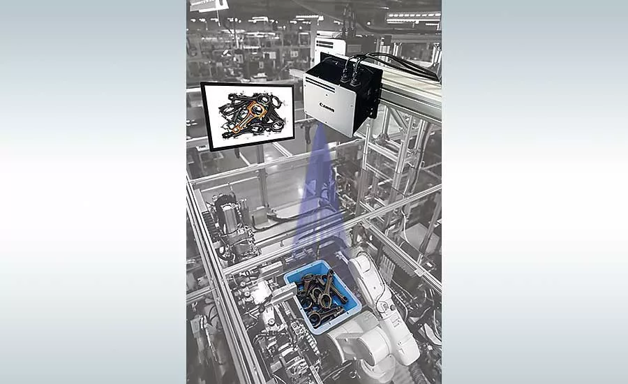

Bin picking is a challenging application that can benefit from advanced vision systems technology. Photo courtesy Canon USA Inc.

Bin picking is another challenging application that can benefit from 3D vision systems.
“A 2D camera is unreliable in bin picking, because  its accuracy is affected by changes in ambient lighting and there are problems detecting low-contrast or reflective objects,” claims Jason Niu, marketing manager at Bluewrist Inc., which has developed a hardware agnostic bin-picking system. FlexiPick enables a robot to pick up parts randomly placed in a bin and present them to an assembly line.
“As the bin becomes empty, 2D vision systems have difficulty maintaining reliability and accuracy that may lead to collisions,” explains Niu. “However, demand for vision systems is complex, because manufacturers need one type of product that can serve different car models, vehicle platforms and multiple variations.
“In the past, due to the large amount of data that 3D sensors generate, it was not always feasible to apply the technology to inline inspection processes, because it would slow down the entire assembly line,” notes Niu. “Applications that involved shiny metallic surfaces were not possible.
“Today, things have changed,” Niu points out. “Sensor accuracy and speed have improved, enabling them to keep up with the cycle time requirements of the auto industry.”

Canon developed its RV series of image sensors specifically for robotic bin picking. Products range from the RV300 to the RV1100.
“They are capable of high-speed, high-accuracy three-dimensional recognition of objects,” says Grant Zahorsky, machine vision engineer at Canon USA Inc. “The system is applicable for parts with curved surfaces, parts with few distinguishing features and even parts with more complex shapes.
“[Our product] projects recognition patterns onto randomly piled parts and analyzes the projected images,” explains Zahorsky. “Based on the analysis of the differences between images of the parts and the multiple projected patterns, the system is able to recognize targeted objects in three dimensions.”
