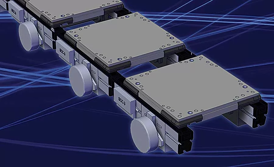

Vendors are now developing conveyors that incorporate Industry 4.0 technology. Photo courtesy Bosch Rexroth Corp.

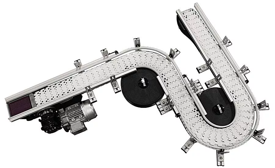

Improvements in motors, belts and gearboxes are making conveyors more energy efficient. Photo courtesy Montech Conveyors Corp.

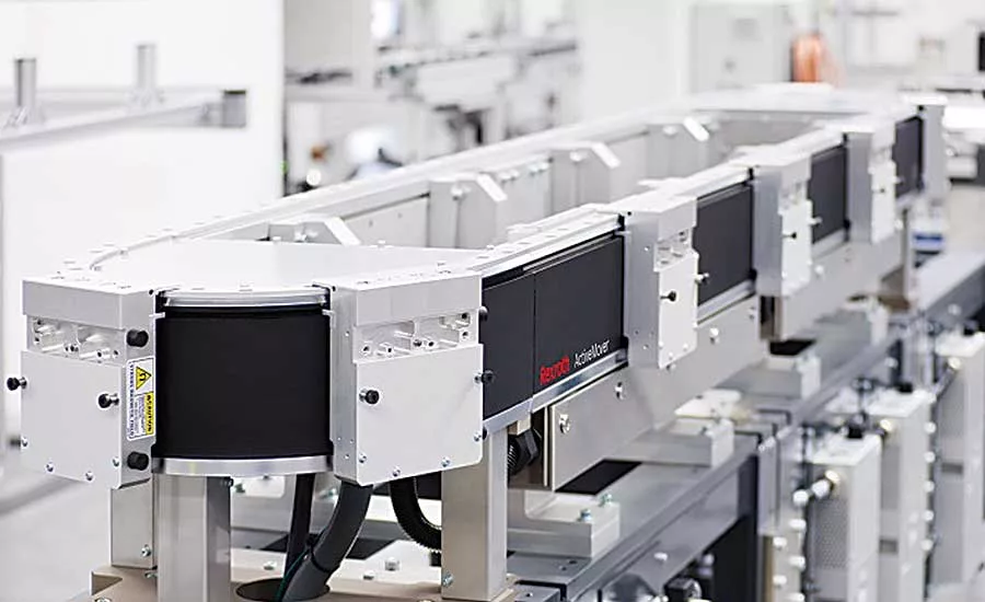

Today, conveyors play an important role in Industry 4.0 initiatives. Photo courtesy FlexLink Systems Inc.

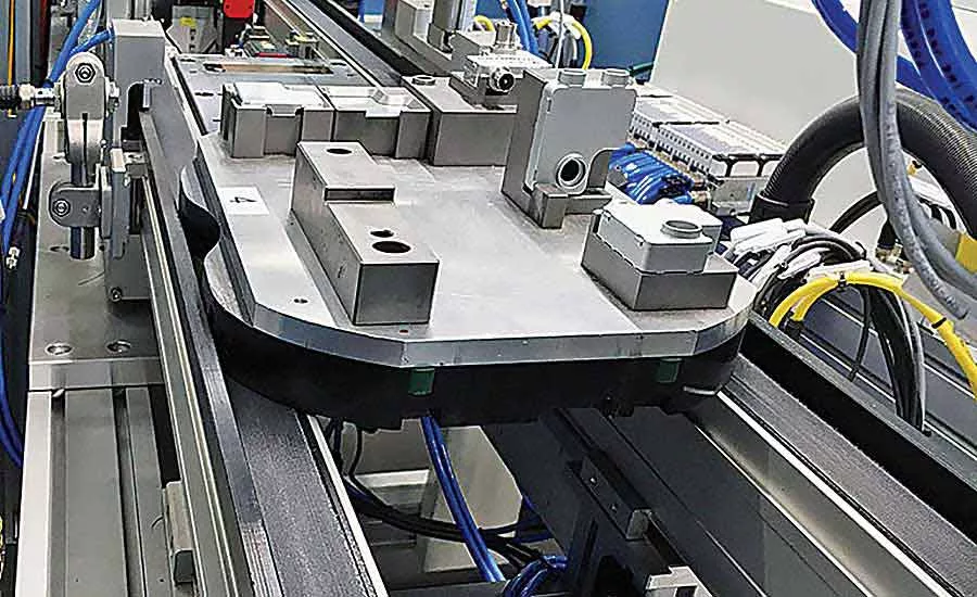

Flexible, mixed-model assembly lines are creating new roles for conveyors. Photo courtesy Dorner Manufacturing Corp.

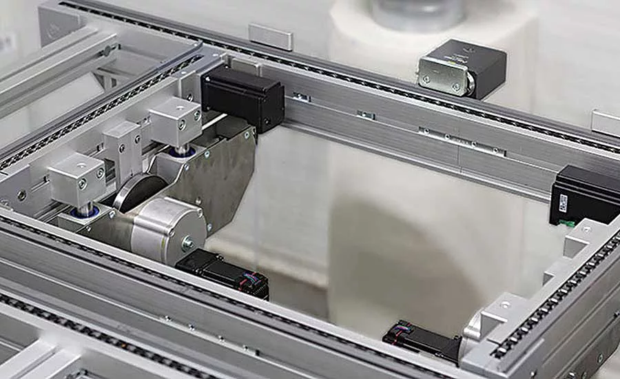

The new ZP conveyor eliminates the back-pressure caused by accumulation. Illustration courtesy Glide-Line

Dorner’s latest product update is the 2200 Series precision move pallet system, which is now available with several new features including heavy-load corners.
“This design allows the conveyor to carry pallet loads up to 70 pounds around 90- or 180-degree corners, effectively providing loop capacity for larger, heavier pallets,” says Johnson. “Additionally, pallets can be accumulated in the corner, an advantage not typically seen in most systems. Pallet widths have also been expanded to 640 by 640 millimeters to handle heavier loads.
“The new tight transfer 180-degreee corner creates a loop with only 135 millimeters between main run conveyors,” adds Johnson. “This cost-effective option eliminates the need for other transfer devices, while maintaining pallet orientation through the loop.”
Bosch Rexroth is in the process of rolling out a new series of Industry 4.0 products dubbed ActiveSuite. Included in this offering is a new conveyor called ActiveMover.
“ActiveMover is a linear-motor based conveyor system,” says Dinges. “Compared to classical pallet-based conveyor systems, [what makes it unique is its] speed (up to 150 meters per minute), acceleration (up to 4g), precision (±0.01 millimeter) and reversing capability. It’s also designed for asynchronous and synchronous operation.”
Montech AG recently opened Montech Conveyors Corp., a new office and assembly facility in Huntersville, NC, to serve U.S. customers of its modular belt conveyor systems.
According to Gianluca Aloisi, director of sales, Montech’s products now feature new and improved 24-volt motors, belts and gearboxes that make the conveyors more energy efficient. “We’ve done a lot of research to develop the best combination possible,” he explains. “For instance, our motors now use four times less electricity than they did 10 years ago.
“Our focus is on energy consumption and ease of use,” says Aloisi. “The motors for our TB30 and TB40 belt conveyors, and the LT40 transfer system, feature energy-efficient drives. They not only meet the new European Union IE3 efficiency standards, but they are significantly better than the IE4 standard that is planned for the future.”
MagneMotion’s newest product is the MagneMover LITE, which is designed for assembly applications under 10 kilograms. “It’s based on independent cart technology, which enables completely independent control of conveyed items unlike traditional belts, pallets, rollers and other positioning systems,” claims Bentley.
“MagneMover LITE excels at flexible, mixed-model assembly lines, as well as single-purpose high throughput lines,” Bentley points out. “It is a modular, easy-to-use intelligent conveyor system that’s used in a wide range of industries, such as automotive and electronics.
“The system seamlessly and easily handles thousands of independent carts across a complex conveyance network,” adds Bentley. “Each cart is continuously tracked and is controllable. Programming is destination based. Auto-queuing, anti-collision and route planning are done by the system.”
Glide-Line recently introduced the ZP zero-pressure accumulation conveyor for automated assembly. With traditional conveyors, there is often back-pressure from upstream pallets bumping into each other and stacking up. This can compromise product integrity and quality.
In addition, the drive motors run continuously, regardless of actual conveying requirements. This causes extra friction and unnecessary wear and tear on the entire system, including the bearings, belts and motors. It also wastes energy.
The new ZP conveyor eliminates the back-pressure caused by accumulation. With this conveyor, the drive motors only run when a product approaches. The conveyor automatically maintains a gap between products, so no back pressure is created.
Each accumulation zone is powered by a 24-volt brushless motor and can handle loads up to 200 pounds. The motors are daisy-chained to each another, and each motor has its own driver card.
