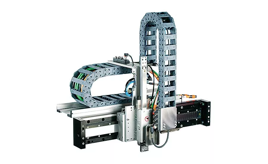

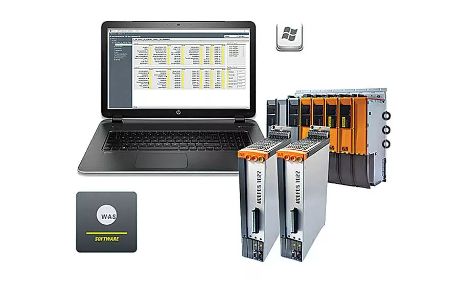

A servo drive with motor power and position feedback cables are included with any motor driven servo axis. Also included in the standard WEISS package is our WAS2 Programming Software and a powerful controller used for communication between the servo drive and the supervisory PLC. The controller, called X20, can communicate using any fieldbus option needed. The WAS2 software is available for all WEISS servo axis equipment and is included with the WEISS standard control package. Machine builders and end users alike can be sure that WEISS Control Hardware, including WAS2 software, will communicate with any brand Supervisory PLC using any preferred fieldbus interface.
WAS2 was designed by WEISS to be a user-friendly interface software application with drop down menus used to set up all of your system parameters for operation. All of the high-level values required to properly tune and operate a servo axis are automatically configured by using these drop down menus. WEISS sets up the hardware, configures each package and tests everything prior to shipment. When you receive your system, you simply need to set positions, speeds, sequences, etc. Any fieldbus interface can then be selected and used to bridge the gap between the WEISS Controller to the PLC of your choice.

  • Install on your PC and open the WAS2 programming and user interface software included with shipment. Once you open the software and link it with the control system, it will show you all of the default information that has WEISS pre-configured for the system ordered.
  • Select the fieldbus protocol of your choice.
  • Map your I/O, i.e., open/close gripper, and parameters/values, i.e., example positions/speed, to be communicated back and forth to your PLC. Note: these values can be read or written to by customer PLC.
  • Enter application specific load data using intuitive drop-down menus. Use WAS2 auto tune features to automatically adjust tuning parameters.
  • Set up I/O and motion sequences using graphical tools.
  • Establish communication between the PLC and X20 with single cable for protocol selected. Wire any digital I/O required.
  • Test motion sequences using manual mode.
  • Test communication and control with customer PLC interface.
  • Test full automation functionality. Use WAS2 monitoring features to verify desired results. WAS2 includes dedicated status windows with graphical displays and meters showing real time status and running conditions. Accuracy, velocity, run time, cycles, temperature, and others can all be monitored in real time. WAS2 software also allows for remote monitoring and diagnostics.
