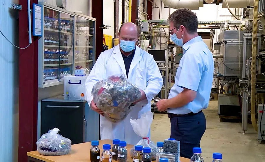

KARLSRUHE, Germany—Chemical recycling of mixed plastic waste is both technically feasible and environmentally and financially promising, according to new research from Audi and Karlsruhe Institute of Technology (KIT).
The researchers have invented a way to turn mixed plastic waste from automotive manufacturing into pyrolysis oil, which could replace petroleum as a raw material for the production of new plastic parts for cars. Together with partners from the chemical industry and KIT, Audi is now researching ways to industrialize the recycling process.
Many car parts are made of plastics, including fuel tanks, air bag covers or radiator grilles. These parts must meet stringent requirements for safety, heat resistance and quality. As a result, plastic parts that are subject to high levels of stress are typically made from “virgin” materials; mechanically recycled plastics usually cannot meet performance requirements. Additionally, mixed plastic waste is often not available for mechanical recycling.
To solve this problem, KIT and Audi launched a pilot project for chemical recycling in 2020. Tests were carried out to determine the extent to which mixed automotive plastic could be fed back into a resource-friendly cycle via chemical recycling.
The project was led by Dieter Stapf, Ph.D., of the KIT Institute of Technical Chemistry, and Rebekka Volk, Ph.D., of the KIT Institute of Industrial Management and Industrial Production. The researchers looked at the technical feasibility,  cost-effectiveness and environmental impact. The results show that chemical recycling can be used to process mixed plastic waste from automotive manufacturing into pyrolysis oil that, in turn, could be used to create new plastic with the same high quality as virgin materials.
Audi is one of the first automakers to test this recycling process. The next step is to determine if the process can be done at an industrial scale.
“An initial assessment shows that chemical recycling may be superior to energy recovery from both a financial and environmental perspective,” says Volk. “We are comparing this process with energy recovery [i.e., burning plastic waste for heat]. An initial comparison of the figures shows that the costs for chemical recycling are on par with…energy recovery.
“Furthermore, chemical recycling offers the opportunity to recycle much of the carbon and reuse it in the production of new plastic components. As a result, carbon dioxide emissions from chemical recycling are significantly lower than those from the energy recovery process, which benefits the climate.”
Complementing mechanical recycling, pyrolysis converts mixed waste plastics and composites into a liquid chemical feedstock while separating out unwanted constituents. After a purification step, this pyrolysis oil can be processed into new plastic using conventional industrial processes, thus replacing primary raw materials from fossil energy sources, such as petroleum.
