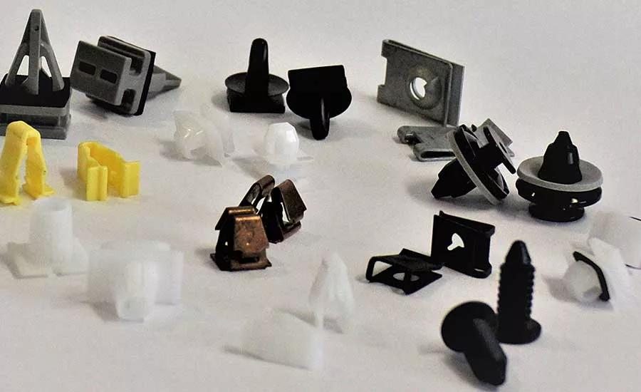

Many types of unthreaded fasteners are used in assemblies. They include expander plugs, plates, all kinds of pins, clips, wooden dowels, brazing rings, springs, scrivets, shaft retainers, push-on inserts and caps, and valve cores. Photo courtesy Dixon Automatic Tool Inc.

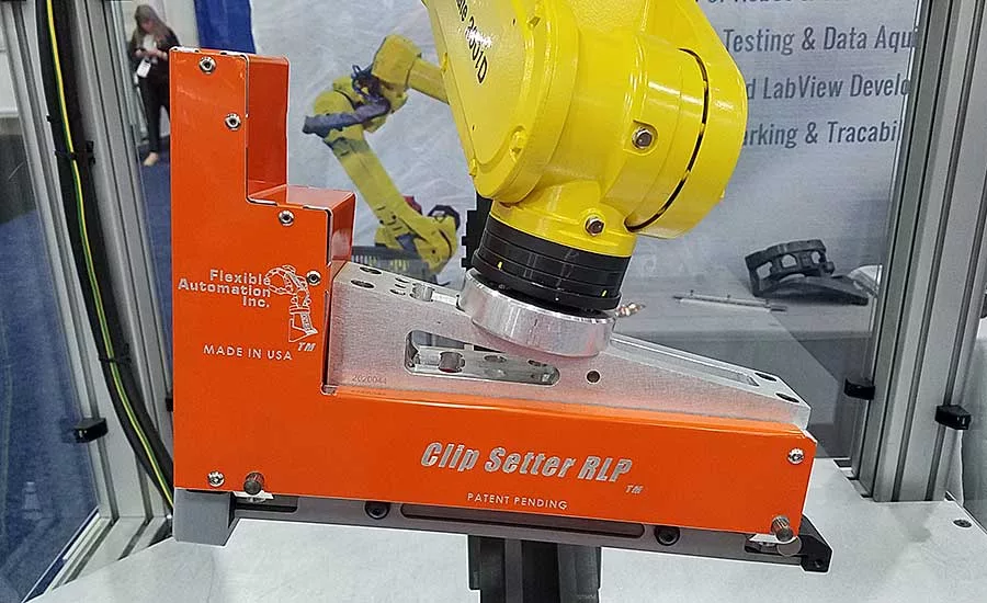

Robot mounted, the RLP Clip Setter uses a pneumatic cylinder to drive clips into position. Photo courtesy Flexible Automation Inc.

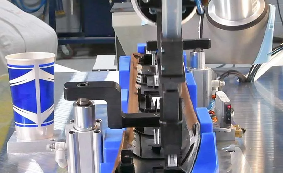

Nonthreaded plastic fasteners, like white clips, are often inserted into automotive parts, like this trim, before it is installed on a car. Photo courtesy Visumatic Industrial Products

The list of unthreaded fasteners manufacturers need to feed and install is extensive. It includes expander plugs, plates, all kinds of pins, clips, wooden dowels, blind and drive rivets, brazing rings, O-rings, springs, washers (round or square), bolts, scrivets, brass fittings, shaft retainers, push-on inserts and caps, hose clamps and valve cores.

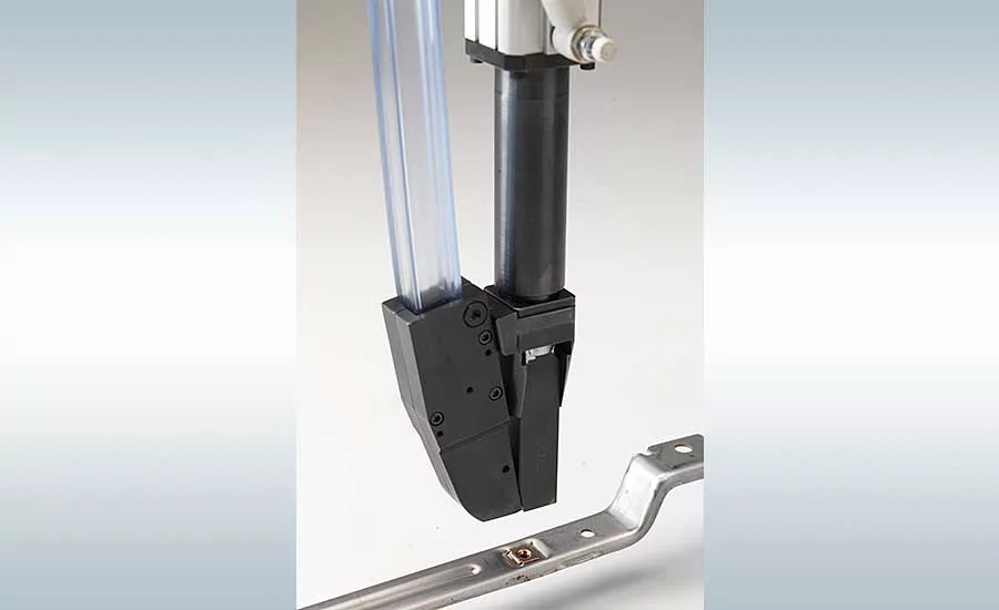

Also available from Dixon are stationary (LP) and robotic (RLP) blow-fed part placers. Compact and rugged, the units place metallic and plastic fasteners that have been vibratory bowl fed and conveyed through an air tube. Their placement jaws have a maximum pressing force of 333 newtons. Ram stroke is 100, 150 or 180 millimeters. The size of the accompanying vibratory feeder bowl is determined by fastener geometry.

Flexible Automation offers a series of end-of-arm robot tools for installing clips and other nonthreaded fasteners, such as mid-panel push-nuts, expansion nuts, edge-panel U-nuts and Christmas tree fasteners. The RLP Clip Setter is robot mounted (R), low capacity (L) and uses a pneumatic cylinder (P) to drive clips into position. Manufactured with lightweight aluminum components, the device weighs only 2.5 pounds.
“Many automakers use the RLP to effectively place clips on vehicle trim strips,” explains Osterholzer. “A common application is robot mounting the RLP, and having it dock at a loading area on a vibratory feeder. There some 30 plastic clips get loaded in the tool’s magazine within about 3 seconds. The robot then moves the tool over the receiving part and quickly installs the clips one at a time.”
The company’s RHS Clip Setter utilizes a servo actuator (S) and provides high capacity (H) installation. It is typically mounted on the end of a midsized six-axis robot, but can also be mounted on a fixed pedestal. Its high-duty-cycle linear motor actuator has integrated stroke and force sensing for optimum error-proofing.
