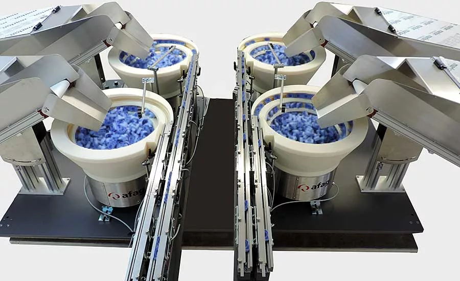

Afag Automation, a manufacturer of linear and rotary actuators, grippers and parts feeders, is playing its part. Recently, a machine builder contacted the company to design and build four vibratory bowl feeders for an automated system to assemble diagnostic test supplies. Given the nature of the pandemic, the bowls had to be delivered in a very short timeline. They also had to meet stringent testing requirements.
Less than three weeks after receiving the order, Afag delivered the feeders. To put that into perspective, such an order would typically take 10 to 12 weeks.
Specifically, Afag supplied four bowls made from medical-grade polyamide. The bowls are molded in a general shape and then milled to meet the feeding requirements of each specific part. Engineers design the bowls in CAD software. The CAD file is then turned into a numerical-control file for precise five-axis milling. Thus, if identical bowls are needed in the future, they can be reproduced quickly and inexpensively.
Blanks are available with outside diameters ranging from 105 to 630 millimeters and depths ranging from 27 to 193 millimeters. Volumes range from 0.07 to 15.3 liters. Bowls can be machined with a step helix, a groove helix or a radius helix.
The vibratory drive unit has a closed design and feeds parts quietly and reliably.
