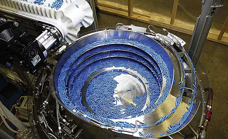

This vibratory bowl feeder supplies small plastic stems for earplugs at a rate of 200 parts per minute. Photo courtesy Fortville Feeders

Recently, a manufacturer of ear protection devices approached Fortville Feeders to design a system to feed two small parts—plastic stems for earplugs—to an automated assembly line at a high rate of speed. One end of the stem was wider than the other, and the stems had to be fed with the narrower end leading. In addition, damaged or irregular parts needed to be removed from the system automatically. This had been a problem with a previous feeding system, leading to defective assemblies and jams down the line.
Feeding these parts posed three major challenges. First, the parts were very small with few differences in geometry from one end of the part to the other. Nevertheless, it was critical that each part be oriented correctly. Second, they needed to be fed at a rate of 200 parts per minute to match the speed of the assembly equipment. Finally, the manufacturer wanted to run two different parts with the same feeding system, so the equipment had to accommodate quick changeovers.
Fortville Feeders engineers worked with the manufacturer to come up with a system that handles the parts as specified. Fortville built critical tooling that orients the parts and feeds them down two air-driven tracks. The speed of delivery requirement is met with two components: A fast-feed elevator keeps bulk parts flowing into the system. A sensor over the bowl triggers the elevator to supply more parts whenever the level of parts gets too low. An air-driven track moves the parts quickly through the system.

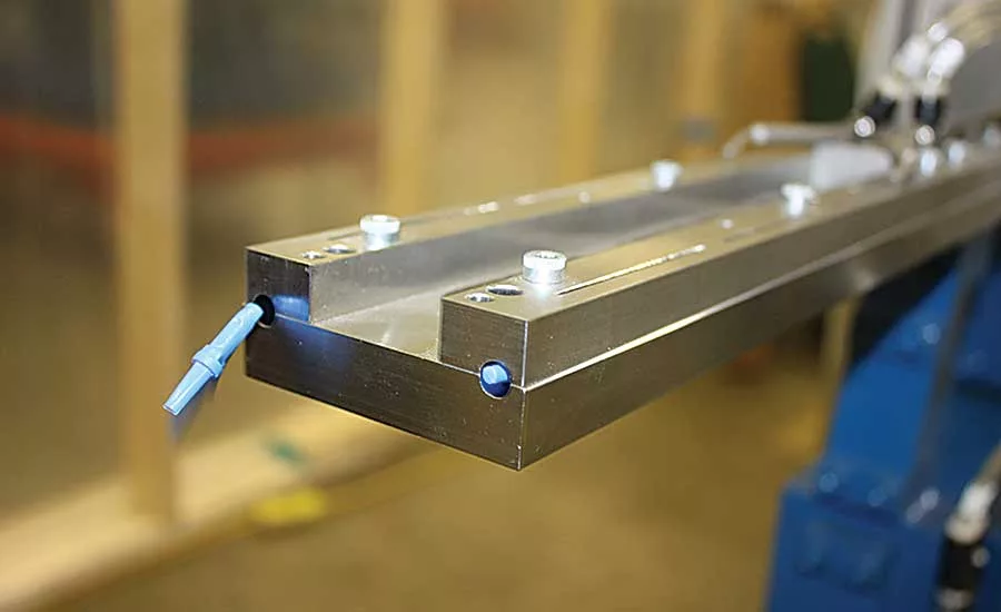

However, with such lightweight parts moving at a high speed, engineers were concerned that they would be blown and misaligned in the track. Fortville engineered a dual-line air track to contain the parts and move them to the next operation. The air pressure across the entire system is controlled by a series of pneumatic air regulators. Fortville had built numerous feeding systems that used the same technology for lightweight parts.
