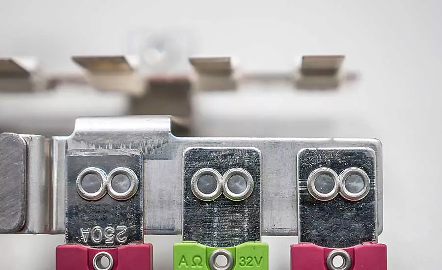

The Tox Twinpoint produces a joint that is secure against rotation PHOTO COURTESY TOX PRESSOTECHNIK

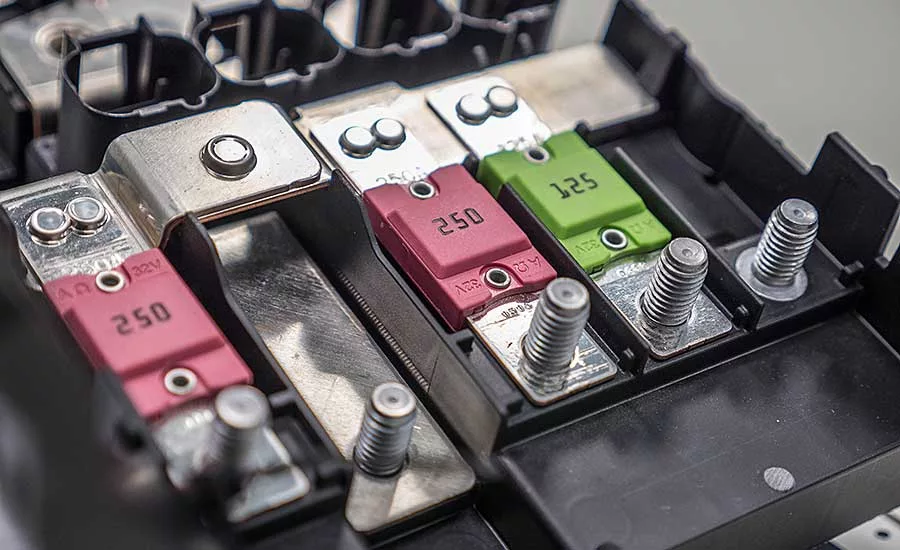

This automotive fuse box assembly features several TWINpoint joints and a Round Point joint. Photo courtesy Tox Pressotechnik

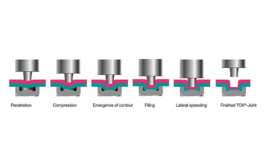

This is how a clinch point is created. The clinch point holds, as a punch pushes the sheet metals into a die. With plastic forming, an undercut is created, which ensures high retention forces of the joined layer in the neck area. PHOTO COURTESY TOX PRESSOTECHNIK

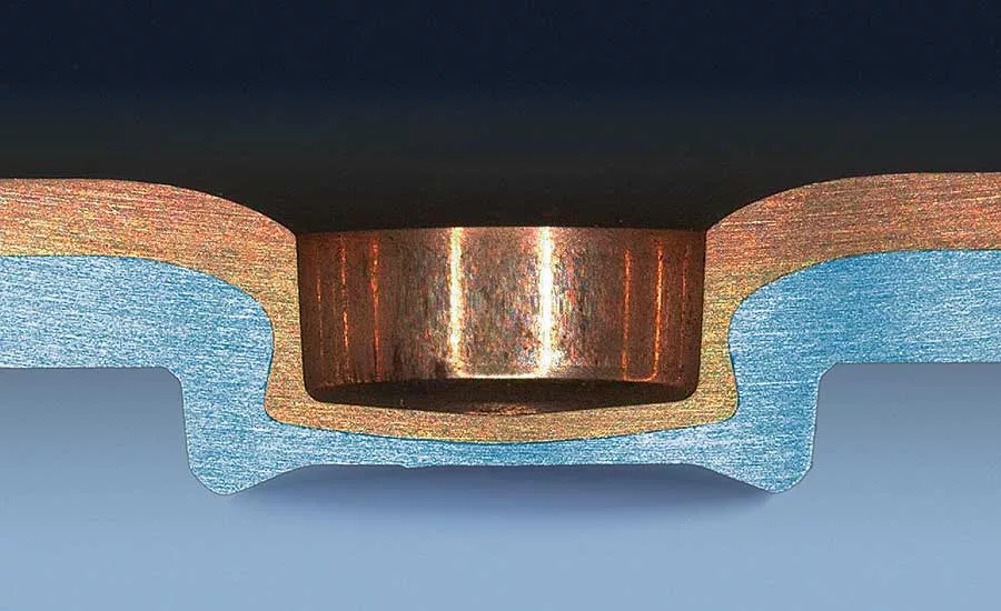

The Tox clinching process can be used to join aluminum and copper—a material combination that is often used in battery modules—without creating an isolating intermetallic phase. PHOTO COURTESY TOX PRESSOTECHNIK

The risk of corrosion is eliminated from the start by the clinching process, as the surface and any coatings in the clinch point are not damaged. However, it’s important that that joint not be subjected to torque loads during use. This is best prevented during the design phase of an electronic assembly. For example, an engineer could place two clinch points close to each other, thereby preventing rotation around a single point.

The quality of the clinch point can be directly controlled by monitoring force and distance during the joining process. A maximum-strength interlock depends on maintaining sufficient strength in the neck and, most of all, ensuring proper compression of the bottom layer.
Insight Into Clinching

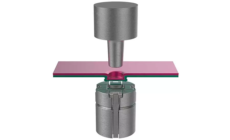

The basis of each clinching system is the clinching tongs, or clinching frames. The equipment includes an electromechanical servo drive or a hydropneumatic cylinder. The tools comprise punches and dies that are adapted precisely to the materials, sheet metal thicknesses and joining forces. For conductive clinch points, the best tools are the Tox round joint, the Tox Micropoint or the Tox Twinpoint. With the TWINpoint, the two clinch points are simultaneously created close to each other, securing the joint against applied torque.

Compared with other joining methods, such as bonding, welding, soldering and screwdriving, clinching clearly has an advantage. It does not require additional materials. It does not cut into the surface of the material, thereby safeguarding any protective coatings. It can join aluminum with copper—a material combination that is often used in battery modules—without creating an isolating intermetallic phase. The cold-forming technology is also suitable for joining sensitive battery cells without heat input.
