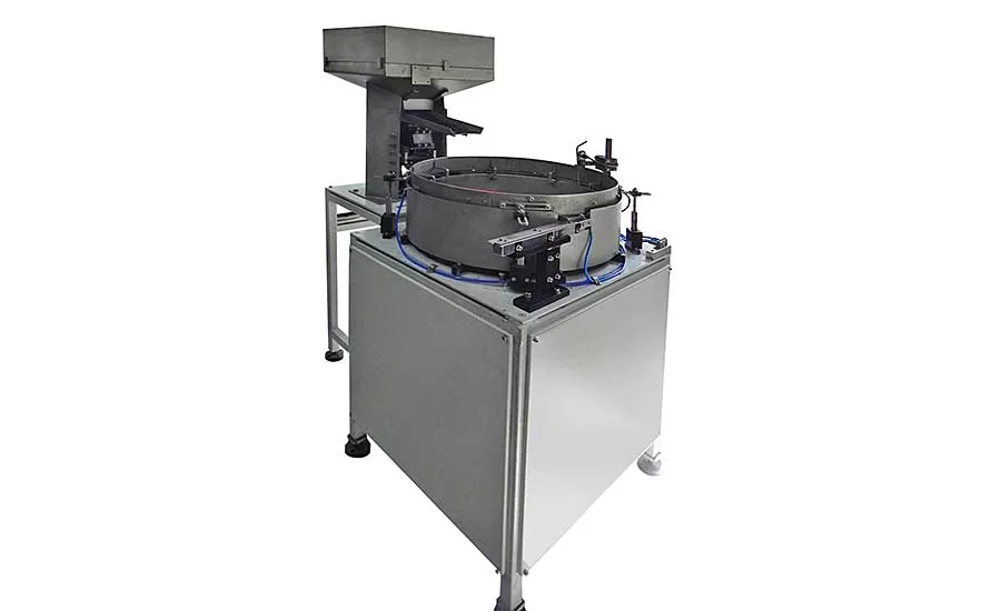

This centrifugal feeder supplies long, flat drippers for an irrigation system at a rate of 2,000 parts per minute. PHOTO COURTESY ELSCINT AUTOMATION

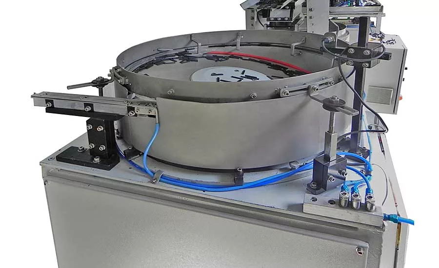

A 50-liter hopper with a level controller ensures that the number of drippers in the feeder always remains within a particular range. PHOTO COURTESY ELSCINT AUTOMATION

Elscint Automation, a manufacturer of parts feeders in Pune, India, recently designed a centrifugal feeder to feed flat drippers, which are used in drip irrigation systems. The drippers are 6 millimeters wide, 3 millimeters thick and 37 millimeters long. One side of the dripper has several legs that are 1 millimeter long; the opposite side has no legs. The drippers must be fed legs down.
In Elscint’s feeder, the rotating disk is 800 millimeters wide. Driven by an AC gear motor, the disk rotates at 120 rpm. Drippers are dropped onto the disc and, due to centrifugal force, are directed toward an opening on one side of the drum. There, custom tooling captures correctly oriented parts. At the end of the feeder, a small belt conveyor, 300 millimeters long, transports singulated drippers to an assembly machine at 80 meters per minute.
One disadvantage of a centrifugal feeder is that the number of parts it can handle at any one time must be limited to prevent jamming. As a result, a hopper or elevator feeder is often paired with a centrifugal feeder to supply it with a steady stream of parts. For the dripper application, Elscint provided a 50-liter hopper with a level controller. The controller ensures that the number of drippers in the feeder always remains within a particular range.
To reduce noise and ensure safety, the entire feeding system is enclosed. A door made from transparent polycarbonate allows technicians to access the drum and disk.
The feeder supplies 2,000 drippers per minute. All the motors have variable-speed drives, so the feed rate can be adjusted if necessary.
