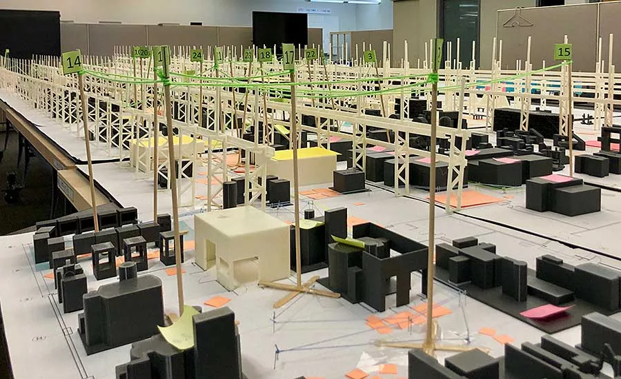

GE engineers built a 1:60-scale model of the turbine plant complete with miniature machines 3D-printed from black plastic. Next, they took yarn to trace a part’s journey through the plant, pegging it on nails along the way. “It just looked like a large bowl of spaghetti,” says GE executive Jon Boucher. PHOTO COURTESY GENERAL ELECTRIC

With their notepads full of observations, Boucher and the Greenville leadership team moved into a nearby administrative building and took over a large, empty section of the floor. They brought in several dozen folding tables and pushed them together to build a platform for a 1:60-scale model of the huge plant complete with miniature machines 3D-printed from black plastic. Next, they took yarn to trace the bucket’s journey through the plant, pegging it on nails along the way.
The yarn unspooled madly across the factory and doubled back on itself multiple times. The team calculated that the part traveled more than 3 miles through the plant to complete the machining process, with the journey lasting 85 days. “It just looked like a large bowl of spaghetti,” Boucher recalls. “Everybody had the same look of amazement on their face. The next reaction was, we have to fix that.”
