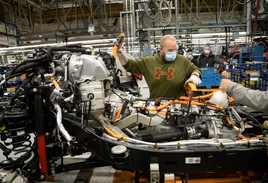

AUBURN HILLS, MI—FCA’s Toledo North assembly plant has started to produce the 2021 Jeep Wrangler 4xe plug-in hybrid. The vehicle boasts up to 25 miles of electric-only range and nearly 400 miles of total range. It features a turbocharged, 4-cylinder gasoline-powered engine; a 400-volt, 17-kilowatt-hour battery pack; and 375-hp, 470 lb.-ft. of torque electrified power train with two electric motors.
The vehicles are built on the existing Wrangler assembly line. Over the next few years, the Jeep brand plans to offer electrification options on each nameplate, with each vehicle carrying the 4xe badge.
