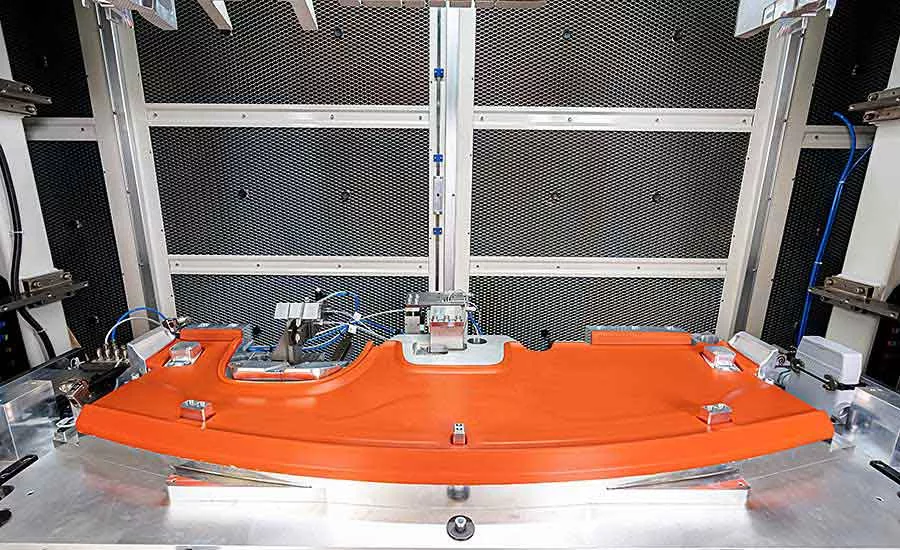

Vibration welding can quickly join large plastic parts with complex shapes. Photo courtesy Telsonic Ultrasonics Inc.

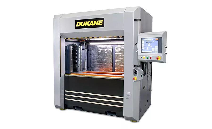

Vibration welding is a well-established assembly process that mass-produces parts used in everything from automobiles to washing machines. Photo courtesy Dukane Corp.

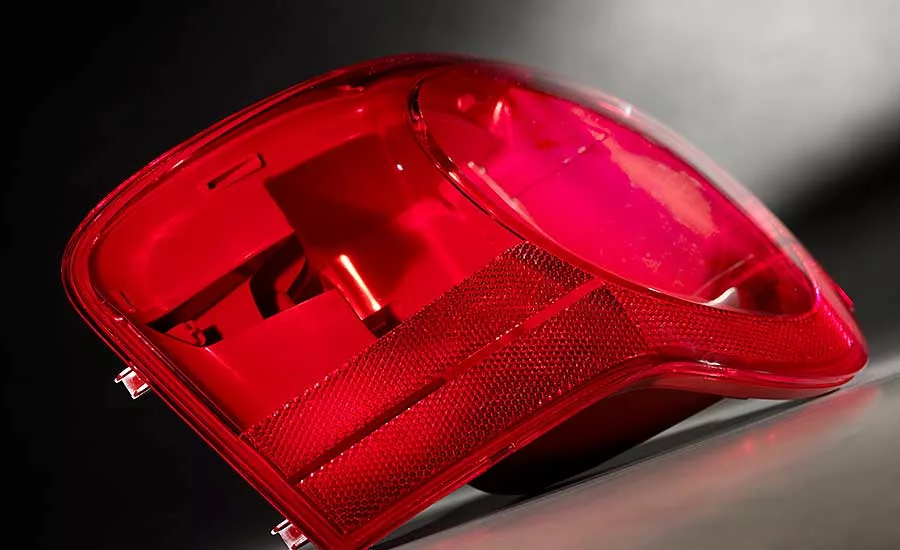

Many automotive taillights are assembled with vibration welding technology. Photo courtesy Emerson Automation Solutions.

Vibration welding, a cousin of ultrasonic welding, is a popular assembly process because it has many advantages. It can join similar and dissimilar thermoplastics. Vibration welding can also assemble parts produced in different ways, such as blow molding, injection molding or 3D printing.
In addition, vibration welding can weld large parts with complex shapes. It is a relatively fast process for joining large plastic parts. And, because it applies pressure before heat, some amount of part warp can be accommodated.

Vibration welding is a well-established assembly process that is applicable to a wide range of part geometries and materials, making it ideal for producing parts that are used in everything from automobiles to washing machines.

“The process is used by OEMs and Tier One suppliers to mass-produce air bag chutes and frames, headlights, taillights, instrument clusters and instrument panels,” says Priyank Kishor, global product manager for non ultrasonics at Emerson Automation Solutions. “Many types of under-the-hood parts are also assembled with vibration welding, including filters, fluid tanks and manifolds.”
