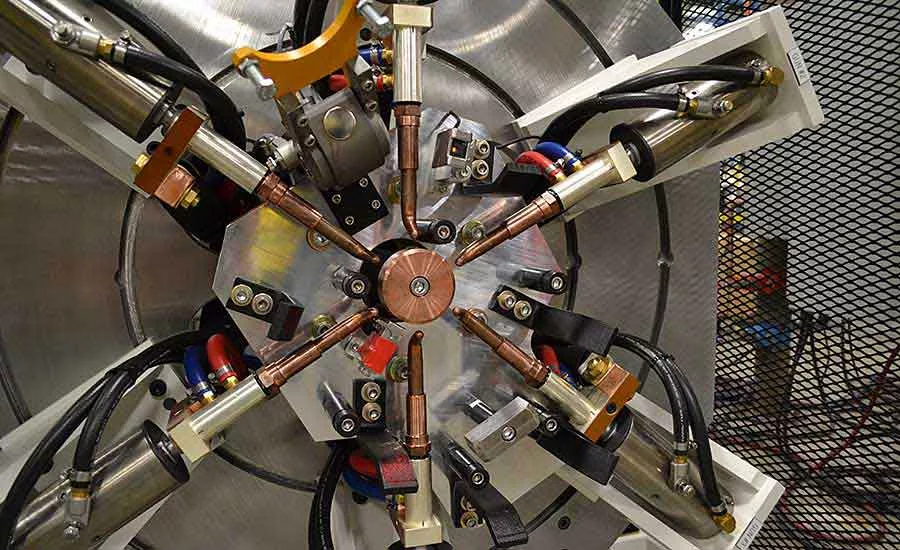

This manufacturer uses a custom 16-gun machine to spot weld hat-section stiffeners used in hollow metal prison doors. Photo courtesy T.J. Snow Co.

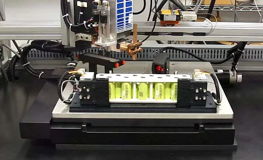

Resistance spot welding is widely used in the automotive, aerospace, white goods and electric-vehicle battery (shown) industries. Photo courtesy Amada Weld Tech Inc.

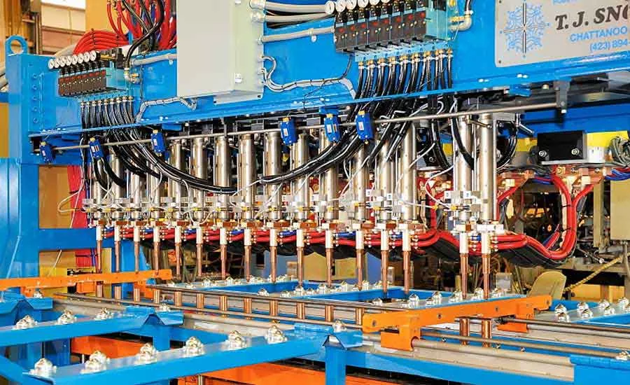

Automotive mufflers are often spot welded. This six-gun radial machine was custom-made to weld mufflers. Photo courtesy T.J. Snow Co.

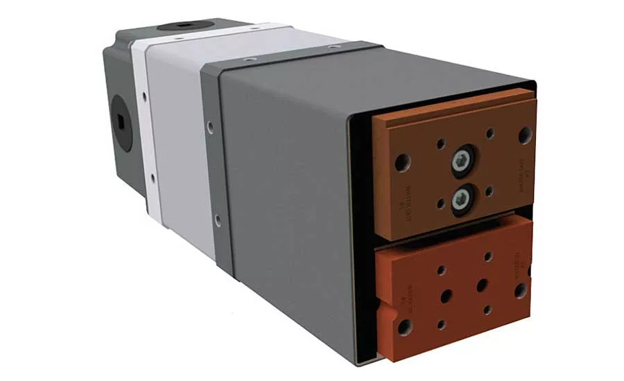

Spot welding systems require a transformer, such as the MFDC (medium frequency direct current) model. Photo courtesy RoMan Manufacturing Inc.

T.J. Snow has been making and repairing standard and custom resistance spot welders since 1963. The company’s pedestal-type SlimLine machines come in horn and platen styles, and use one or multiple weld heads. Standard features include a rigid heavy-duty frame, a fixture-type transformer and an easily adjustable electrode gap.
Last year, T.J. Snow supplied a custom SlimLine machine to a Tier 1 aerospace manufacturer to spot weld exhaust components for jet engines. The parts are made of a high-temperature alloy. A robot picks up each part and places it inside the throat of the machine, where the part is welded within 1 second. After this, the robot places the assembly on a conveyor.

“Years ago, AC-type transformers were very popular,” notes Don DeCorte, vice president of resistance welding products at RoMan Manufacturing Inc. “But now, because electricity is much more expensive, manufacturers have a greater need for more-efficient MFDC (medium frequency direct current) transformers.”
RoMan is the largest manufacturer of standard and custom transformers for resistance welders in the world, according to DeCorte. He estimates that 85 percent of all such welders in the United States work with a RoMan transformer. The transformer weighs from as little as 12 kilograms, to as much as 5 tons, depending on the welding machine.
