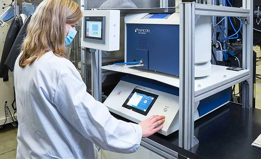

A technician uses a helium-based leak test instrument to inspect automotive components off-line.

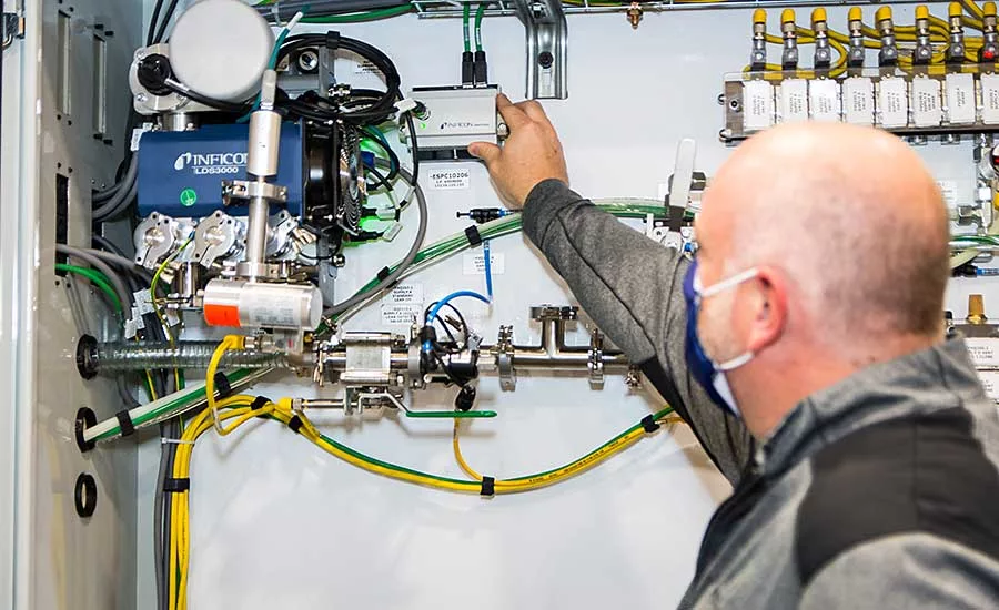

The evaluation of a robotic leak-detection system includes the test stand and subsystems, such as the programmable logic controller, the tracer-gas vacuum-handling unit and test instrumentation. All of these can be retrofitted to varying degrees.

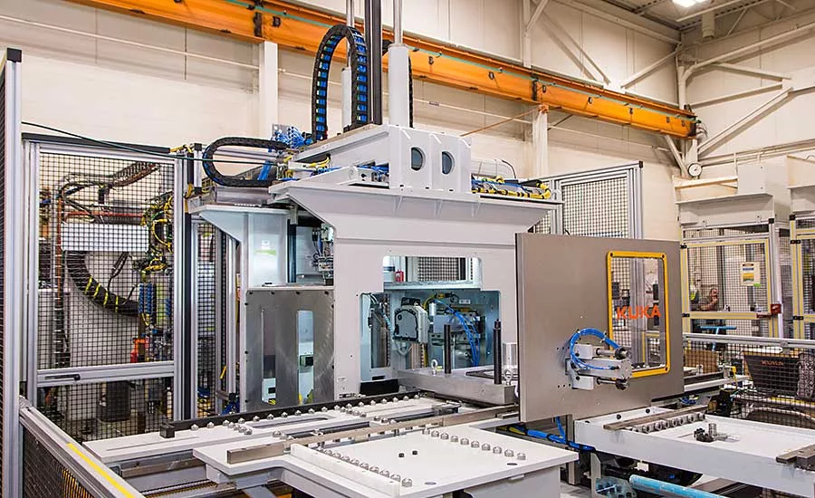

Inficon and KUKA teamed up last year to work on the installation of their first retrofitted EV leak test system. The repurposed unit will be used at a transmission plant in Michigan set to launch a high-volume EV program this summer, switching from a traditional nine-speed automatic gearbox to a one-speed unit.

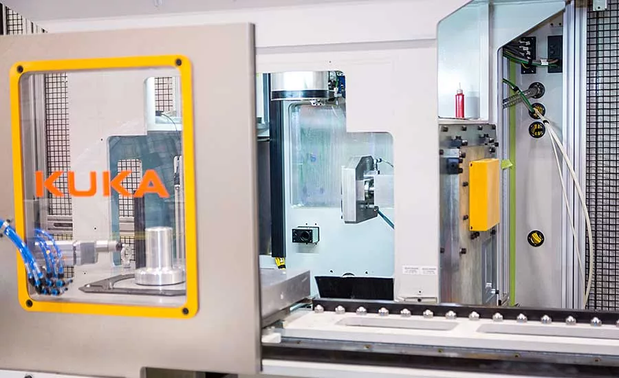

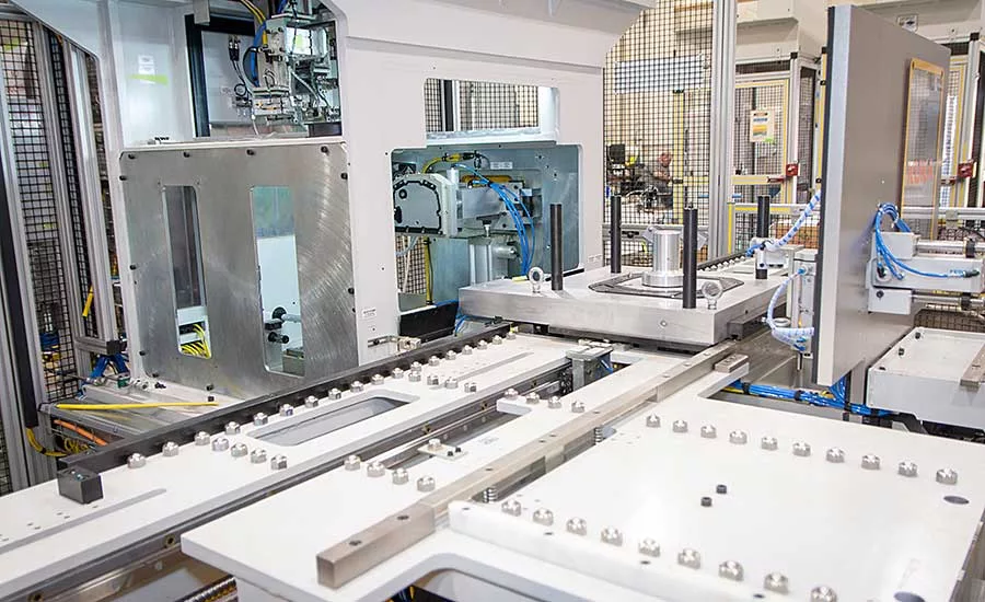

KUKA’s retrofitted transmission test system required modified seal tooling and extensive changes to the vacuum handling chamber, due in part to changes made to the center motor housing.
Only minor changes were needed for the existing control system and Inficon’s LDS 3000 helium leak detector. The time required to complete each test remained the same at about 75 seconds.
Although there are less than half as many cavities to test in the new EV gearbox, the layout is more challenging because the openings for the electric driver and controller are adjacent. “We have to check for external leakage from each cavity on its own, as well as for internal leakage between them,” Darling explains

The testing changes for the new repurposed system were relatively straightforward, but they required a lot of replumbing and a new process sequence. KUKA completed the update for the EV transmission program in about 12 weeks at one of its facilities in Michigan.
Future models could benefit from KUKA’s modular chamber design, which features removable panels that can be retooled.

A cost-saving option is to blend helium with hydrogen. The mixture is not as precise as pure helium, but it’s more economical. Inficon’s LDS 3000 can detect both gases.

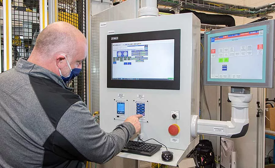

“Leak detection can provide important data to help companies identify potential quality issues and make more informed decisions,” Parker says.
For example, Inficon offers flexible bus modules and device-specific connectivity. That capability can be added during the repurposing process, which allows information to be shared with production equipment and operators to quickly identify potential problems and make changes on the fly.
