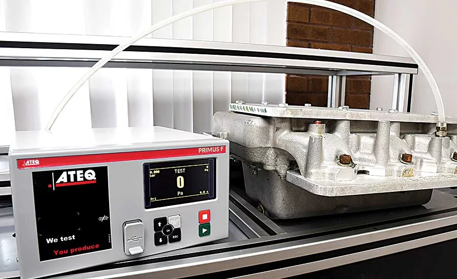

A compact machine, the ATEQ Primus S or F air leak detector is especially effective for pressure-decay testing battery cells. Photo courtesy ATEQ Corp.

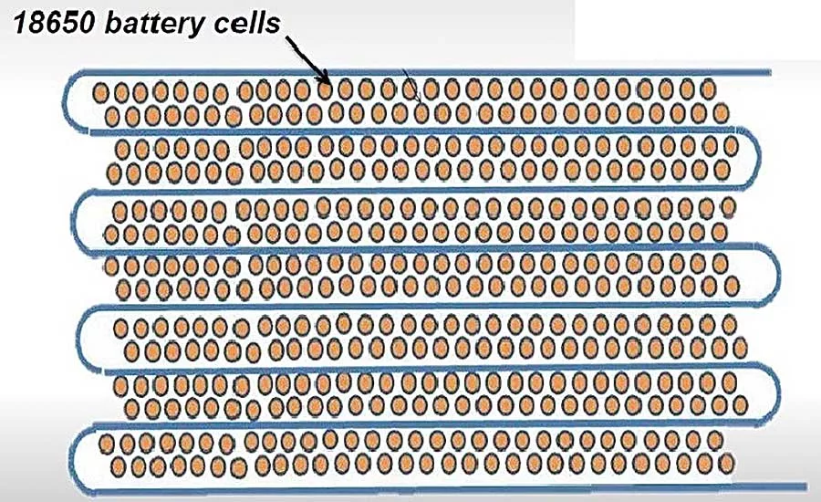

The cooling system in some EV batteries features formed-aluminum tubing (blue line) positioned around cell modules. Glycol-water coolant or a refrigerant flows through the tubing. The 18650 cells are round and a bit larger than an AA battery. Graphic courtesy Inficon

Cells come in three shapes. Round cells (also known as type 18650, 20700 or Tesla’s 21700) resemble a soda can, whereas prismatic cells are rectangular in size and have a stable housing. Pouch cells have no housing and may look like zip-closure bags.

Regardless of cell design, the battery manufacturer may specify that the cell housing be pressure or vacuum decay leak-tested before it is filled. In pressure decay, the part under test is pressurized, then isolated from the supply pressure. A sensor monitors internal pressure, which drops as the air leaks out. The leak rate is then calculated based on the change in pressure over a certain period of time.

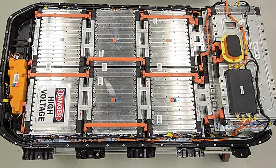

Sealed cells that pass all leak tests are stacked and welded into a battery module, which can contain up to several hundred cells. Welding completes the electrical path for current flow between the cells. The module also features a temperature monitor and a control unit that regulates battery power discharge.
Several modules and a cooling system fill most of the battery pack. Each of these components, as well as the pack housing, are leak-tested separately using an air method (to verify the presence of a leak) followed by a helium one (to exactly pinpoint the leak).
The cooling system consists of formed-aluminum tubing positioned around the modules or small heat exchanger plates (or thermal fins) between them; medium-size heat exchanger plates between stacked modules; a large heat exchanger plate below all modules; and an electronics cooling unit, notes Parker. Tubing is used with round cells, and plates with prismatic cells. The coolant in these components is either a water-glycol mix or a refrigerant such as R1234yf.
Leak-testing ensures that no coolant enters the battery module, thereby protecting its inner cells and outer electronic components (voltage inverter, controller, main fuse, service disconnect, cables, etc.) from shorting out during vehicle operation. It also maintains proper air conditioner performance when a bypass from the vehicle’s AC system is used to cool the batteries.

“Often times, air temperature can prevent the manufacturer from getting the test-result reliability they expect,” notes Anne Marie Dewailly, technical director at ATEQ Corp. “This is because, as air temperature goes, so goes the pressure level introduced into the part. Testing under an air conditioner or fan, for example, will lower air temperature and pressure, whereas a warm area will have the opposite effect.”
The ATEQ Primus S air leak detector is especially effective for pressure-decay testing battery cells, says Dewailly. A compact machine, the detector offers a leak measurement range from 50 to 5,000 pascals of pressure. The unit not only compensates for temperature variations; it learns from the results it gets and adapts itself to those results in a smart way.
