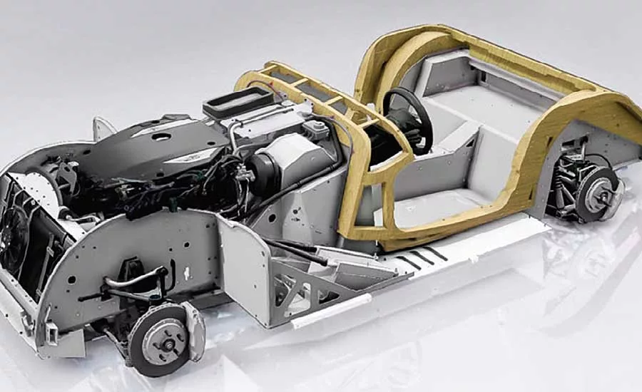

The Morgan Plus Six vehicle features a durable aluminum platform. Photo courtesy Böllhoff Group

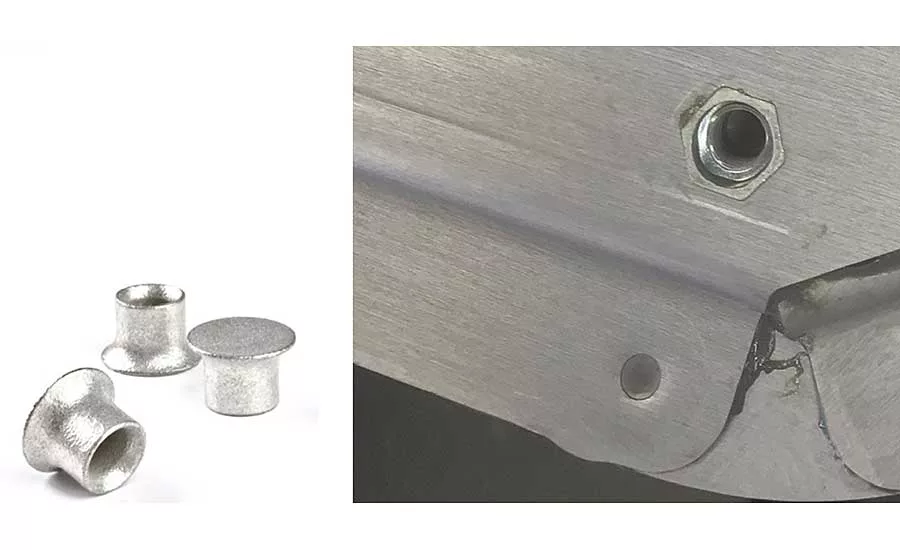

Some 440 RIVSET self-pierce rivets are installed in the aluminum platform of the Morgan Plus Six. Photo courtesy Böllhoff Group

In 2000, MMC introduced its Aero 8 vehicle, the first to feature an aluminum frame. Nearly 20 years later, the manufacturer developed an aluminum platform for its Plus Six vehicle. This platform offers a 100 percent increase in torsional stiffness when compared to the traditional steel chassis in the company’s Plus 8 vehicle, which preceded the Plus Six.
Assembling the Plus Six platform did initially present a joining challenge. But, MMC solved the problem by using RIVSET self-pierce-riveting technology from the Böllhoff Group.
The RIVSET joining method is a two-step process. First, the individual aluminum parts to be joined are bonded with a special adhesive. As the adhesive hardens, the semitubular RIVSET rivet is punched through the top material layer and adhesive, and into the bottom material layer, where it forms an undercut and a slight button-shaped protrusion. Because the bottom material layer is not punched through, a gas- and liquid-tight spot joint is created.
MMC engineers like that the procedure does not require predrilled holes, and that it can join similar and dissimilar materials of more than two layers. In this case, for example, the adhesive is the intermediate layer. Most importantly, the technology creates long-lasting, high-strength mechanical joints.
Some 440 RIVSET rivets are used to assemble the platform, and hundreds more for the Plus Six body. Böllhoff’s RIVQUICK blind rivets and RIVKLE blind rivet nuts are also used for the body due to its high-strength-design requirements. Overall, a total of 1,610 Böllhoff fasteners are used in each Plus Six car.
