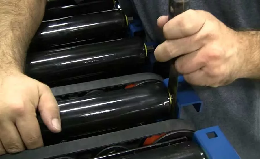

Manual roller conveyors rely on the force of gravity to move objects. Powered rollers, in contrast, generally have the highest payload capacities, and offer robust conveyance with quiet operation.
Both types of rollers require the least maintenance of all the mediums, according to Paul Zielbauer, service supervisor at Bosch Rexroth. The most important thing is to keep the rollers clean and free of contaminants like glue and chemicals.
Marc Halliburton, engineering manager at Motion Index Drives Inc., says accumulated debris near rollers can increase their friction and cause them to jam. This is especially relevant when the conveyor is located near a welding area. Airborne welding slag, which has sand-size particles, can settle in the rollers and slowly degrade them.
“Each roller features a clutch that transfers torque in one direction and moves freely in the opposite direction,” notes Zielbauer. “This clutch should be checked periodically and replaced as necessary. Replacement is recommended when the clutch reaches the maximum adjustment point, which occurs when the adjusting spring can’t be stretched any further.”
Peters says that regular visual inspection of rollers is a good practice, with production level determining frequency. Weekly checks are recommended for high production, and monthly or quarterly checks for low production.
“Should the maintenance person spot marks on the rollers, he need not assume there’s something wrong with the rollers,” explains Peters. “Often times it means there’s a process problem of some sort. For example, maybe that area is where a transfer pallet is rotated before moving onward.”

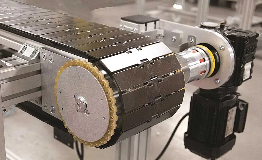

Chains require the most maintenance among the three media. Flat-top chains, which may be made of plastic, steel or stainless steel, are designed to support heavier payloads and recommended for curved sections on a conveyor. Operators often place overlapping caps on these chains to prevent fasteners from falling into them.
Roller chains come in steel, plastic and accelerating designs, and are durable enough for use in challenging environments. Most of these chains can convey heavy payloads and are also bidirectional, making them suitable for reversing applications.
Zielbauer recommends three key maintenance practices to protect chains. The first is regular lubrication (every 1,000 hours or so) to prevent them from drying out and rusting. Preventing the presence of debris or small fasteners in the chain sprocket is another. Number three is maintaining proper chain tension.
“As pins wear over time, the steel chain links elongate somewhat,” explains Zielbauer. “Just make sure the stretching is less than 3 percent. At that point, it’s best to replace the whole chain and sprocket.”
However, even moderate link elongation can cause the chain to “jump teeth” on the sprocket and lessen stop-start position accuracy. Chain slack can also increase. To remove slack, remove or add rows of chain links as needed.

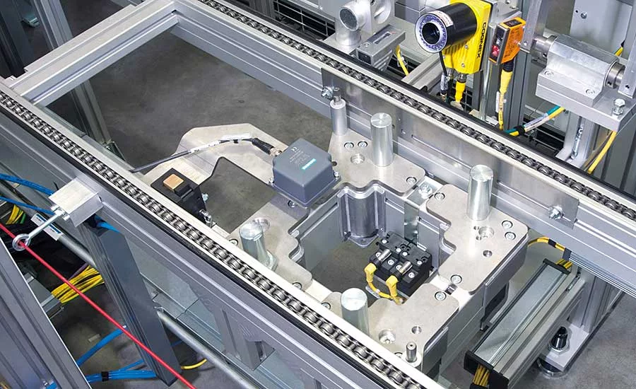

Bosch offers two helpful maintenance products for its TS 2plus pallet-transfer conveyor, which is available with a belt or chain conveying medium. One product is an automatic lubrication module that is side mounted and continuously drips lubricant on chain links during conveyor operation.
Another is a tensioner monitoring system for chains. It features a proximity switch that gets hooked up to a light, which goes on when chain tension falls out of tolerance.
MK offers an optional automated-lubrication module for its VersaMove pallet-transfer conveyor, but not its VersaFlex flat-top-chain unit. The reason, according to Peters, is because the flat top chains are made of durable polyoxymethylene thermoplastic, and do not need lubrication. Another benefit of the VersaFlex is it conveys small pallets (up to 6 inches wide, 22-pound payload) around corners (30 to 180 degrees), and up and down inclines to a positional accuracy of within ±0.25 millimeter.
