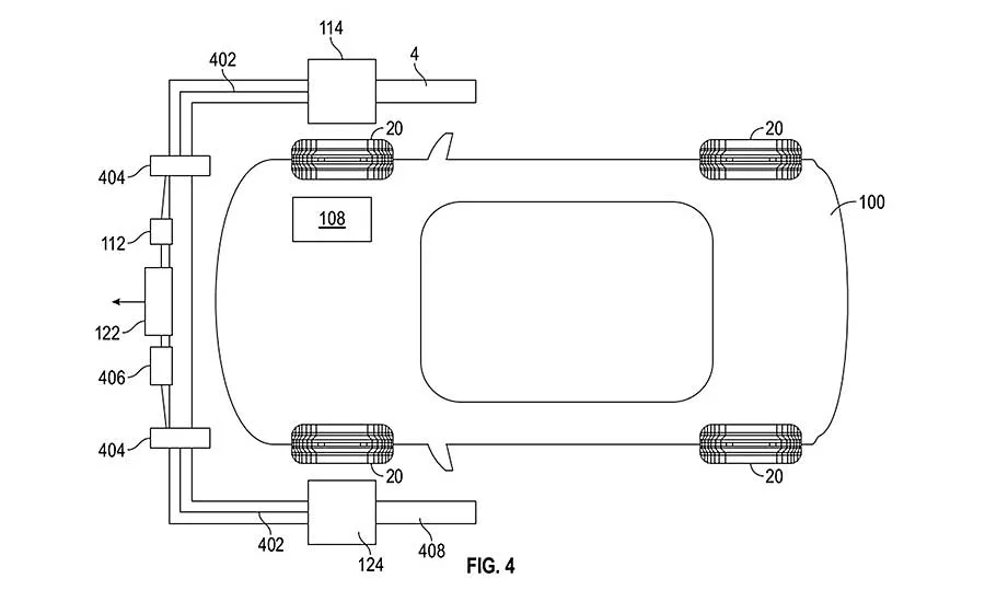

A sensor skid, temporarily attached under an EV, can guide the vehicle through the assembly process based on local sensing and communication with a high-level fleet management system. Photo courtesy General Motors Co.

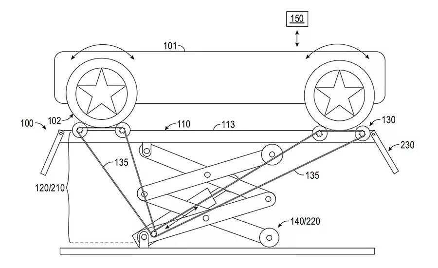

An ergonomic positioning device could be actuated by one or more wheels of the vehicle without a need for external power. It would consist of two rollers, a belt and a passive motion device. When a wheel of the vehicle is interlocked between the two rollers, the wheel can drive the belt, actuating a passive motion device, which moves the vehicle up or down. Photo courtesy General Motors Co.

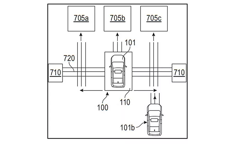

Using an autonomous mobile robot to transport vehicles on the assembly line—or using the vehicle itself—gives OEMs more flexibility in factory layout. Photo courtesy General Motors Co.

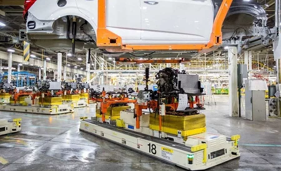

GM already uses automated guided vehicles to transport large subassemblies on the line. Photo courtesy General Motors Co.

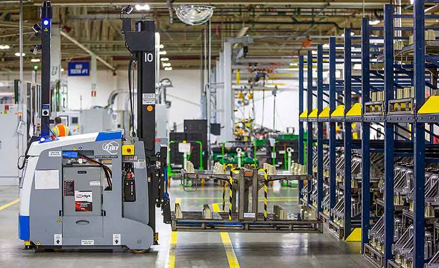

GM uses autonomous forklifts to store and retrieve parts at its factory in Grand Rapids, MI. Photo courtesy General Motors Co.

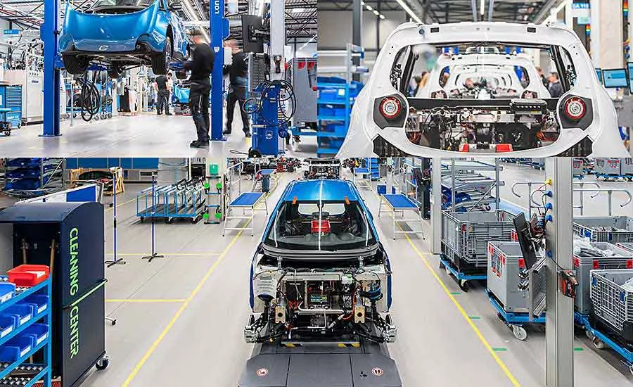

E.GO Mobile’s assembly plant in Aachen, Germany maximizes the advantages of urban infrastructure without violating the environmental standards of the residential area. Photo courtesy e.GO Mobile

Another example is e.GO Mobile’s EV assembly plant in Aachen, Germany. Founded in 2015, e.GO started at RWTH Aachen University in Aachen. This plant maximizes the advantages of urban infrastructure without violating the environmental standards of the residential area. For instance, emission-related adjustments and noise insulation measures have been adopted to mitigate the impact of the factory on local residents. Inbound and outbound logistics are set up in such a way as to divert the traffic from adjacent residential areas.

An urban automotive assembly plant should be designed for maximum flexibility, minimal capital investment and asynchronous production. That points away conveyors and favors autonomous transport technologies. Two options are available: autonomous mobile robots (AMR) and VaaC.
AMRs are vehicles that are equipped with on-board sensors to autonomously move vehicles or materials along predefined paths without the need for magnetic tapes on the floor.
In VaaC, the EV guides itself through the assembly process. A sensor skid, temporarily attached under the EV, guides the EV based on local sensing and communication with a high-level fleet management system. The skid is designed to be easily removed at the end of the assembly. The skid body has a set of pins that temporarily engage with locating holes in the underbody. The skid is equipped with numerous sensors that detect objects around the EV.
As an alternative to the sensor skid, a safety-sensor guidance system can be used. The guidance system is mounted to the chassis and temporarily takes control of the vehicle’s control system. In essence, the EV becomes an autonomous vehicle. The guidance system includes a sensor, a transceiver and an emergency stop device. The sensor detects intrusion into a predetermined zone. The range is dictated by standards for safety-rated sensing and stopping distances. The guidance system also includes a path projector, which projects a visible beam forward from the vehicle. In some cases, the guidance system might have multiple sensors at one or more corners of the chassis. Each sensor can be configured to sense in a three-dimensional volume, so that the volumes overlap to create a buffer zone around the chassis.
Another technology that will enable conveyor-less assembly systems is vehicle-powered positioning devices. In a typical car plant, special equipment is used to lift or tilt vehicles to optimize working positions for assemblers. However, such equipment requires a significant amount of electrical power and is not easily reconfigured. Instead, it would be desirable to use a vehicle-powered device to position the vehicle. Such a device would not require an external power supply, and it would also save space.
The positioning device would be actuated by one or more wheels of the vehicle without a need for external power. It would consist of two rollers, a belt and a passive motion device. Instead of a belt, the device may include other mechanisms, such as a chain, drive shaft or hydraulics. When a wheel of the vehicle is positioned and interlocked between the two rollers, the movement of the wheel drives the belt, actuating the passive motion device, which lifts the vehicle up or down.
