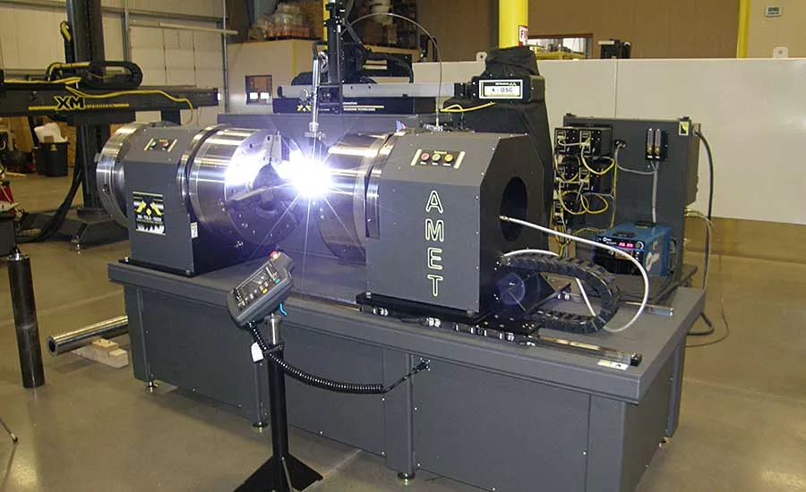

Civan is collaborating with AMET Inc. to develop a turnkey laser welding system for thick metals. Photo courtesy Civan Lasers

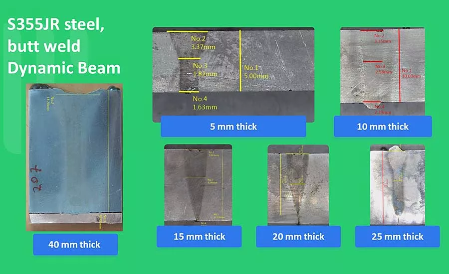

Dynamic beam laser (DBL) technology enables single-pass welding of metal parts 25 to 50 millimeters thick. The technology gives engineers more control over a broader set of welding parameters. Photo courtesy Civan Lasers

The unique capabilities of the DBL enable thick-metal laser welding for the first time, bringing all the advantages of laser to metal parts ranging from 15 to 50 millimeters thick. These advantages include eliminating the need for beveling and reducing HAZ and distortion along with higher welding speeds.
In addition, the DBL platform makes it easy to quickly test different beam shapes and frequencies to define the optimal process for high-quality welds. Engineers can conduct a multitude of tests in a brief period of time and quickly see results. By changing one condition at a time, engineers can identify the ideal shape, frequency and feed rate for the strongest weld, with minimal spatter and porosity, regardless of the application.
Civan is collaborating with AMET Inc. to develop a turnkey laser welding system for thick metals. Based in Rexburg, ID, AMET designs and manufactures automated welding systems. The project has won a grant from the Israel-U.S. Binational Industrial Research and Development Foundation, which aims to support collaboration between Israeli and U.S. companies.
The project began in March 2022, and the companies will deliver the first system in February 2023. The system will be produced in AMET’s Idaho factory. In parallel to building the machine, Civan is developing welding processes at its application lab in Jerusalem. Civan has already demonstrated the ability to weld parts that are 25 millimeters thick, and the company is aiming to have a process for welding 50-millimeter thick parts by the end of 2022.
