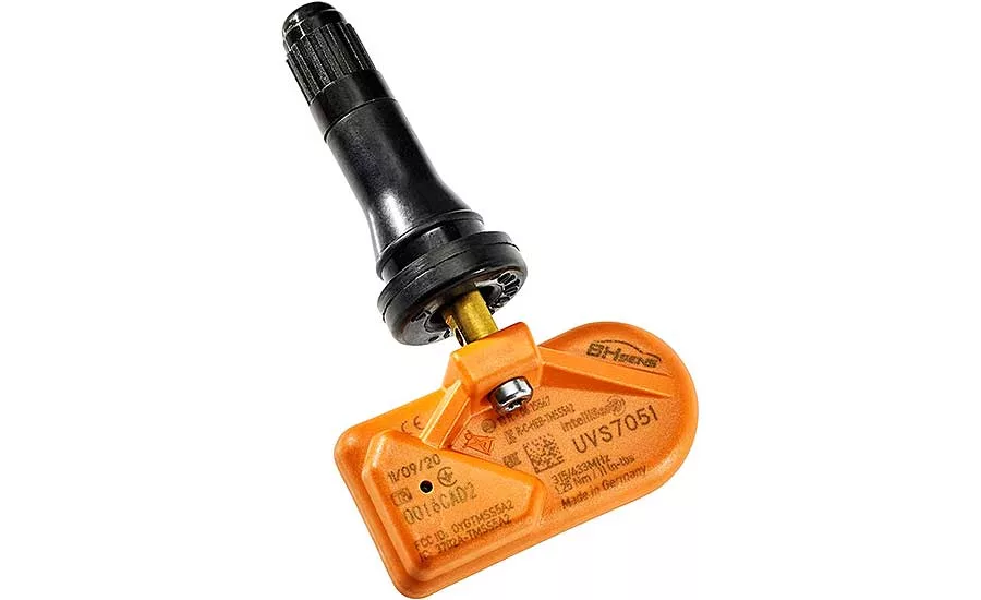

Today, every car tire is equipped with a wireless pressure sensor that warns drivers of dangerously low pressure levels. Photo courtesy BH Sens

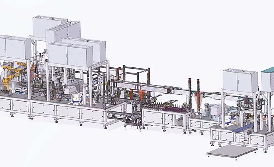

In a compact space, the integrated system combines numerous assembly and testing processes. Photo courtesy Stäubli Robotics

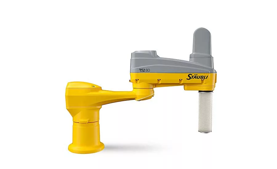

The TS2-80 can carry a maximum payload of 8.4 kilograms and has a maximum reach of 800 millimeters. Photo courtesy Stäubli Robotics

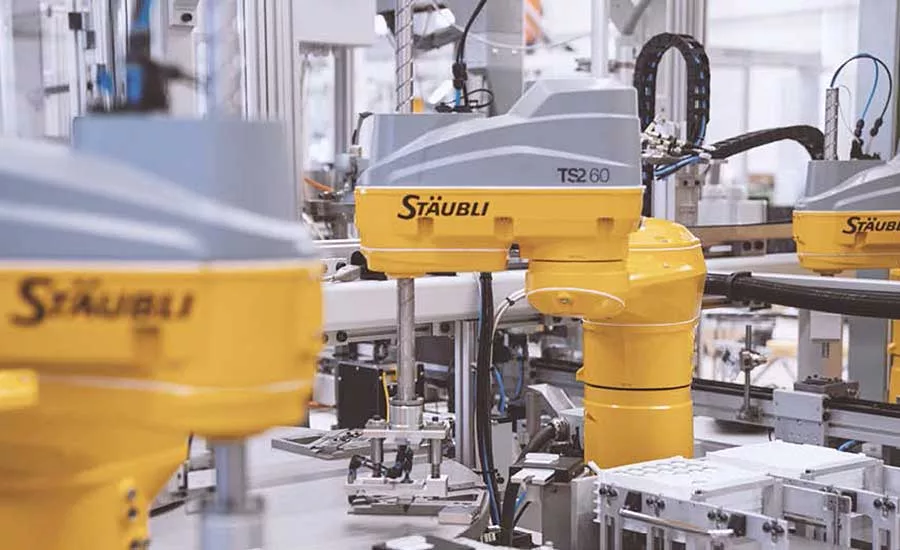

This robotic assembly line produces a tire pressure sensor every six seconds. Photo courtesy Stäubli Robotics

Today, every car tire is equipped with a wireless pressure sensor that warns drivers of dangerously low pressure levels. Given that there are more than 1.5 billion motor vehicles worldwide, that equates to at least 6 billion pressure sensors.

The company’s customer for the automated line was Chinese automotive supplier BH Sens, one of the world’s leading manufacturers of tire pressure sensors. The project would require assembly of 10 components as well as various test and inspection steps. Availability would need to be very high, and cycle times would be short. Four million sensors per year was the target—one sensor produced every six seconds. Flexibility was also required. The system would need to assemble three sensor variants with different base plates.
The heart of the system is a rotary indexing table. The components are handled by three Stäubli SCARA robots. The first robot, a large, four-axis TS2-80, removes a blank from a tray and places it in a pallet. The second SCARA robot, a TS2-60, picks up a battery from another tray and places it on the pallet. During this process, the SCARAs must not only work quickly, but also with precision, supported by a vision system.
The next step is three soldering stations on the rotary table, which connect the battery contacts to a circuit board. The assembly is then is placed in a housing. Next, a third Stäubli SCARA, a compact TS2-40, takes over, guided by a vision system, inserting a plastic seal.
Once the seal has been successfully fitted, the printed circuit board is placed on top and positively connected to the housing by hot caulking. Finally, the cover is placed on the housing assembly and welded airtight by a laser. Mounting of the sensor on a valve and installation of screws with an automatic screwdriving system complete the assembly.
Quality checks include a voltage test, a leak test, and a height check of the circuit board.
MMS engineers chose Stäubli’s TS2 SCARAs because of their ability to work with vision systems guidance, as well as their communication with the feeding systems.
The robots’ uniVAL PLC interface paid off when programming the system. It enables simple connection to the higher-level Siemens S7 controller. MMS meets the demand for flexibility by making it possible to change variants without having to modify the hardware.
